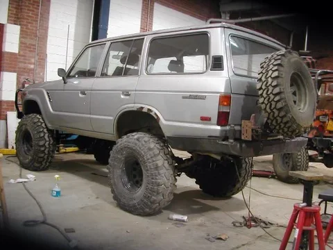

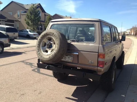

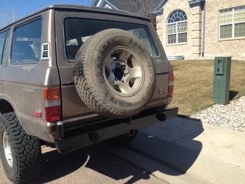

photo 1.webp photo 2.webp photo.webp Started in on my rear bumper. Eventually it will look similar to the one in the third pic.
I like the quarter protection... bit different that most I've seen.
Thanks. I plan on adding some small hoops for additional protection on the rear quarters and finish off the top to cover the view of the frame. I am also going to redo the swing out arm. I think I will go all the way across with a 2x3 tube instead of the tubing.
