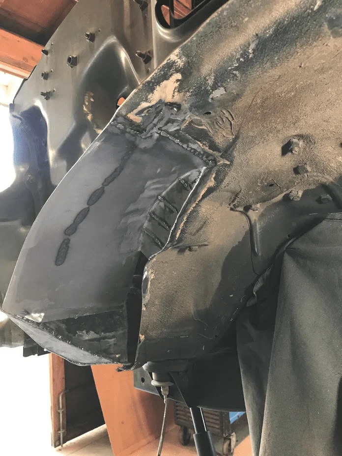

Got the inner wheel well welded in then made the lower lip of the finder so it can bolt up like a factory
Factory Hardware installed, A bit more fitting and then I well marry the finder to the lip

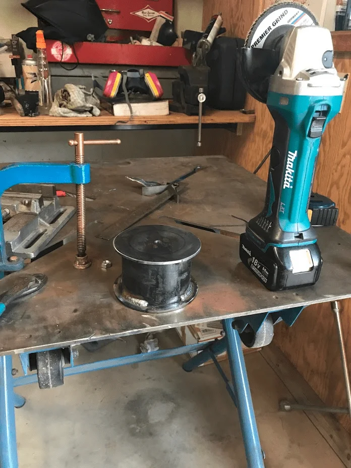

Got some more time in. I wasn't Happy with the way the clips were making a gap between the finder and inner wheel well, so I made a square dimple die to create a recess for the clip to sit in.
I am happy with the results.

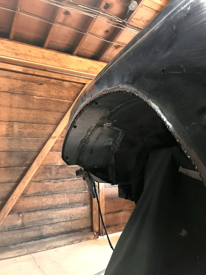

Getting it tack weld in place
All welded and cleaned up, again very happy with the results.
This give you a idea of how much was cut out.
