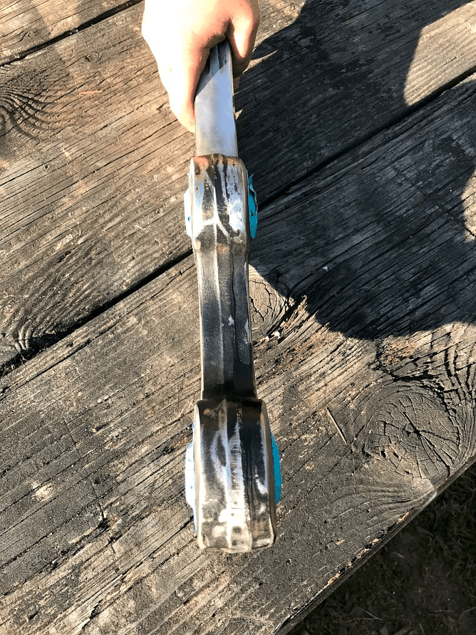

I clearanced the front control arms for maximum articulation and clearance at the tie rod.
Also made brackets to move the axle forward 1" and welded 1/4 skid plate to the bottom of them as the originals were getting beat to death.

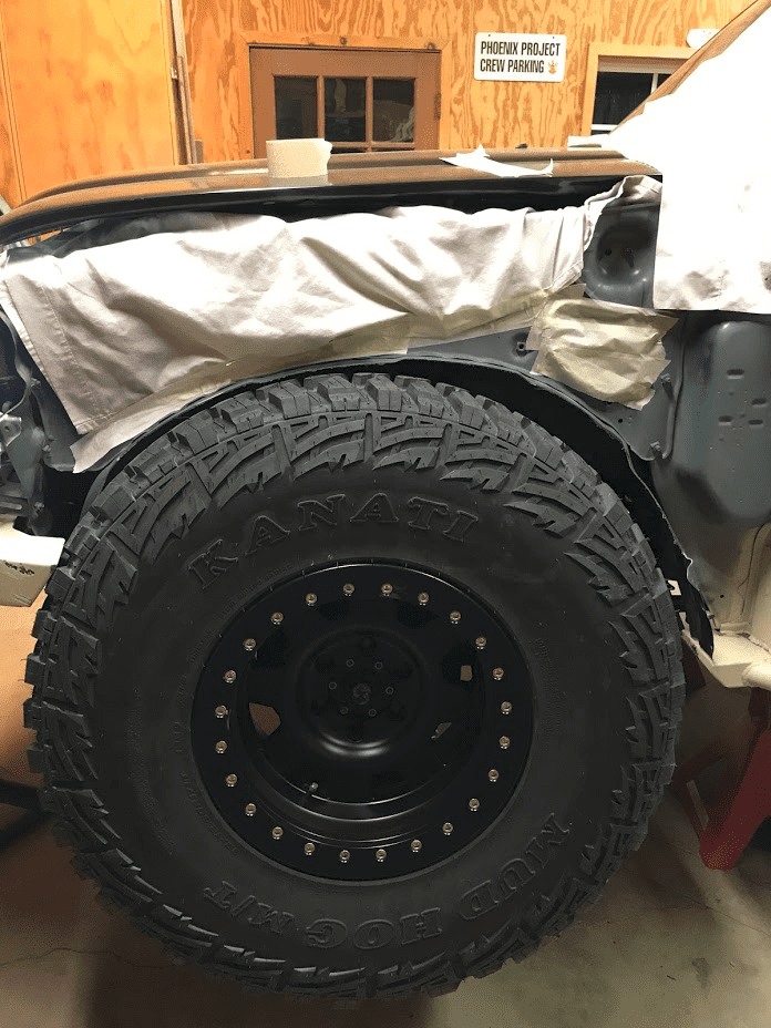

Very happy to say that the rear is done, Just needs some green paint on the body. All the panels are welded in Primed, seam sealed and undercoated. What I was shooting for was a low lift with the 39/12.50/17s. I was running 37 12.50/16s on stock rim no spacers on a 31/2" lift and 2" bump stop extensions. The plan was to keep it the same height with bigger tires and a lower lift and the same bump stops. Height wise I got with in a 1/4" of my goal by cutting as much as I could with out cutting into the doors or the interior, I had the spring out so I could cycle the rear axle, ended up have to go with a 21/2' bump stop extensions got them from Hitti 66 very nicely made. And new springs form Trail Tailor TourFlex 2F coils There 2" lift coils that netted 3"on my reg.
I now have zero tire rub 39s and only a 1/4" taller :clap:

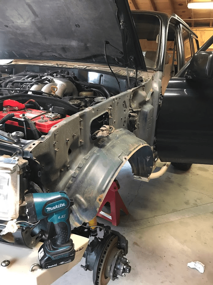

Started work on the front, fenders off springs out.
This is where I'm going to cut right down that line
Cut made.
full stuff straight up, you can see that I well be cutting the bumper, skirting and radiator support before it well turn full lift.
Full articulated driver side up passenger side down.
It's 1" from the stock bump stops and I'm not cutting into the engine bay so it looks like i well be adding bump stop extensions. The plan is it fill it in with sheet metal like the rear. More to follow
