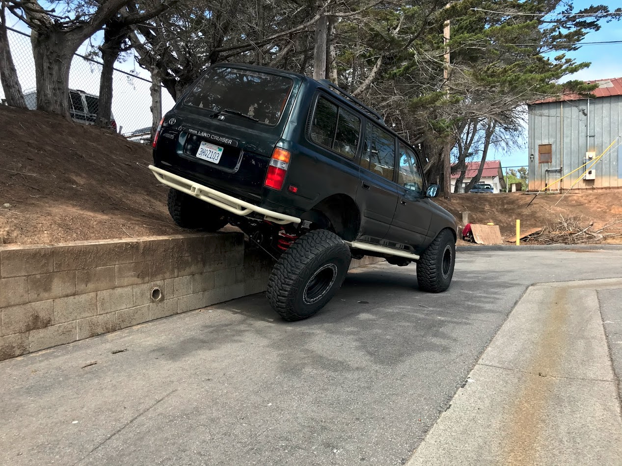

I also did some more testing of the rear sway bar.
I very happy with the way the truck flexes, it feels way more stable when doing these tests with the new sway bar then previous test in this same spot with out the sway bar.

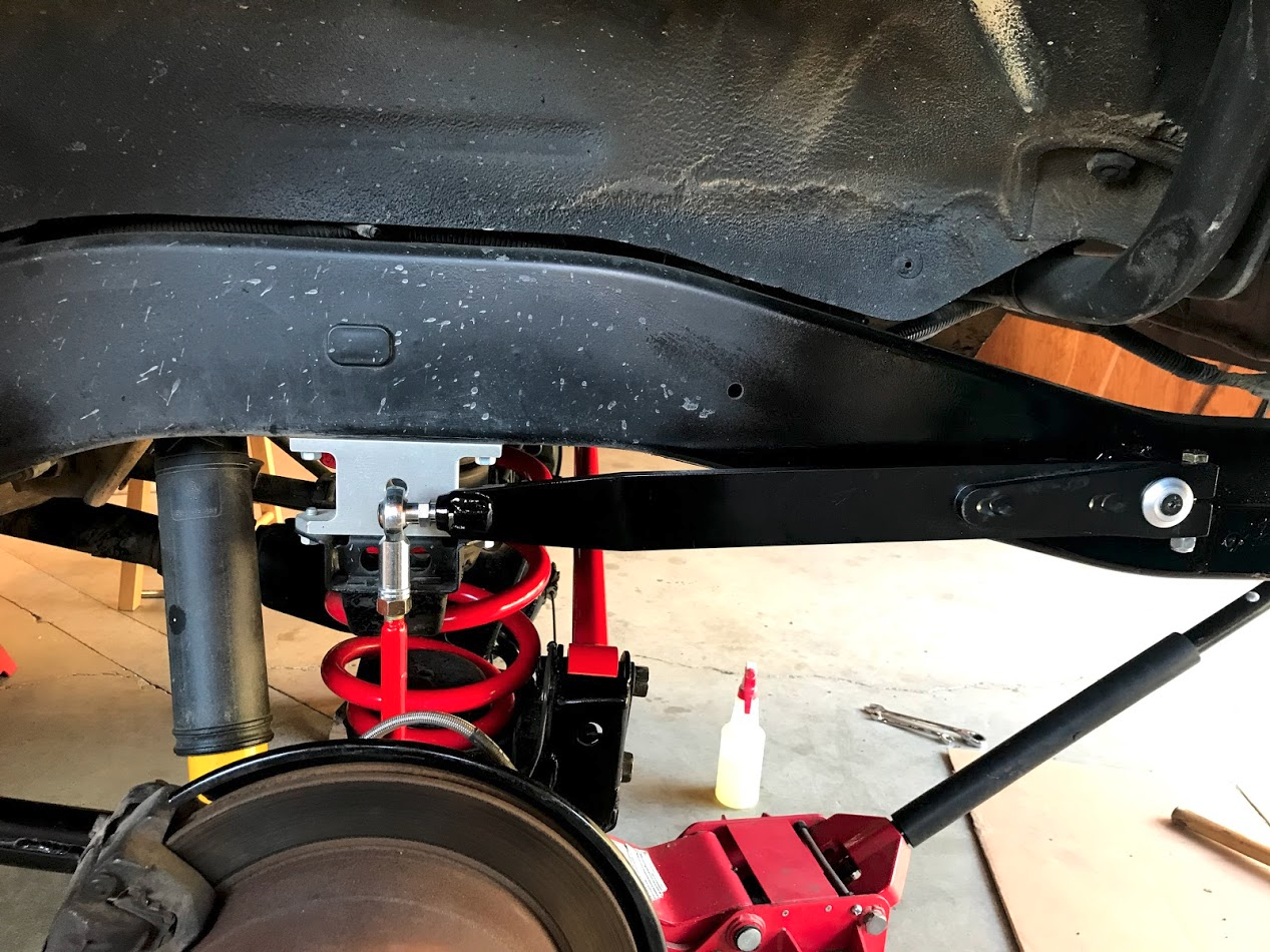

The problem is that it look like the top Heim Joint was maxing out, I was following the lead of another member and turned the Heim 90 degrees for more clearance between the tire and frame ( see the last picture )So i pulled them to check sure enough both top heim joints are damaged. Unfortunately both the arms have been modified, so now I either buy new arms or cut and modify the ends in a way that they will fit and be in the correct orientation.:bang:🤷‍♂️
Press the arms like I did. Or cut off the end and reweld it in its normal config. Should have just left the hardware alone and only pressed the arms like I did.
You dont need to buy a whole new set. You can buy replacement heims from rockjock currie
Should have could have would have, Pressing them won't help, it's cut and weld or new arms from currie 🤷‍♂️

The bar location has nothing to do with it. read to hole post I turn the heims 90 degrees to there operating position. ( wondered about it when I was doing it, should have listened to my sixth sense.
The Sway bar works excellent the way it is, better then I expected, I just need to get the heim joints in the proper orientation.
Cut them off and reweld the correct way. No need for new. Its fixable. You are over thinking a simple bar and nut

The reason I was thinking of new arm is to go with the aluminum ( more weight savings ) and there straight already. but there 3/4" thick and that not going to help.

I was under the impression that you rotated the joints because it was necessary.
I was to, it's very tight in there. I well need to cut the bolt short at the least or tap threads into the arms for proper clearance.
I'm not sure maybe my Reg has fore flex then PVHOBO reg, I was following his lead 🤷‍♂️

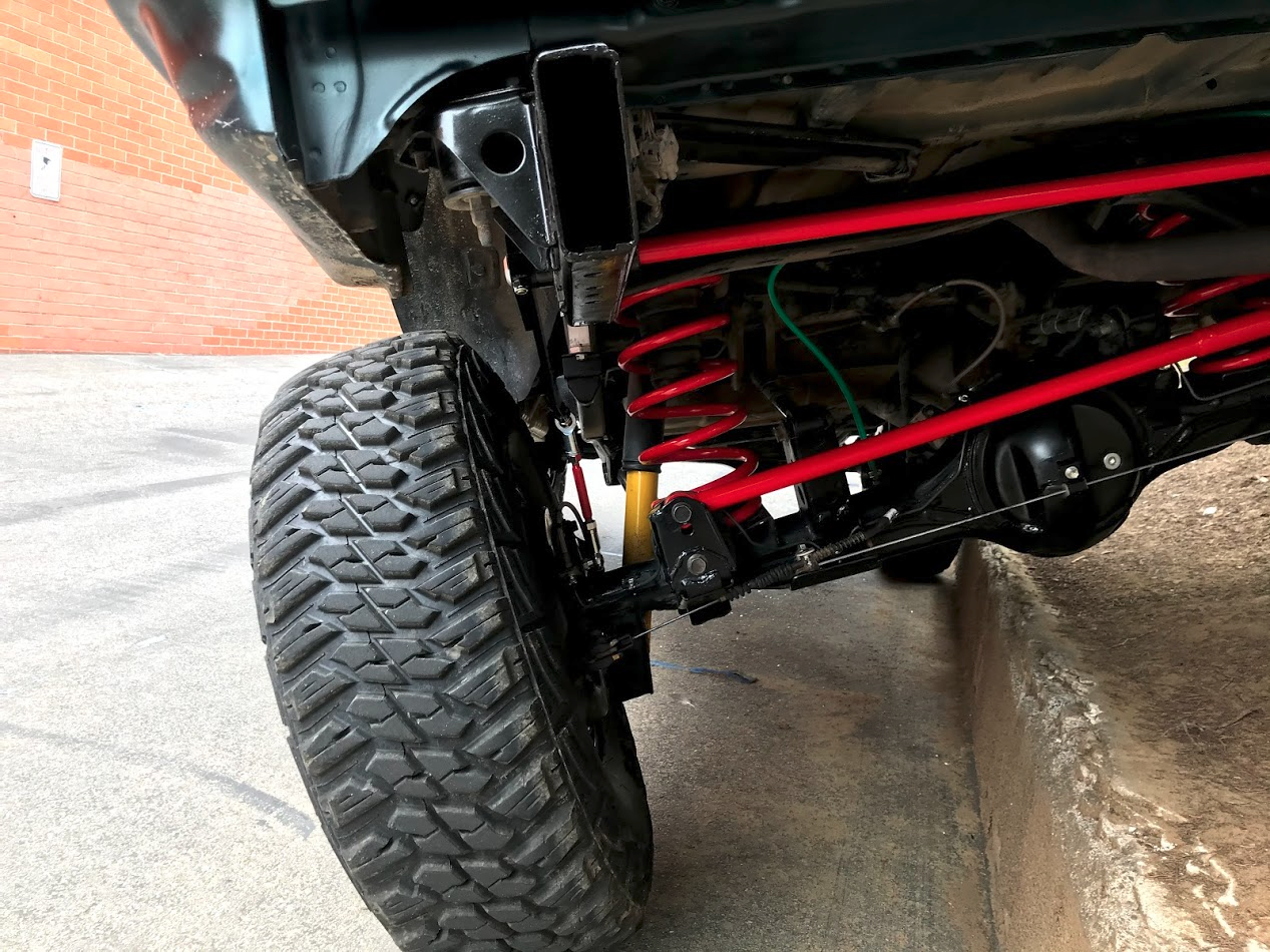

I was able to find these, they have 65 degrees of misalignment compared to the 50 degrees with the one I had.
I got them installed and went over to my urban craw wall for testing, there not over extending. I'm going to try these before I start modifying the arms again.
