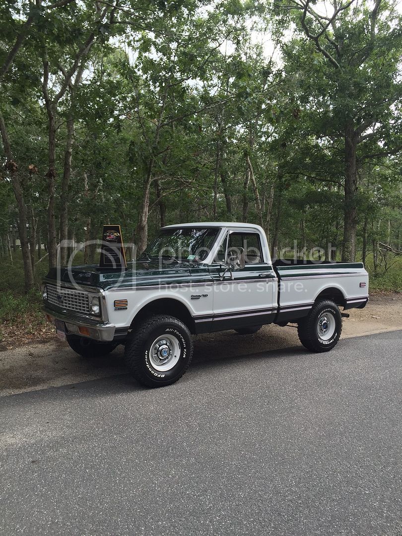

Yep, born & raised here. If you liked it when you were here in the summer, you should come check it out this time of year. A little desolate but man its nice without all those people around! I have a huge soft spot for the 67-72 4wd GM trucks, and thankfully I had the time and devotion to restore one between college and marriage...lol. My newfound FJ60 obsession comes from needing a "family friendly" 4wd truck that I can take on the beach with the wife, baby, and dog. The 4 of us just don't seem to fit comfortably in my standard cab F350... Anyway here's a pic of my '72, I still have it tucked in the garage but it doesnt get out much.
Awe man!
That thing is sweet!
I used too own a few 69' to 72 C10 and C 20. Pick ups!
I always wanted a 4x truck like that.
Very very nice!
