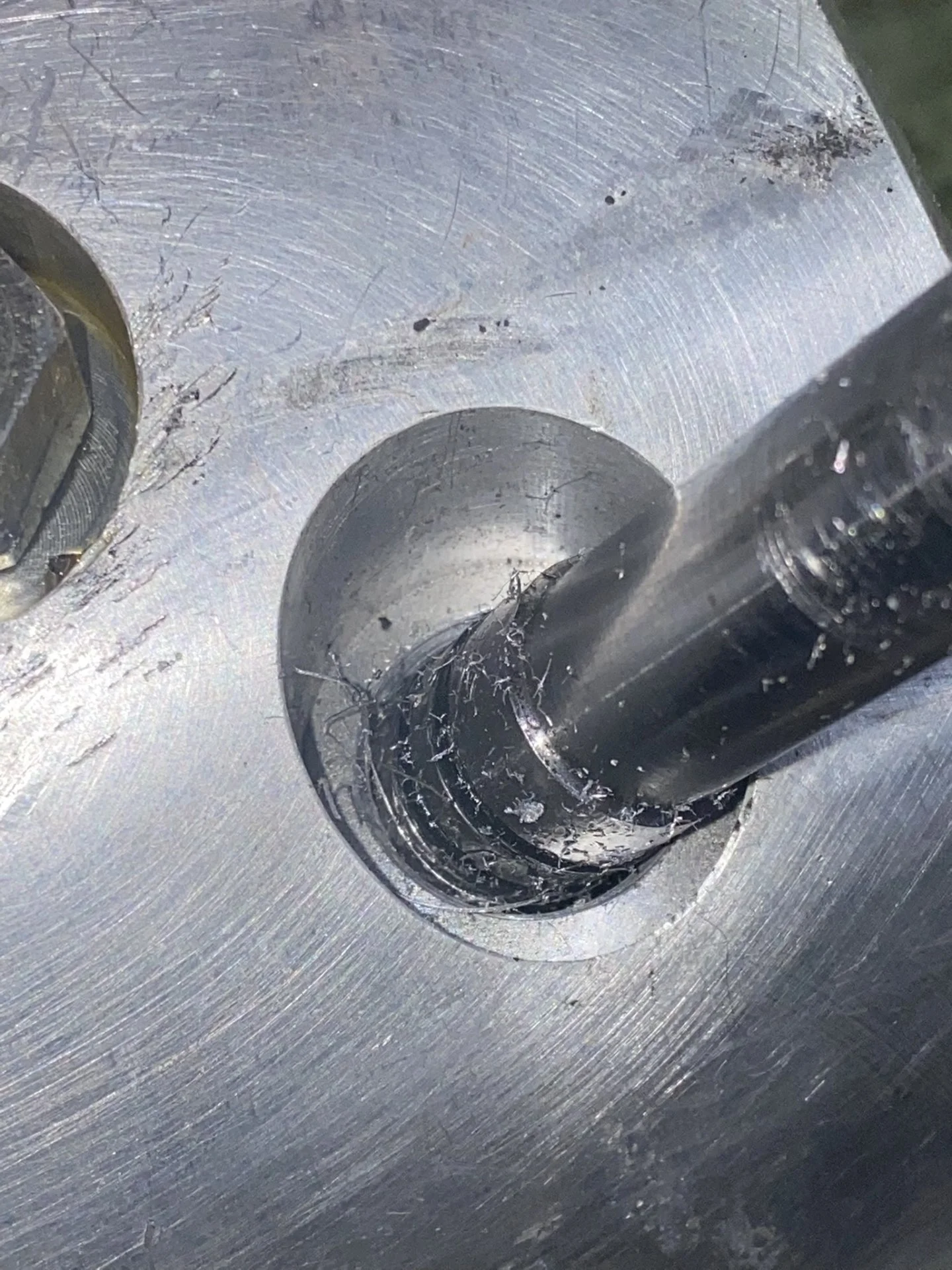

7) So I decided to rebuild the run-out head. While doing so I found the reason, IMO, this Ammco sat unused, since the day it was manufactured. Seems during manufacturing, the assembler was drunk, stoned and blind.
Head had aluminium shavings with in it. Which shavings were likely form machining of coupling head. Which is main oil filled aluminium body of head assembly. Which shavings crossed over one of the main adjusters screws O-rings (2). This would cause a leak/pressure drop in head, at one of 3 run-out piston. So each time run-out set, it could not hold pressure at one piston.
In restoring head. I was able to find and replace ~20 of ~23 O-rings from hardware stores. After which my contact was able to give a parts list form head, which I'll be rebuilding again with manufacture specific O-rings and seals. Which I now know I missed two import fine adjuster steam O-rings. During assembly, I use a little AT-205 with oil.
In cleaning and restore the head assembly. I also found 6 set screws loose, 3 in each of 2 bearing retainer plates. Unsure if they were loose be design, or another assembler mishap. I turning back to my contact made through FB. I was able to get actual design diagrams, instructing to tighten.
