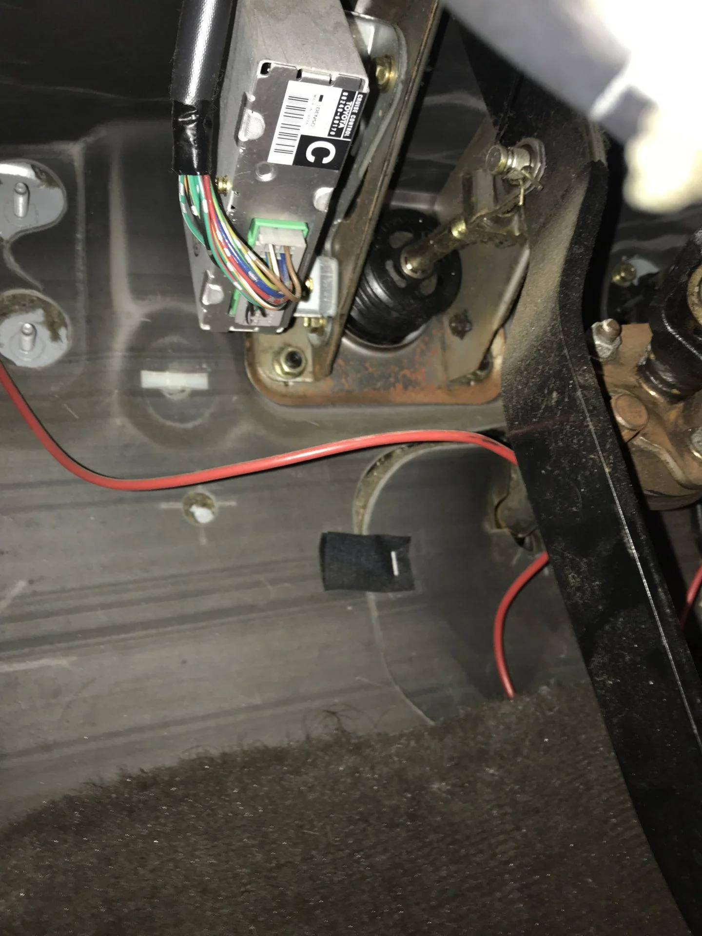

@Stumpalama looks like it's leaking from the diaphragm, I can feel the air coming though from the inside of the firewall by where I took the pic. Hoses and check valve grommet seem fine. Does the above quote mean I'm SOL on that part from you?Gotcha.
