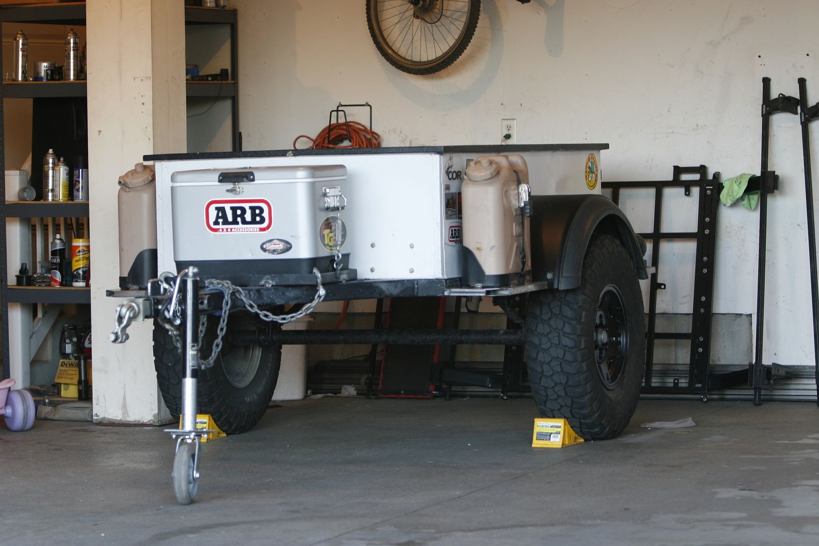

Finally found a decent swivel caster that I can bolt to the skid on my Harbor Freight tongue jack. Finally no more messing with a Jackstand under the tongue. Hoping to get it put together this weekend. I am using a jack with the little weld-on tube thing so the jack itself is removeable when not in use.

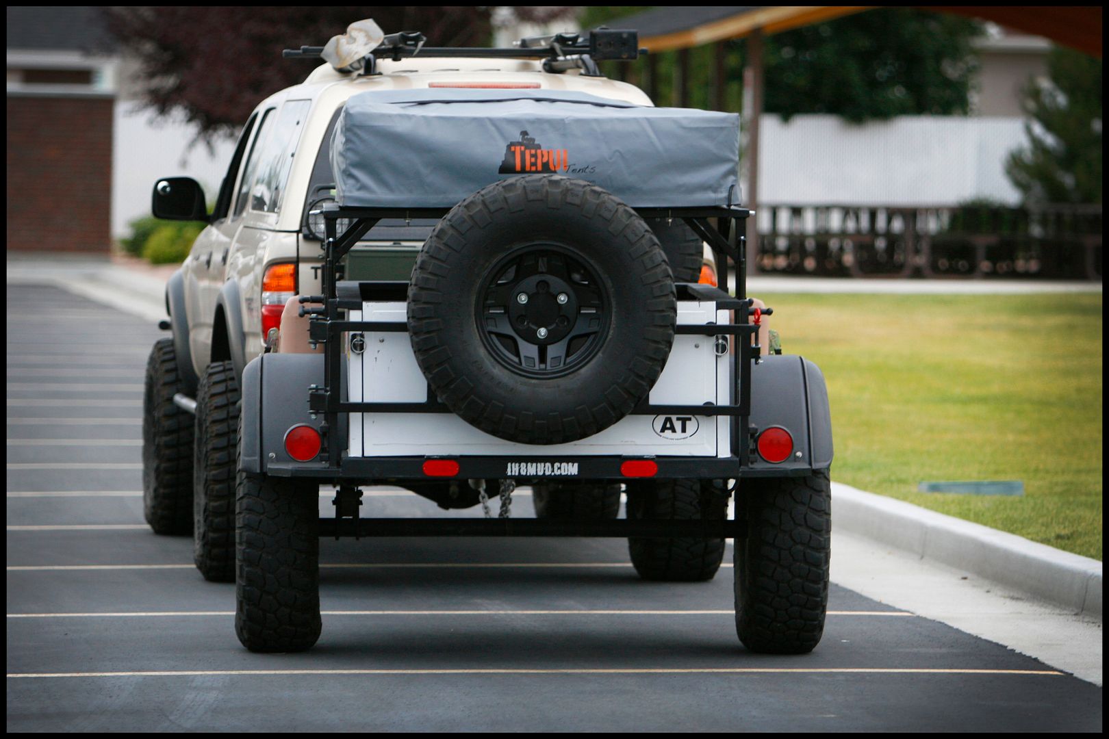

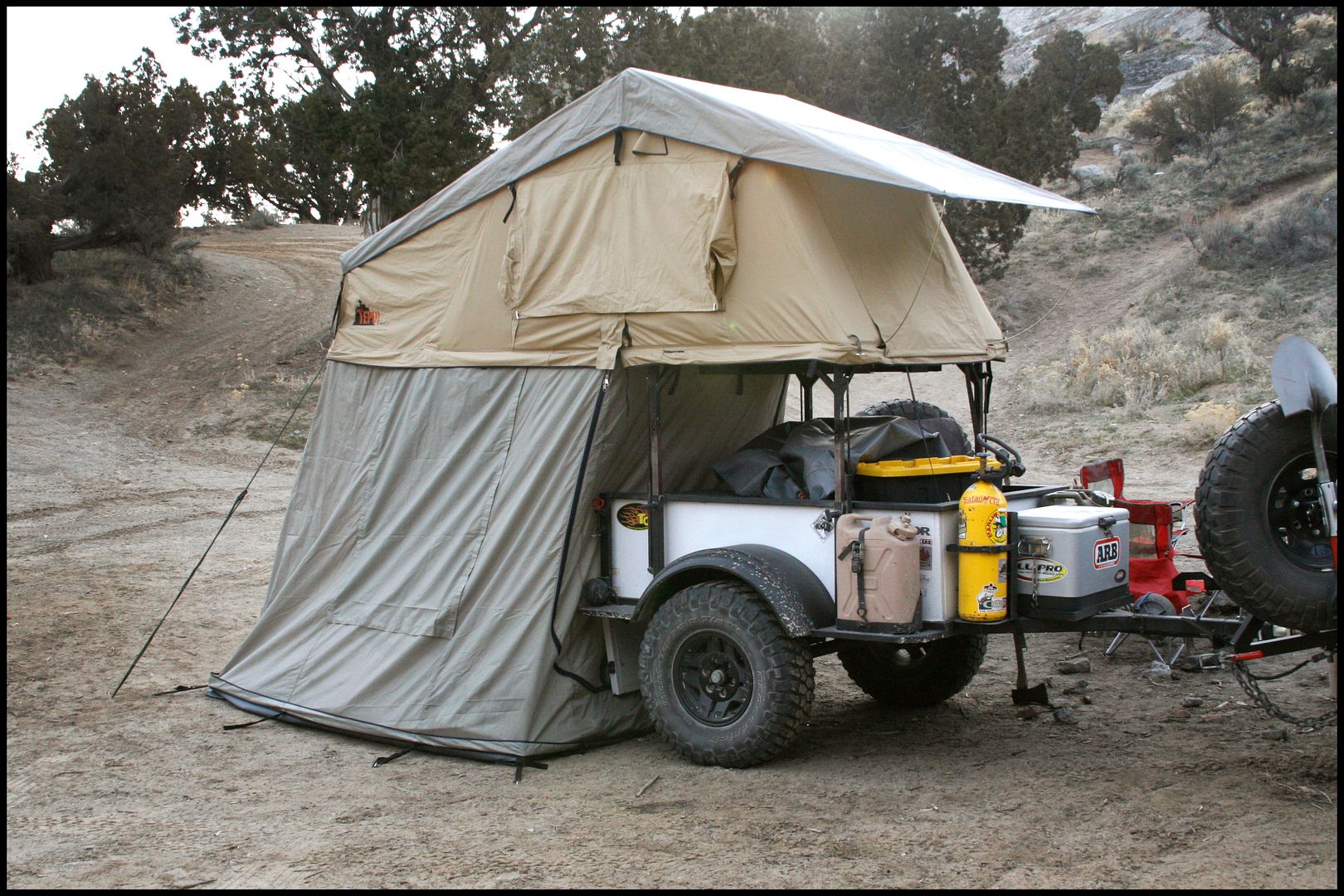

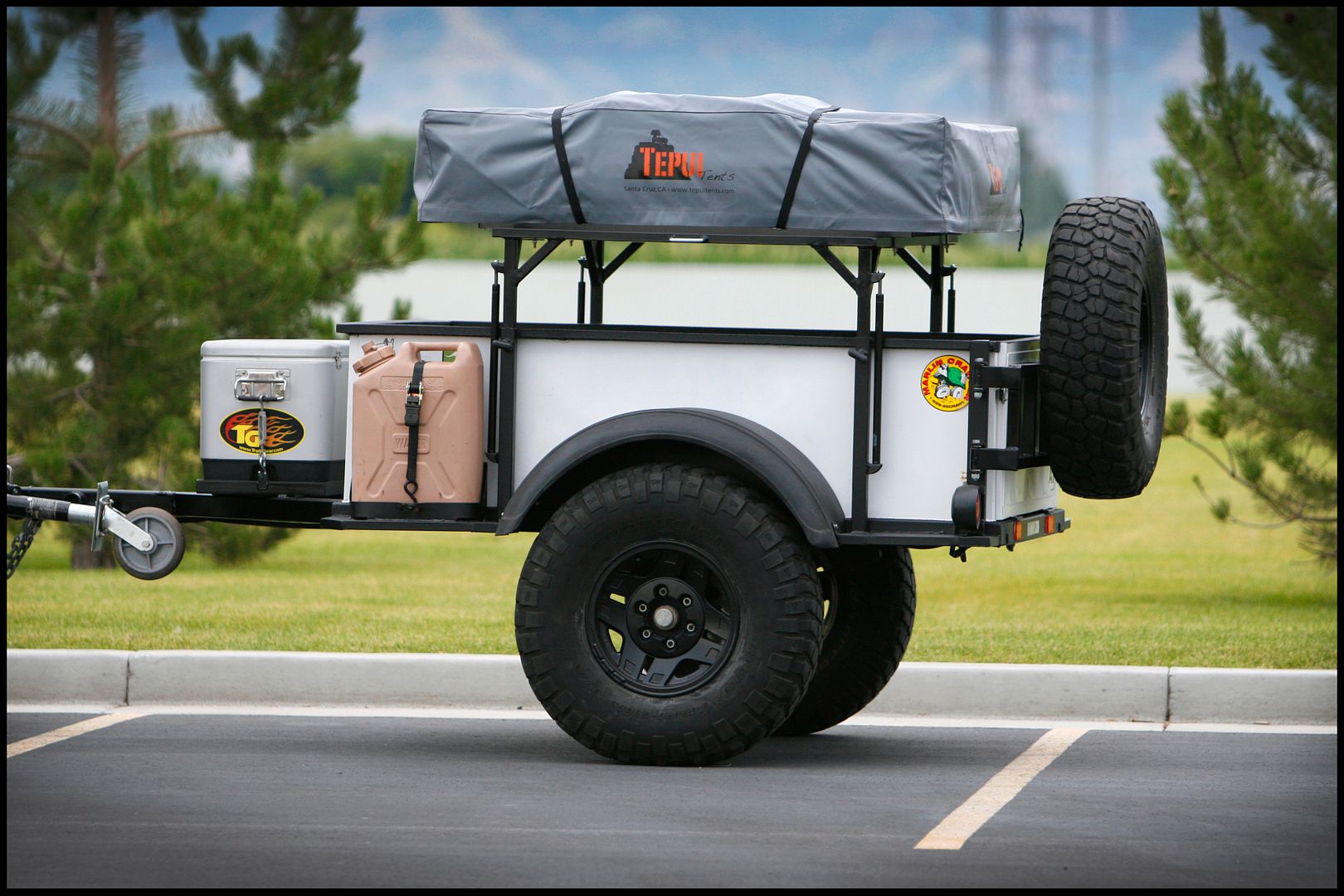

I moved the water cans to the sides of the trailer, added steps in front and behind the fenders. Built a swing out tire carrier, and a new telescoping rack for the RTT. Overall this configuration is working out great.
Here's some pics.

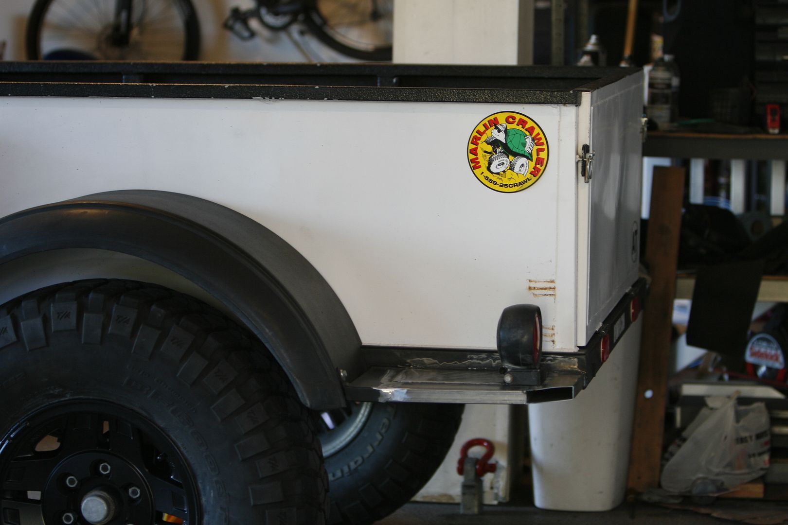

steps added front and rear of fenders with water cans mounted on the front step

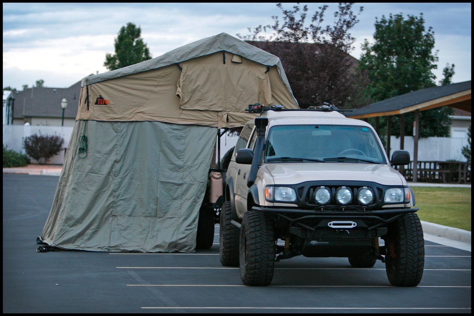

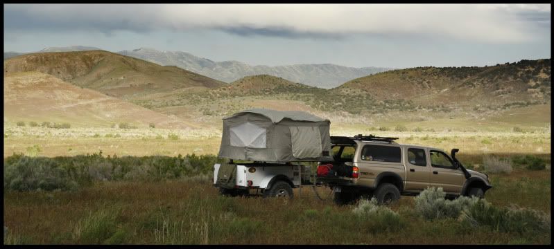

Picked up a new Tepui Autana with annex

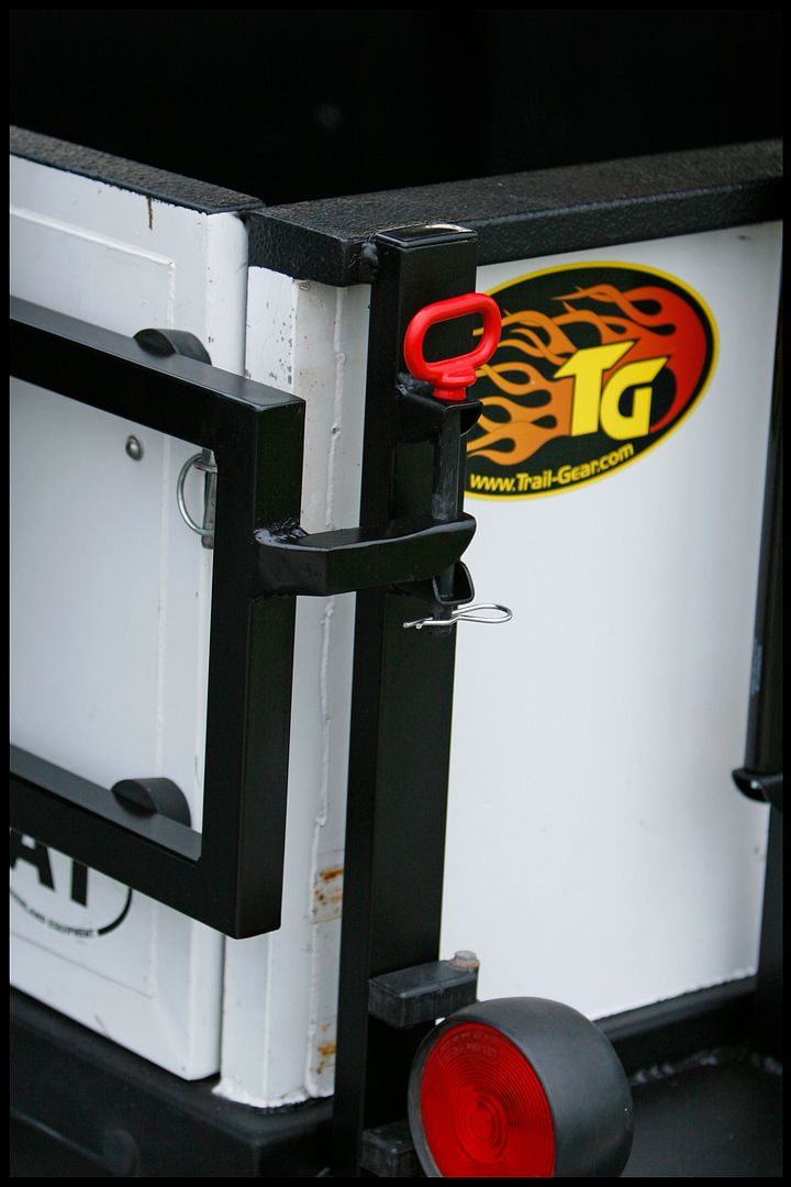

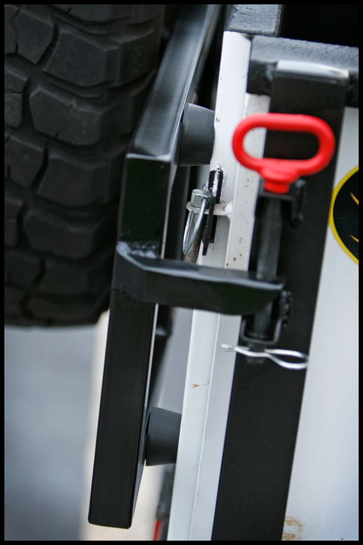

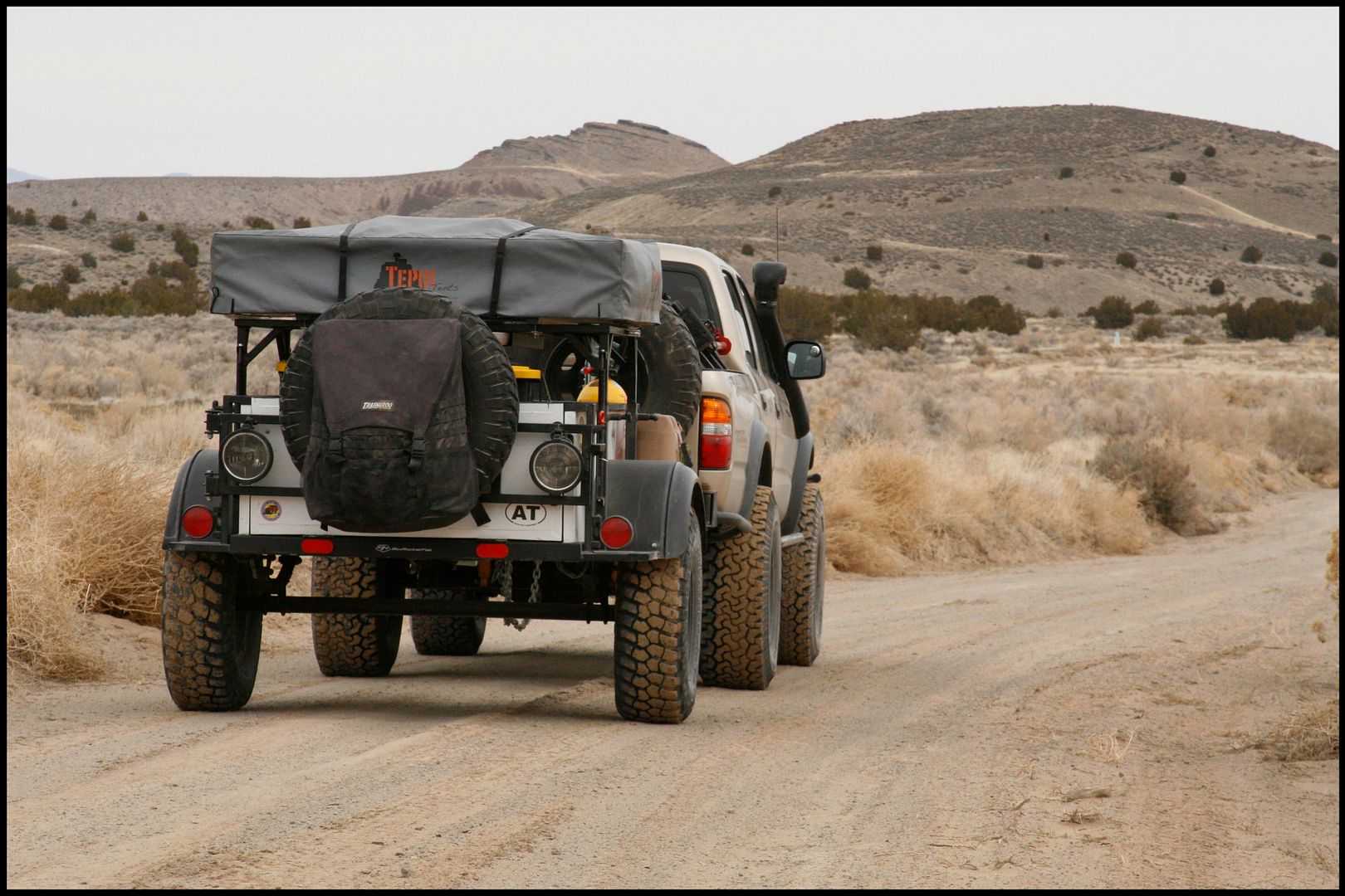

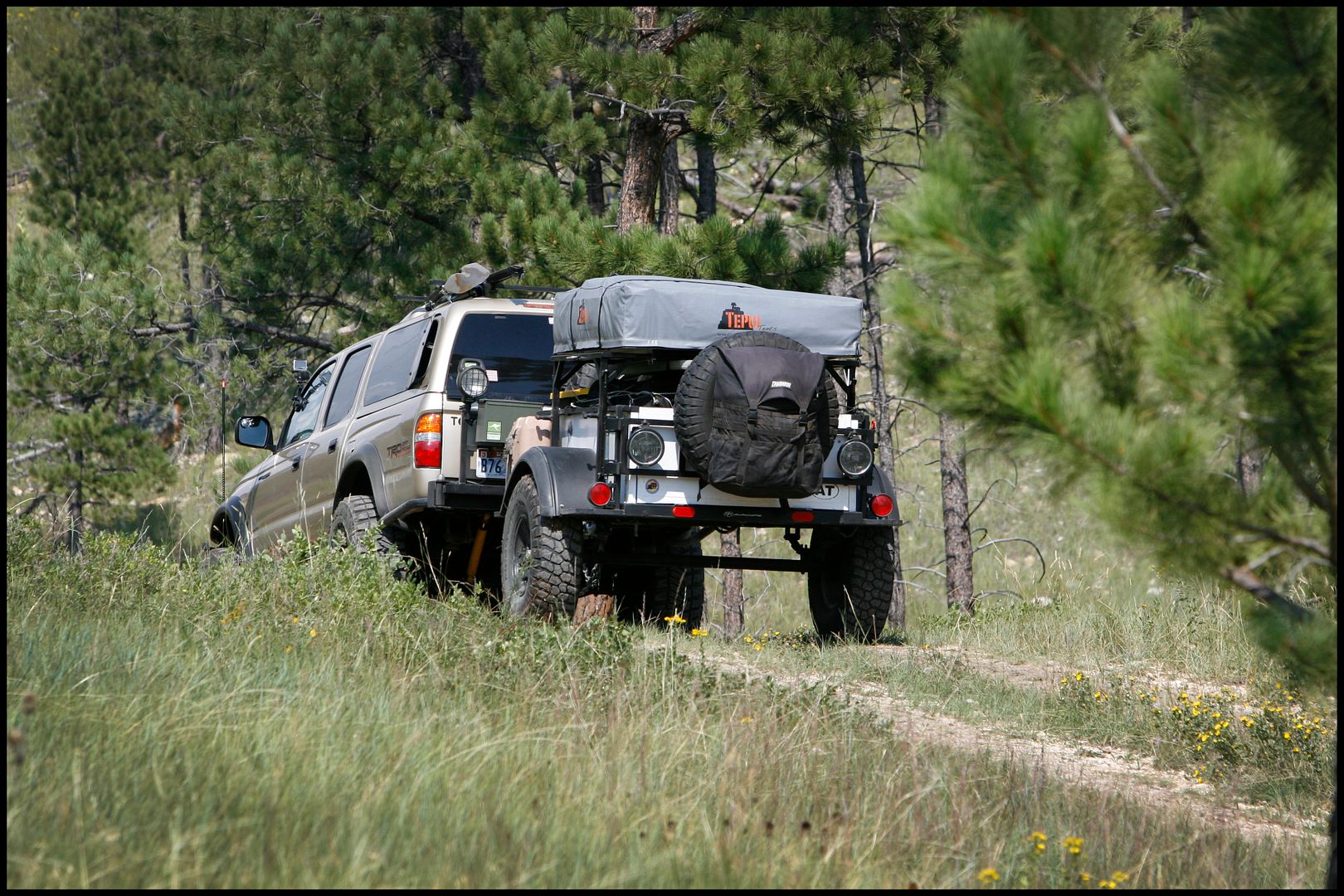

latch is a simple hitch pin
hinges are simple ones I got from Northern Tool
rubber bumps to keep it snug to the tailgate.

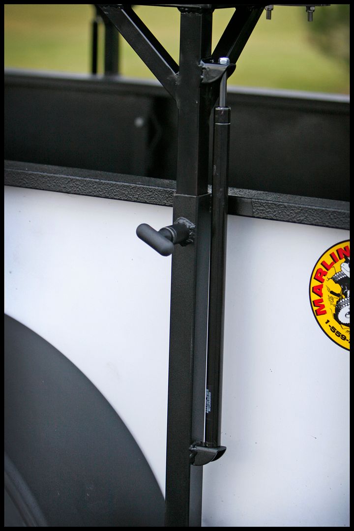

Tent rack
uses a pop pin and gas strut on all 4 corners. Pull the pins and the tent raises to the proper height for the annex and locks in place.
There is a handle on each side to pull it back down. Easier to put it down with two people but if I'm alone I can close up the tent and climb on top and there's enough weight to lower the tent rack back down to the lower position

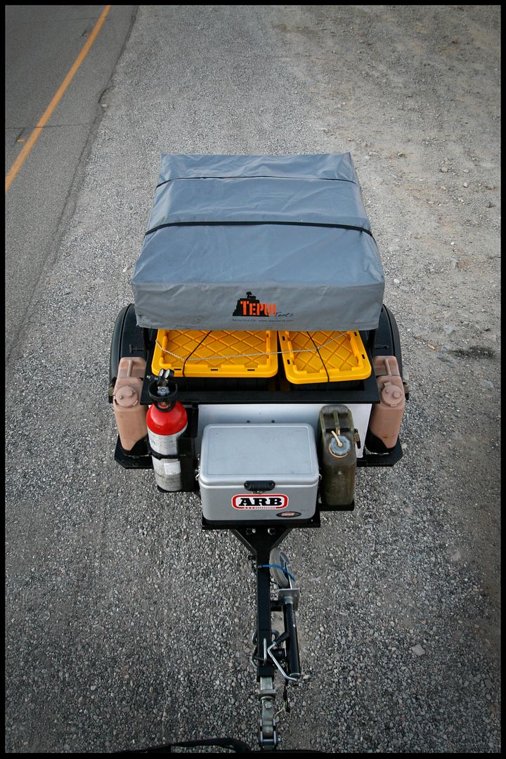

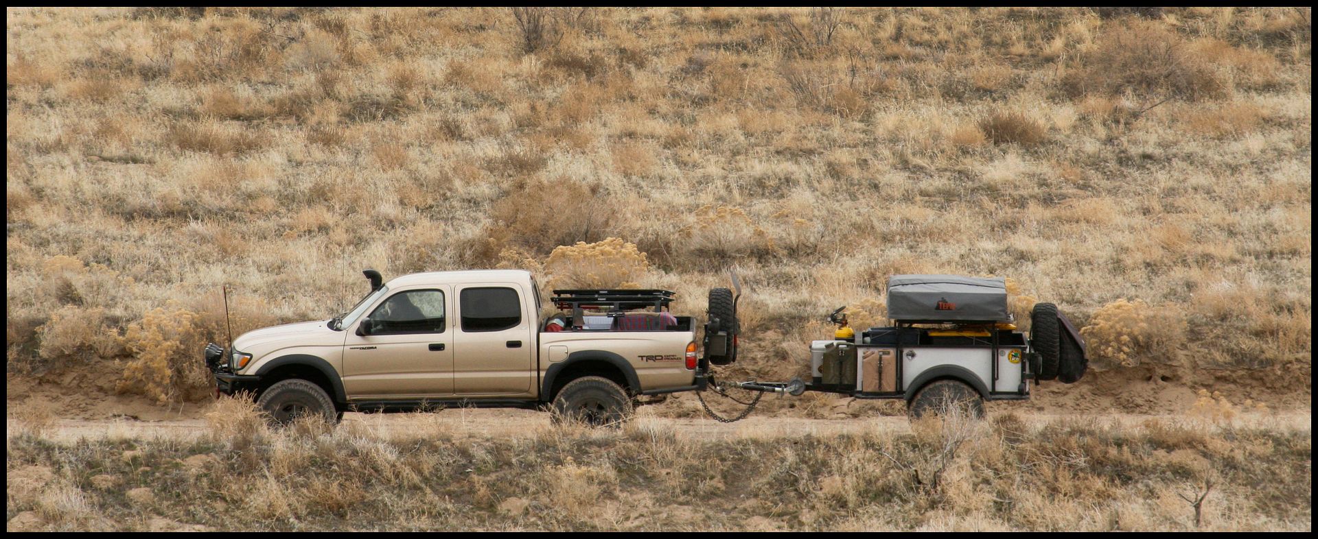

added a fuel can mount back to the front of the trailer, along with my CO2 tank. This helps to counter the weight of the tire carrier and keep the trailer balanced correctly with proper tongue weight.

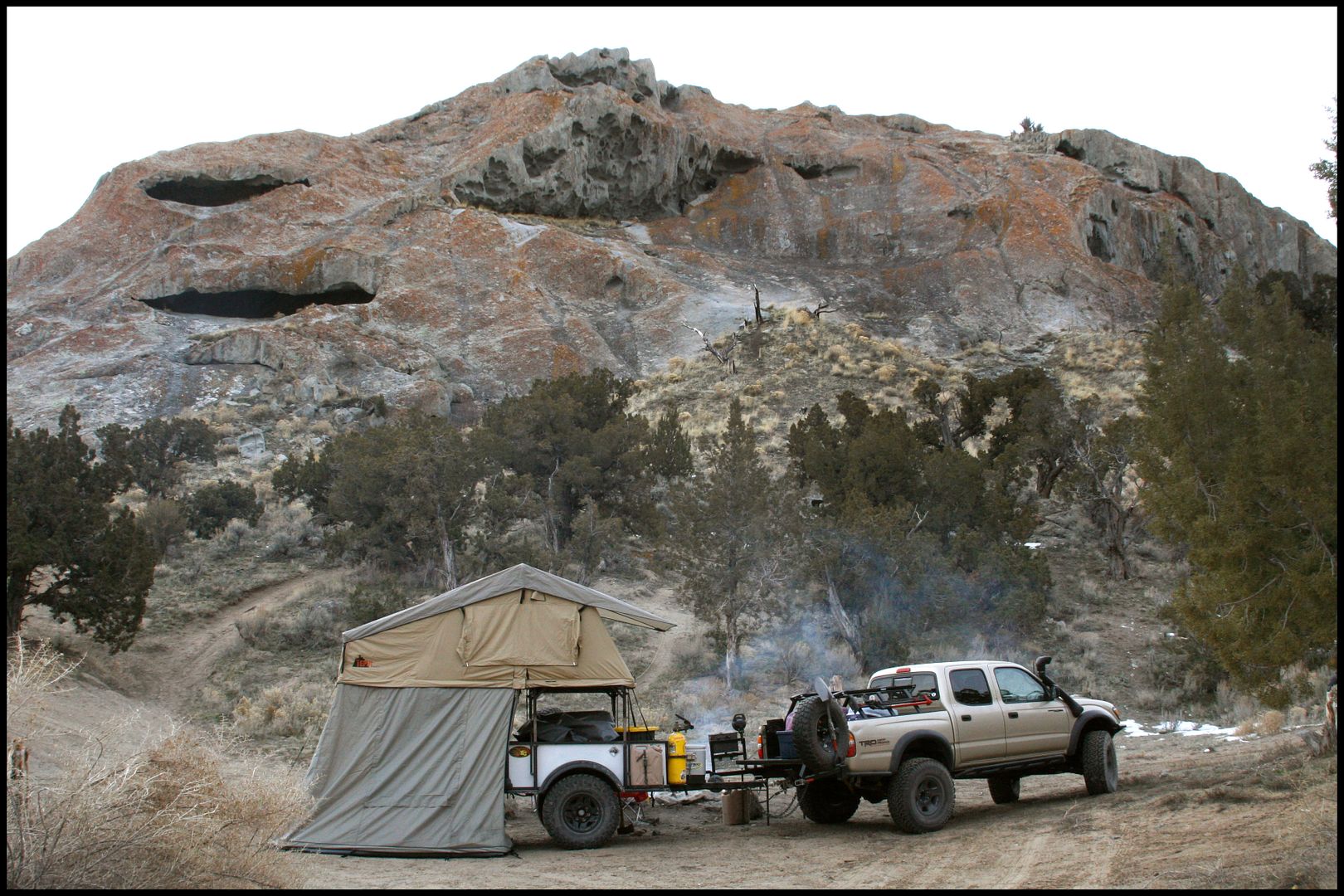

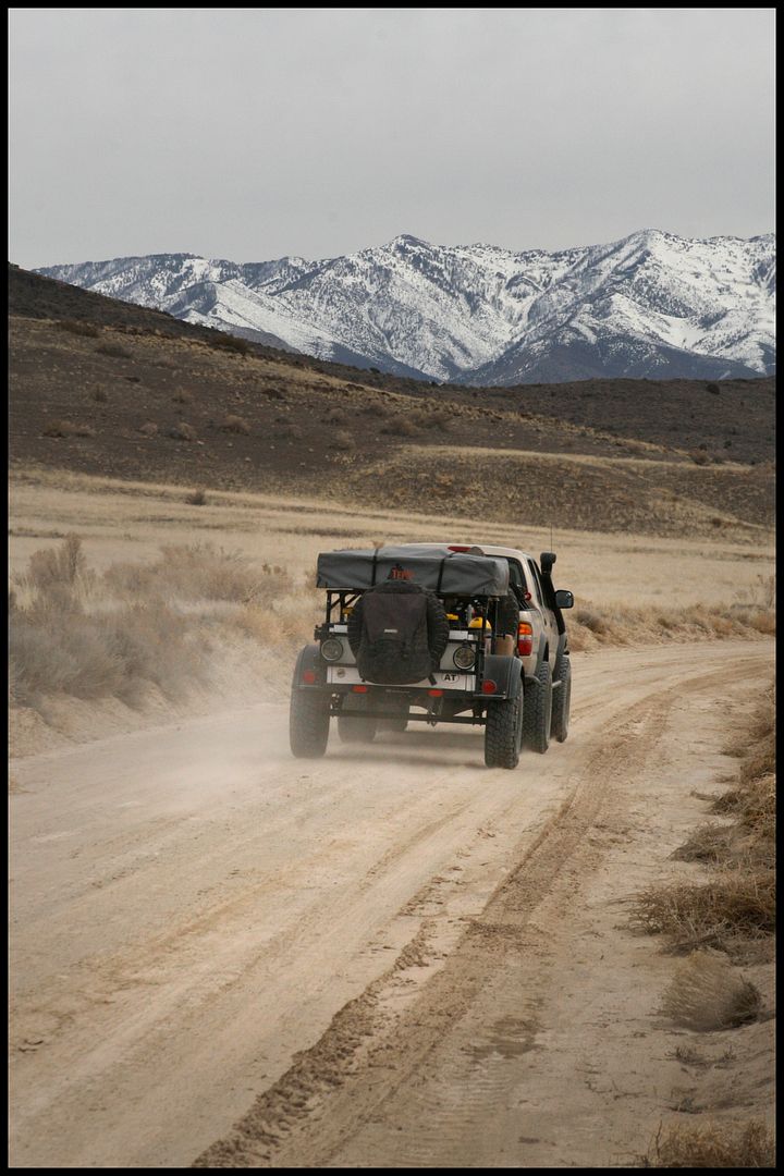

Few pics from our summer trip to South Dakota
