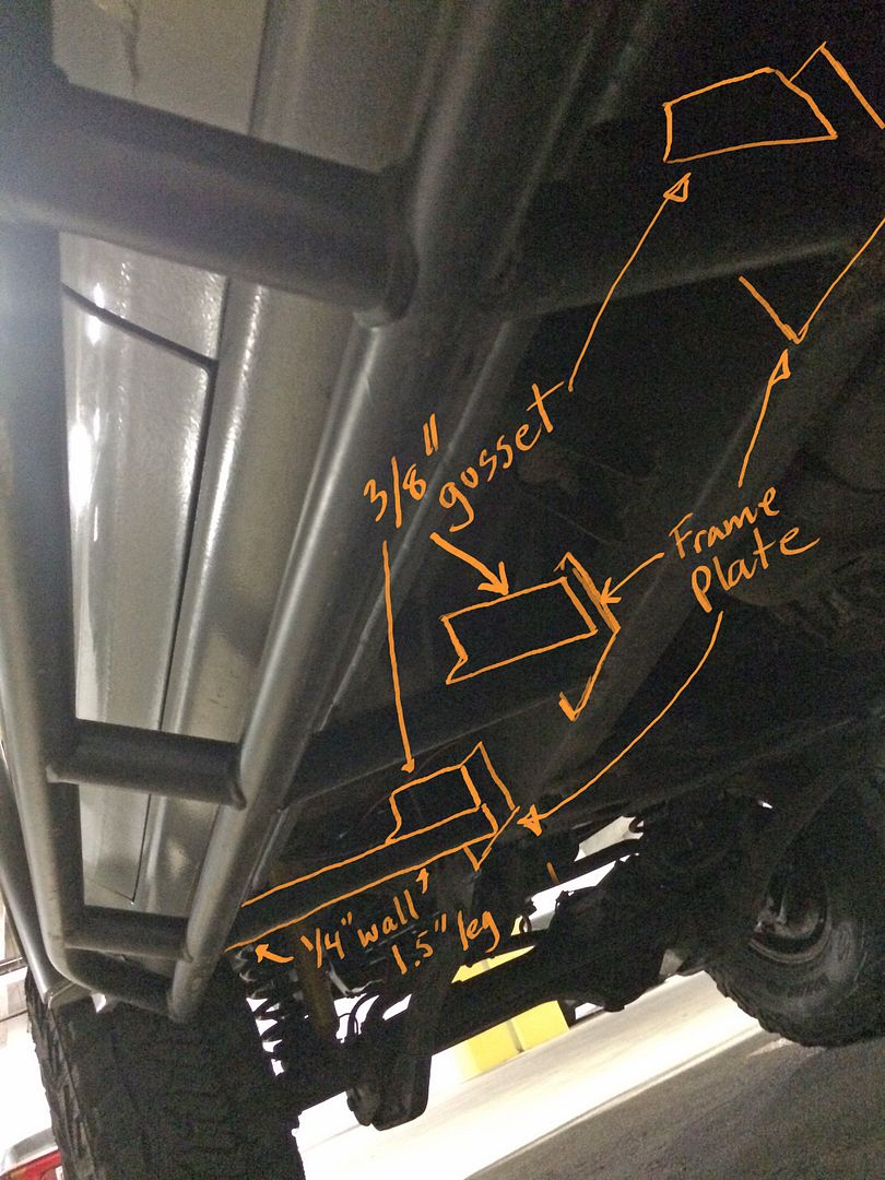

...I used some 1.5" 0.25" wall square tube for that front leg. It's crazy beefy but since it's a longer leg it helps to have heavier material. I made some big gussets from 0.5" plate. The sliders are welded to the frame using some 3/16" scab plates on the frame with the slider/gussets welded to the frame plates. On the passenger side I needed to bend the forward leg to pass under the cats...
Hey Adam, I've been thinking about these sliders ever since I read your post months ago. Getting ready to pull the trigger and order some this week or next. (Have a trip to Moab at the end of the month, and want to be ready ;-) Would you be so kind and snap a picture or two for me of the mounting method you described above. Just want to make sure that the picture in my mind corresponds with what you described. I think I understand gussets and scab plates, but a picture or two would give me peace of mind. I'd sure appreciate it. Thanks!

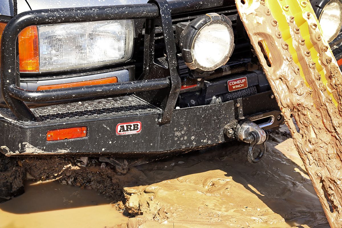

Couple-o-pics from the riverbed that necessitated the work. :)
