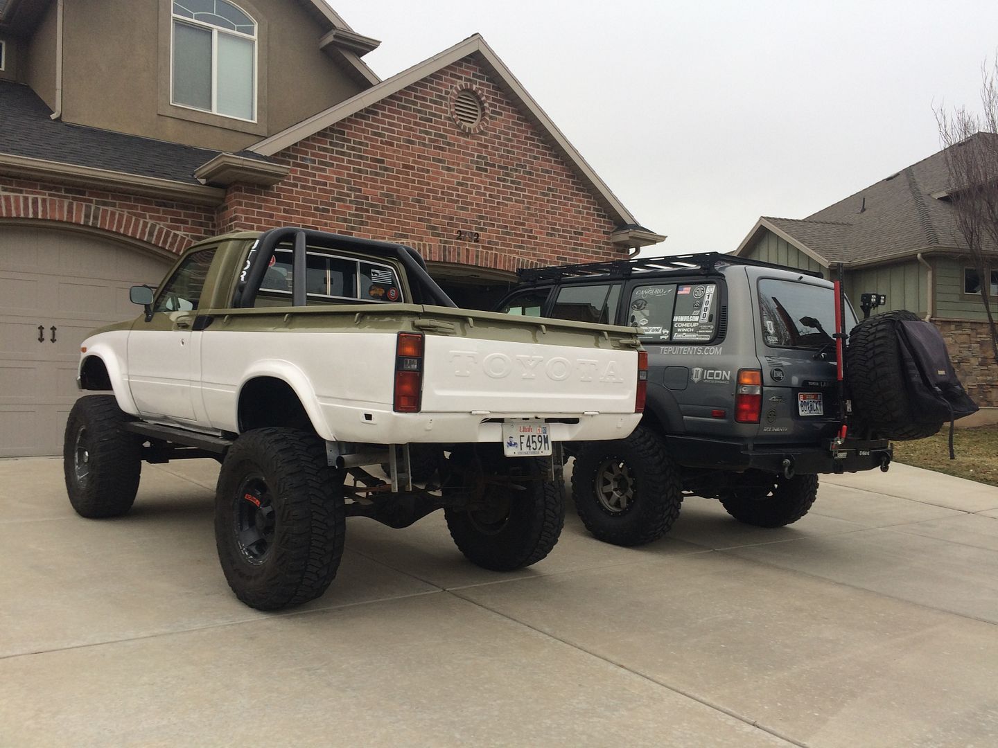

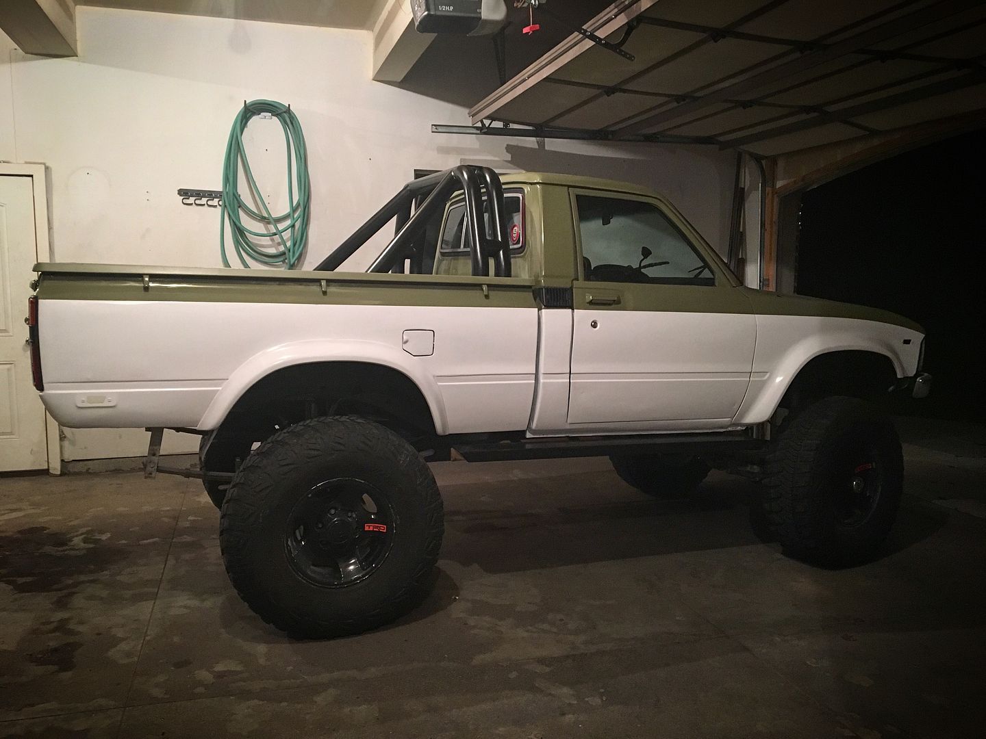

This first pic was from last week. Little old school style with the double-single rollbar. I got this from the PO when I bought the truck but it was in rough shape. Also I hated how these were a little tall. It was probably more "functional" with the main hoops being about 2" taller than the roof, but just looked weird. I cut the main tubes down a little and I'm much happier with the look. We cleaned it up and repainted it and now it doesn't look to bad.

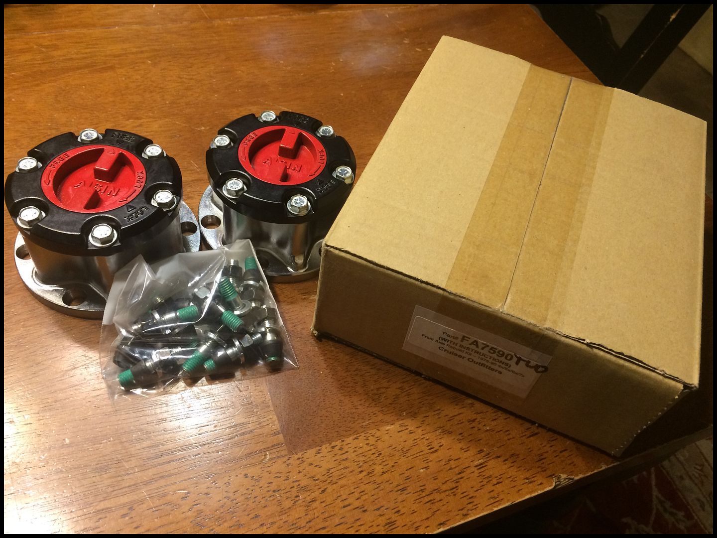

New Aisin hubs, full set of hub studs/conewashers etc, Complete front end rebuild kit with new bearings from Cruiser Outfitters.
Part-time kit coming soon I presume?
Ha ha... derp. I guess I should remember which thread I'm posting in!
