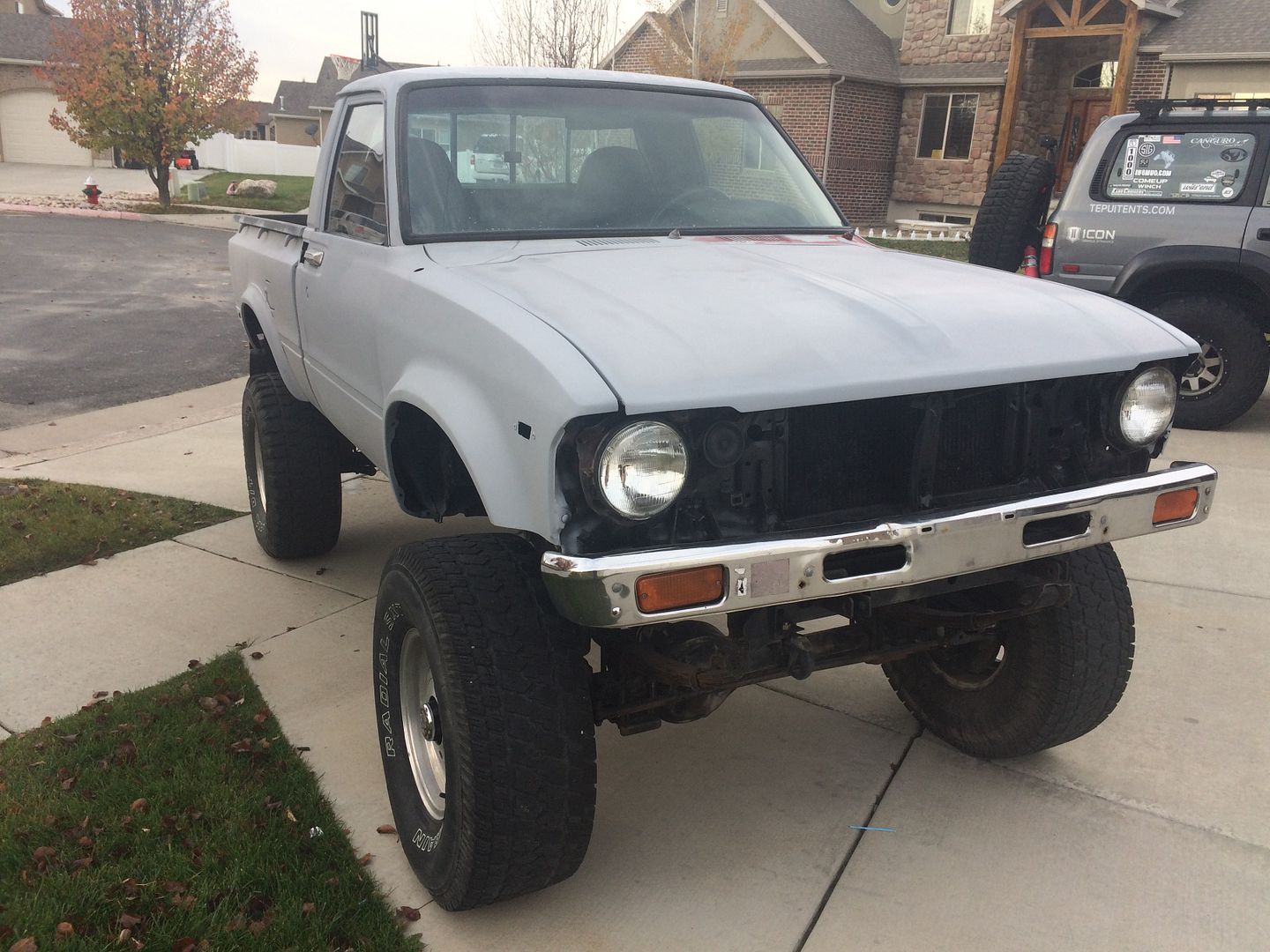

Making some progress. The deeper we get into this truck the more evidence there is that it's been "well used" and will never be a candidate for a show truck. But we weren't after that in the first place since it will be a first car for my 16 yr old and I'm sure will not only get used on trails but probably get tagged a time or two by careless drivers in the high school parking lot.

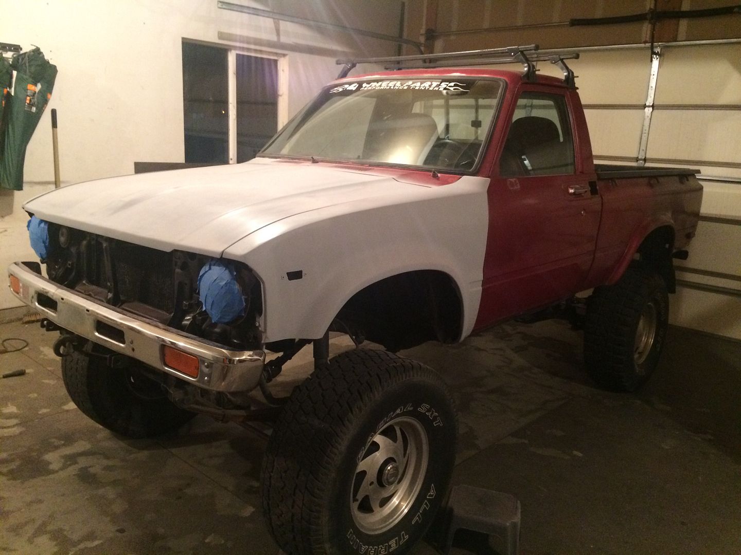

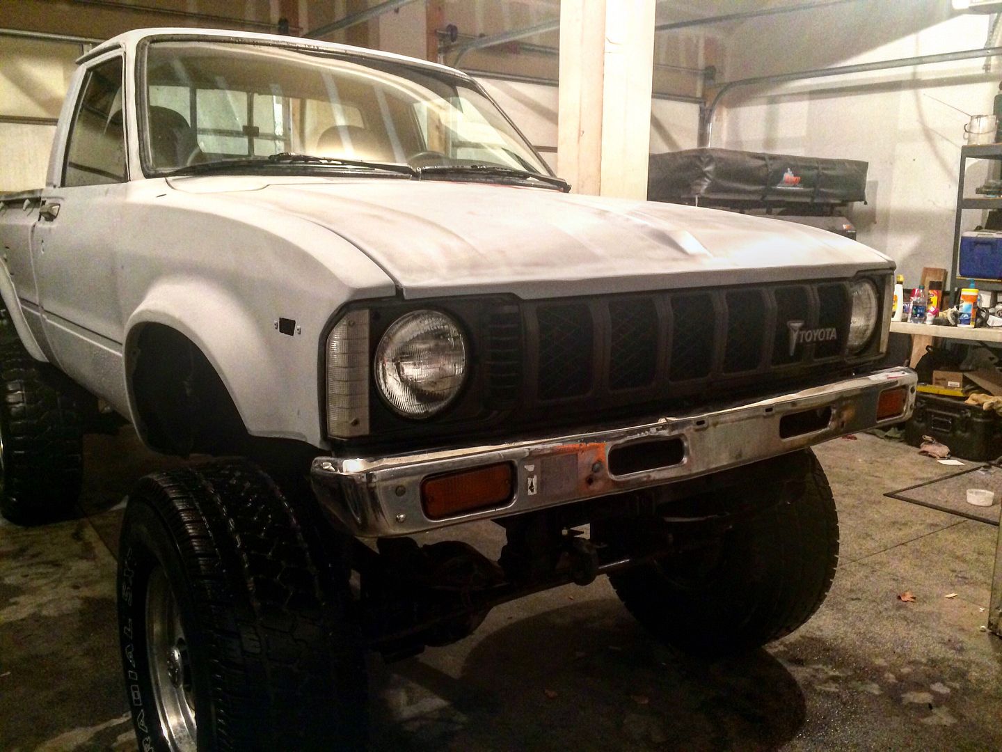

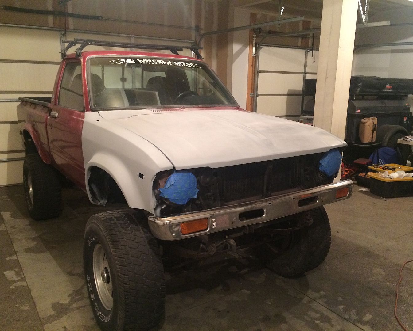

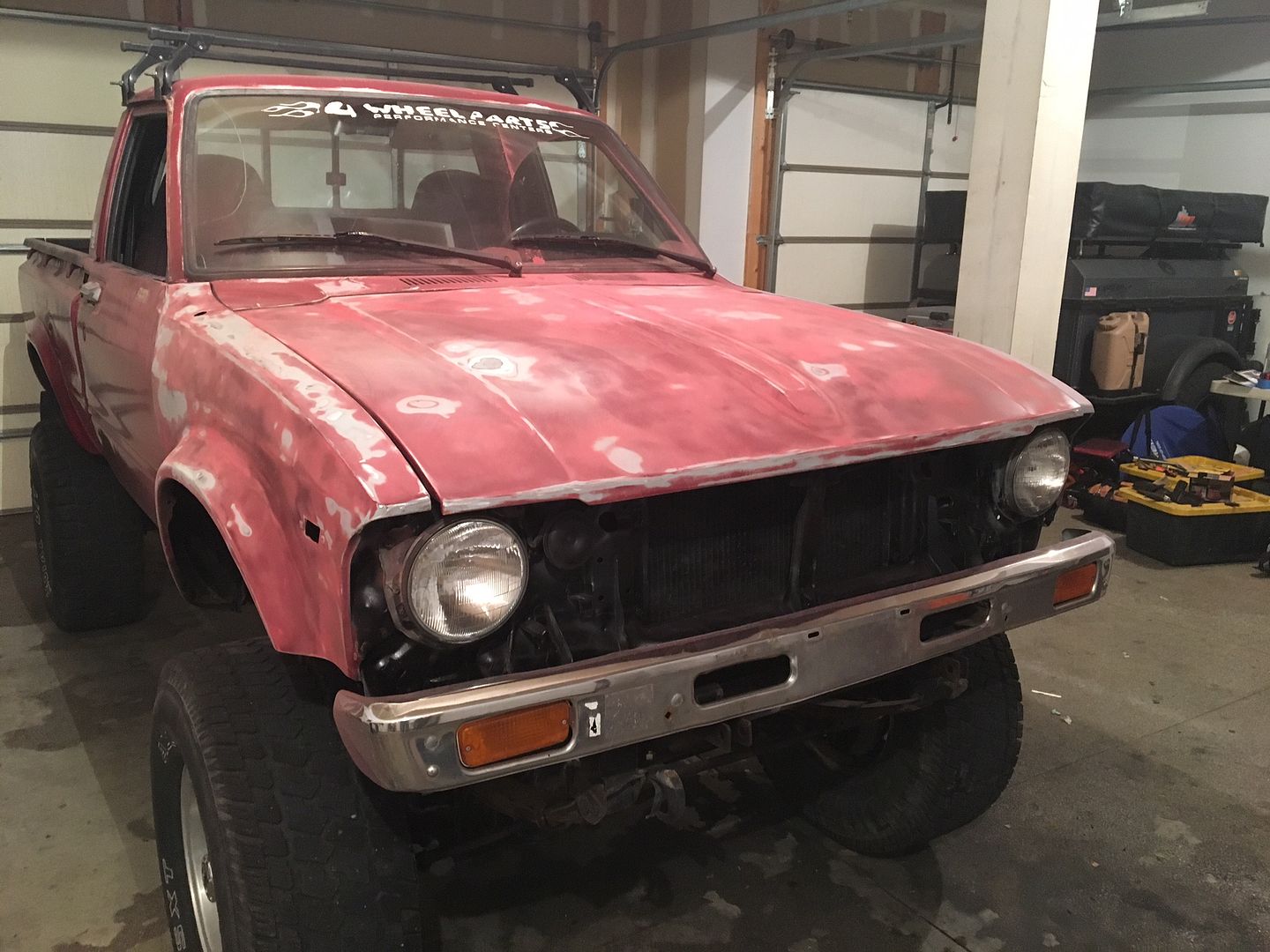

Hood and fenders and roof are sanded and primed, trimmed the front fenders since we removed the lower valence.

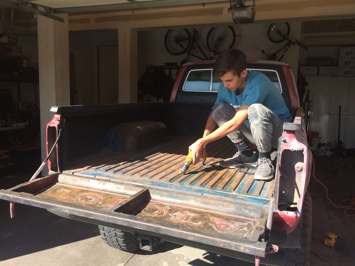

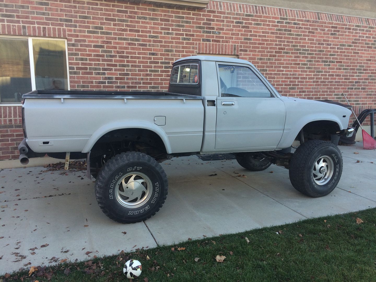

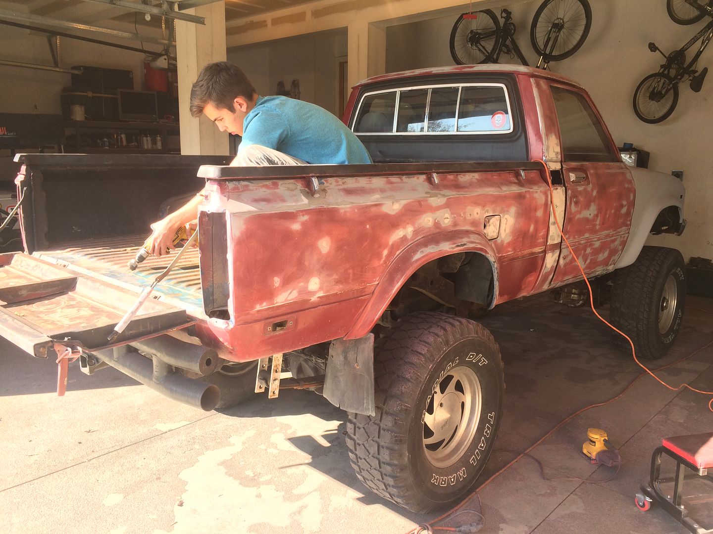

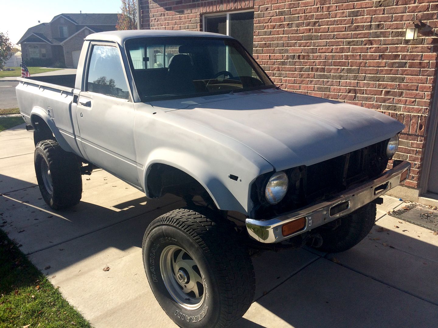

Cleaned up and did some fixing of the biggest dings etc on the passenger side and got it sanded and primed. Bed is getting wire wheeled in prep for some monstaliner. Hoping to get the driver side to this same point this week.

We have plans to upgrade the headlights for sure. I'm looking for LED options if I can find a good one just for the lower amperage. If not, then we'll look at halogens. The 7" round lights are pretty common so there are some other 7" LED or HID lights out there that could work but would probably take a bit of custom wiring. But anything will be better than the stock sealed beam. :hillbilly:
We'll get the bed protected as well as we can. I'm not one for having things loose in the bed. I'm funny that way, even when I was just going around town in my Tacoma I always tied stuff down. So I'm not too worried about lose things denting the bed from the inside as I am things denting the bed from the outside. ;)

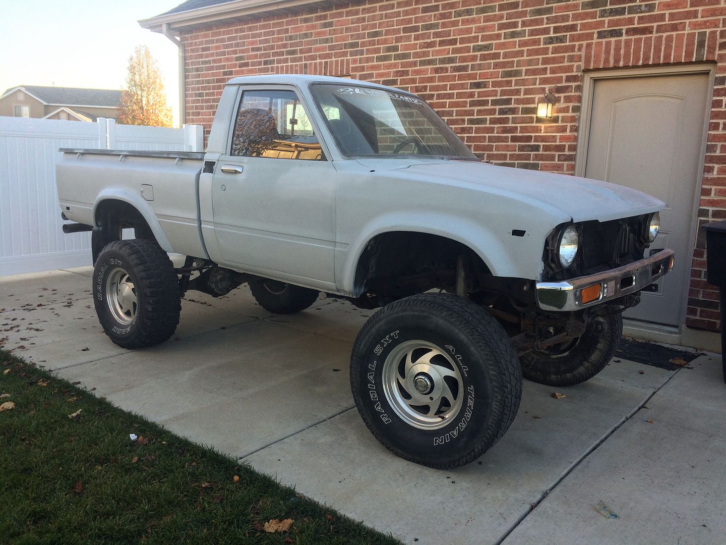

We did finish our grill mod and get it reinstalled.
