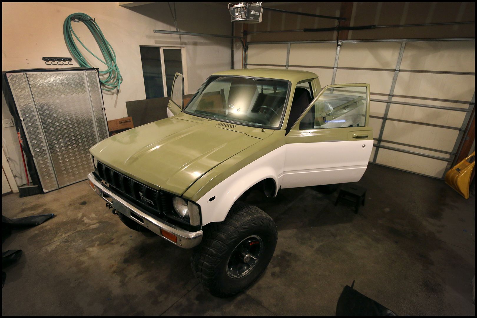

Yes. We'll do a wet sand and clear coat to finish it off. Should be ok when we're done.
As for a paint booth...
Didn't really do much. Just cleaned the floor and watered the floor to keep any dust down.

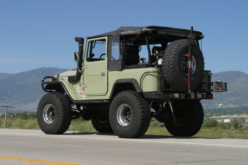

I painted my old FJ40 back in 2000 with a single stage paint and from what I understand the paint still looks good, but I haven't seen the truck since 2004. I used a paint booth when I did that one along with a nice HVLP gun.

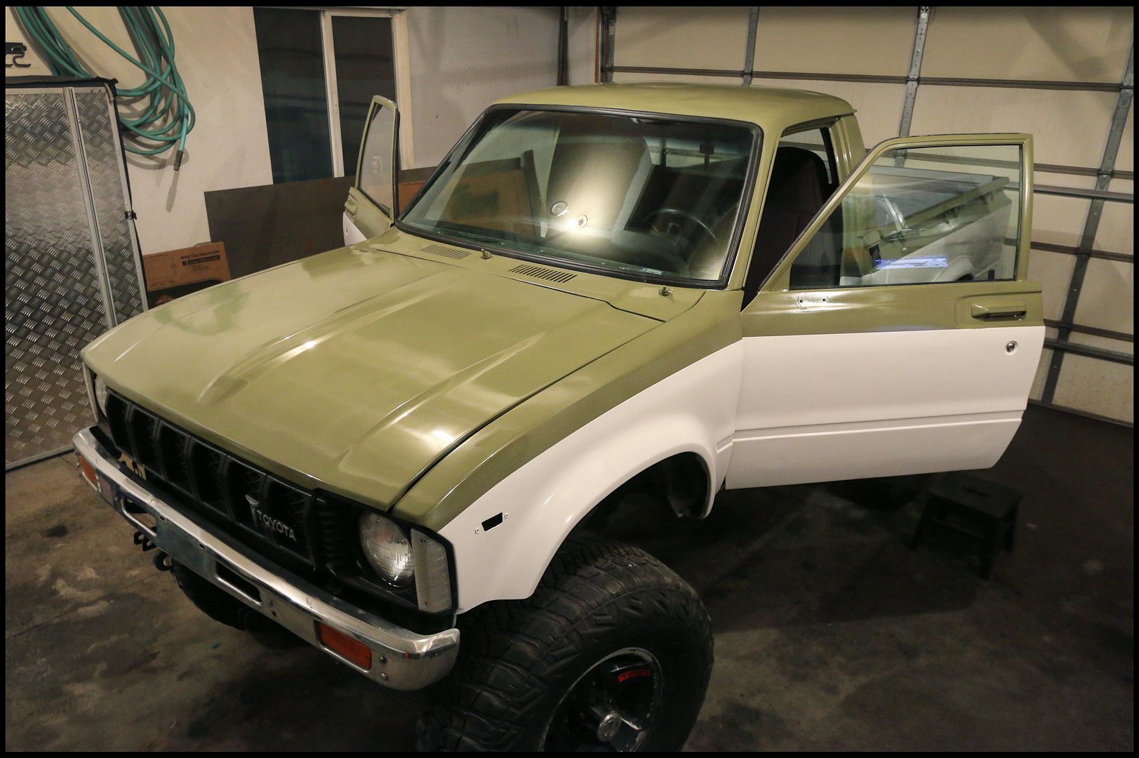

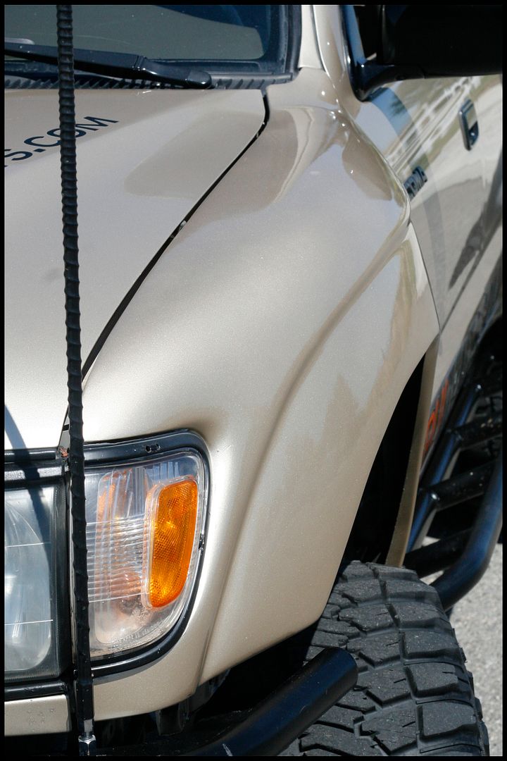

Wow!, very nice work and in a garage with spray cans no less...you do some great stuff on the cheap :-)
Your line looks pretty darn straight from the picture, impressed!
Cheers!
Wow!, very nice work and in a garage with spray cans no less...you do some great stuff on the cheap :)

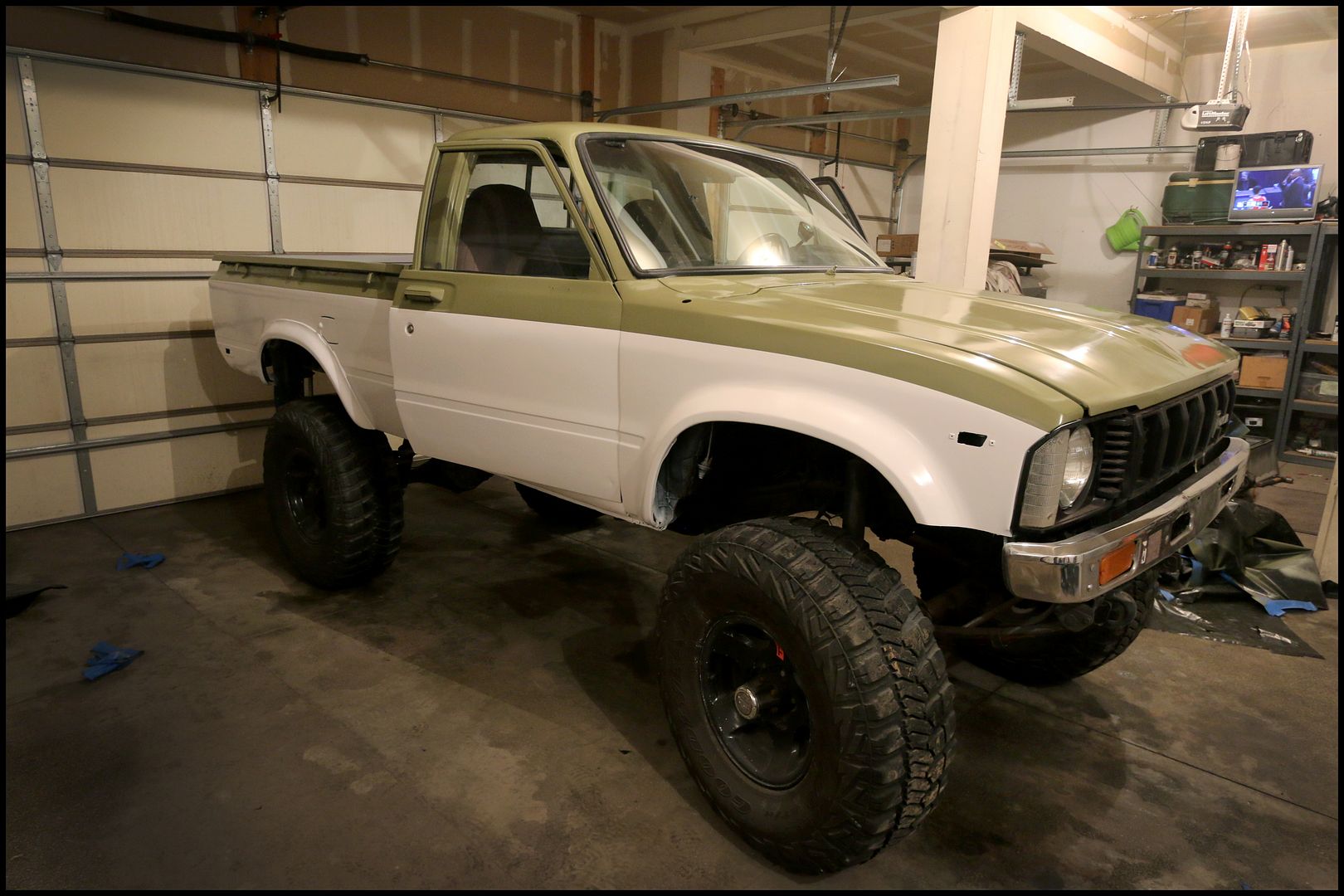

Thanks. The line is pretty good I think. Little hard to tell in the pics since the doors are open so the door jams can dry.

Thanks. We're into the paint and body work a total of $150 so far.

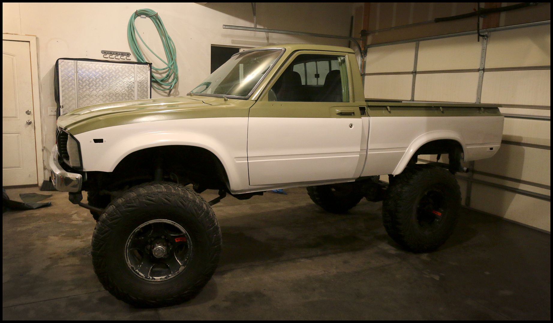

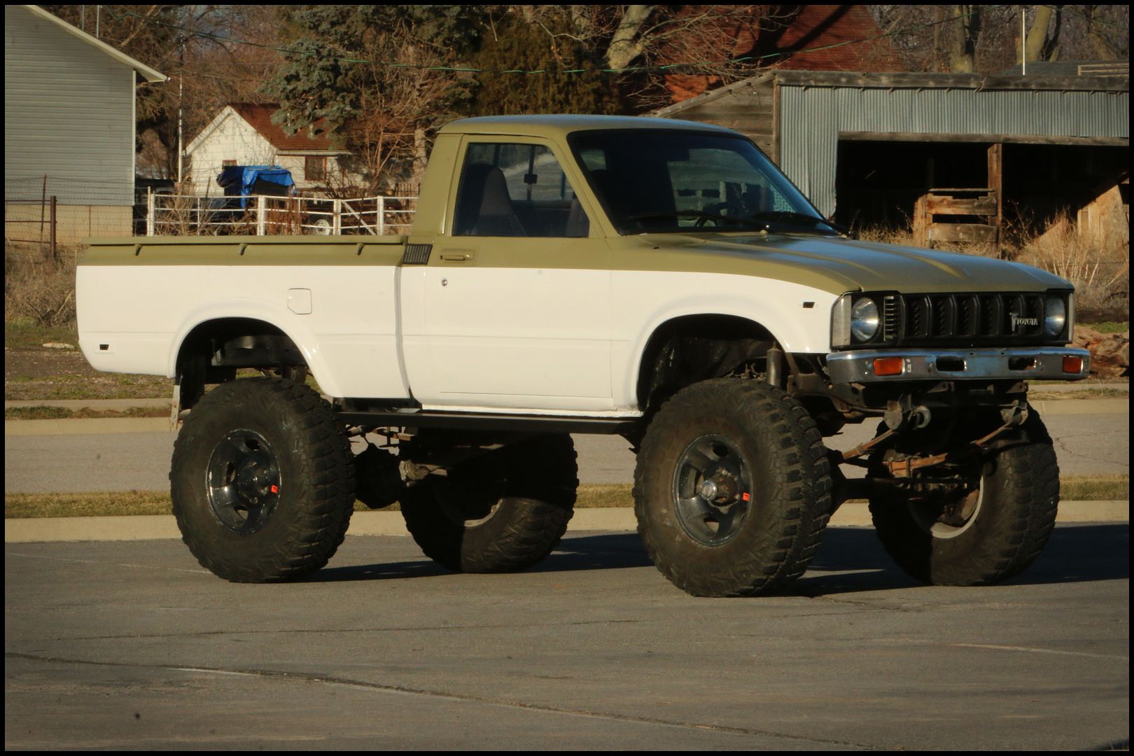

I got the clearcoat sprayed. It came out ok, but it's a $150 paintjob so definitely not perfect. It's a "ten-footer", looks good from ten feet away. :) I think we'll do a bit of wet sanding to smooth out a few spots and call it good.

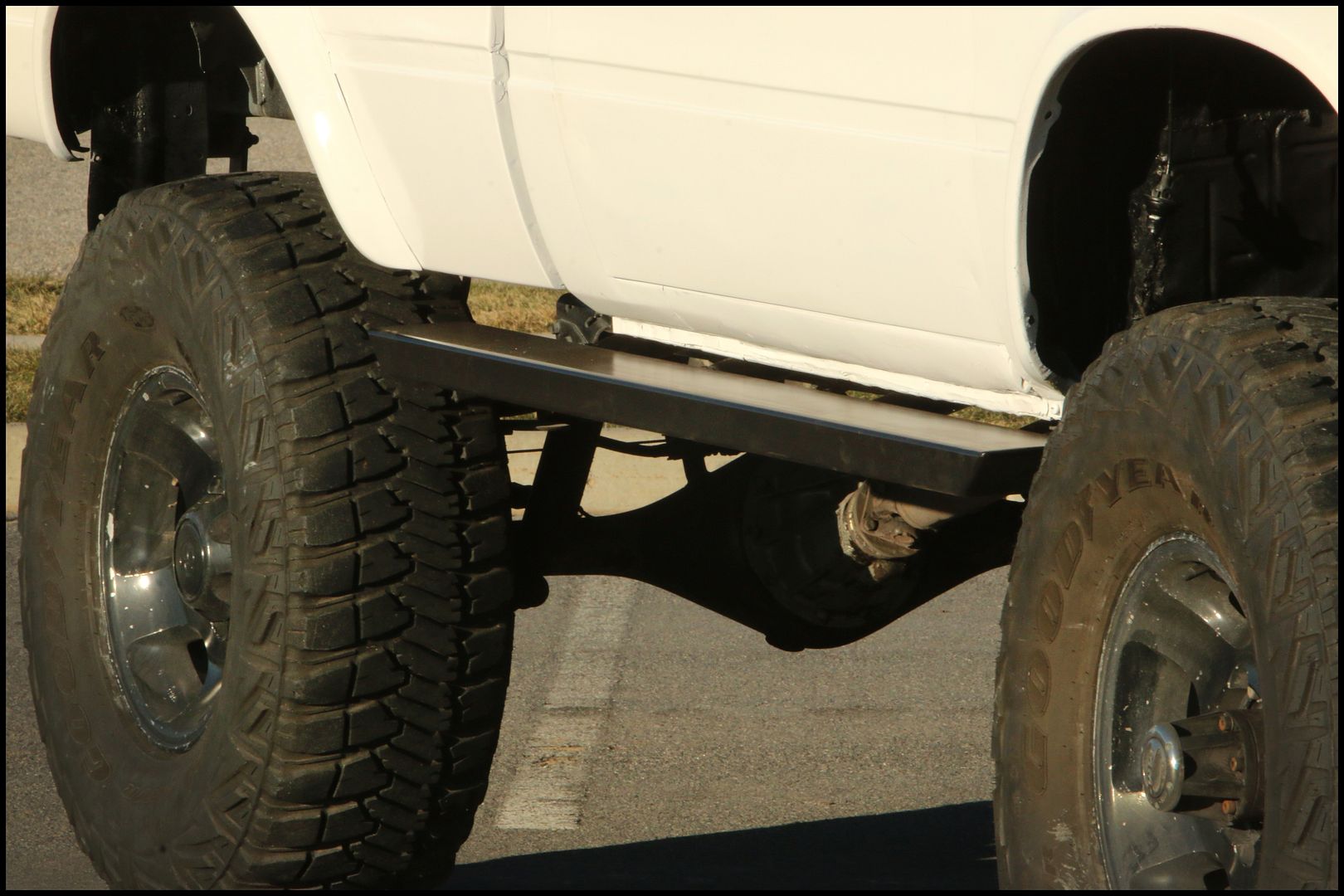

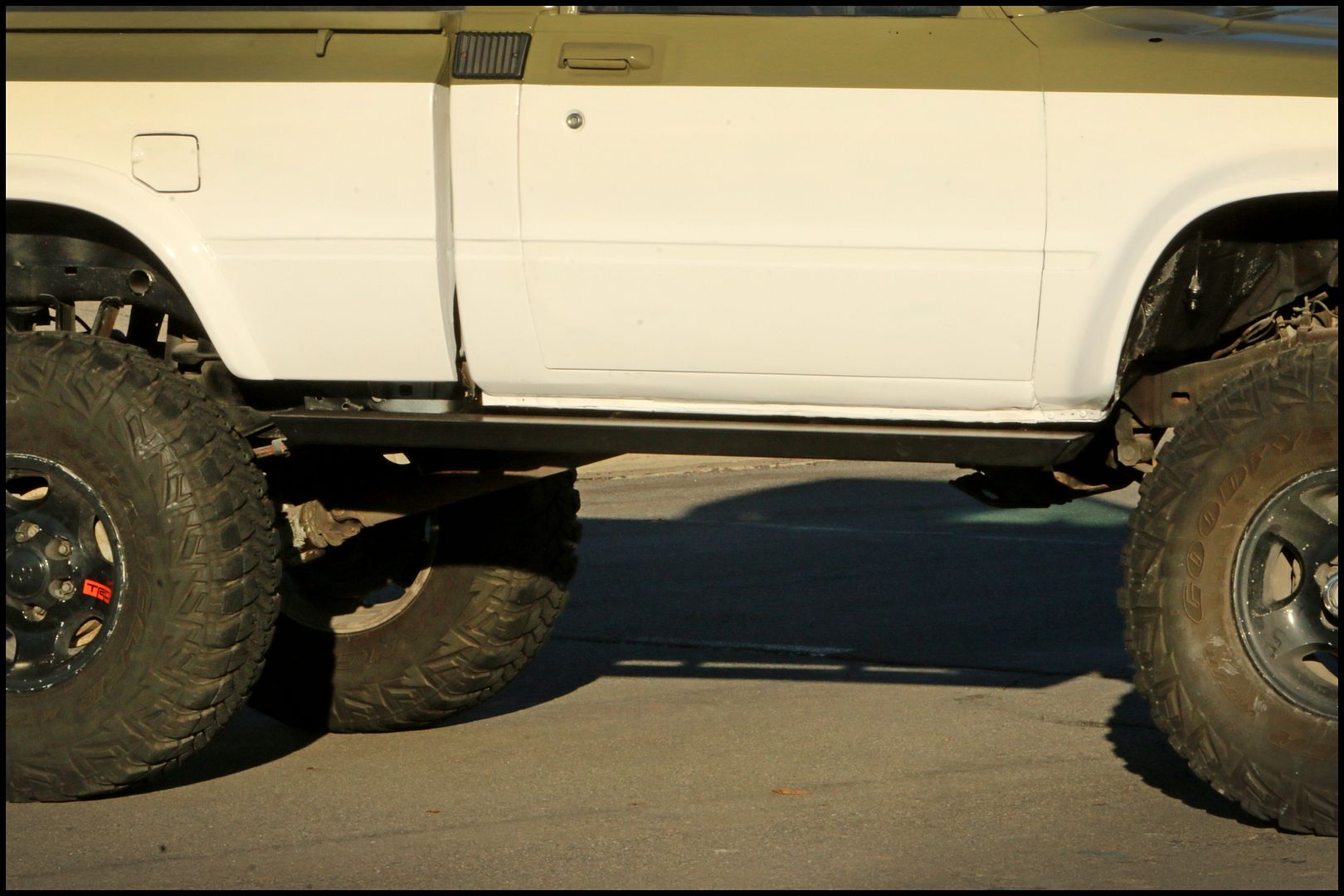

Also got some sliders built and mounted. These are massive overkill on this truck but I guess that's not a bad thing. We wanted a bit of a step to make getting into the cab easier and still have good rocker protection. Round tube could have worked but it's the best step. I decided to use 5x2 3/16" wall rec tube. They are heavy duty! I have no doubt they are stronger than the sliders on my 80. Anyway, simple no frills, descrete and good protection with full coverage of the rockers and should keep the doors away from rocks. Welded to the frame with 4 gusseted legs.

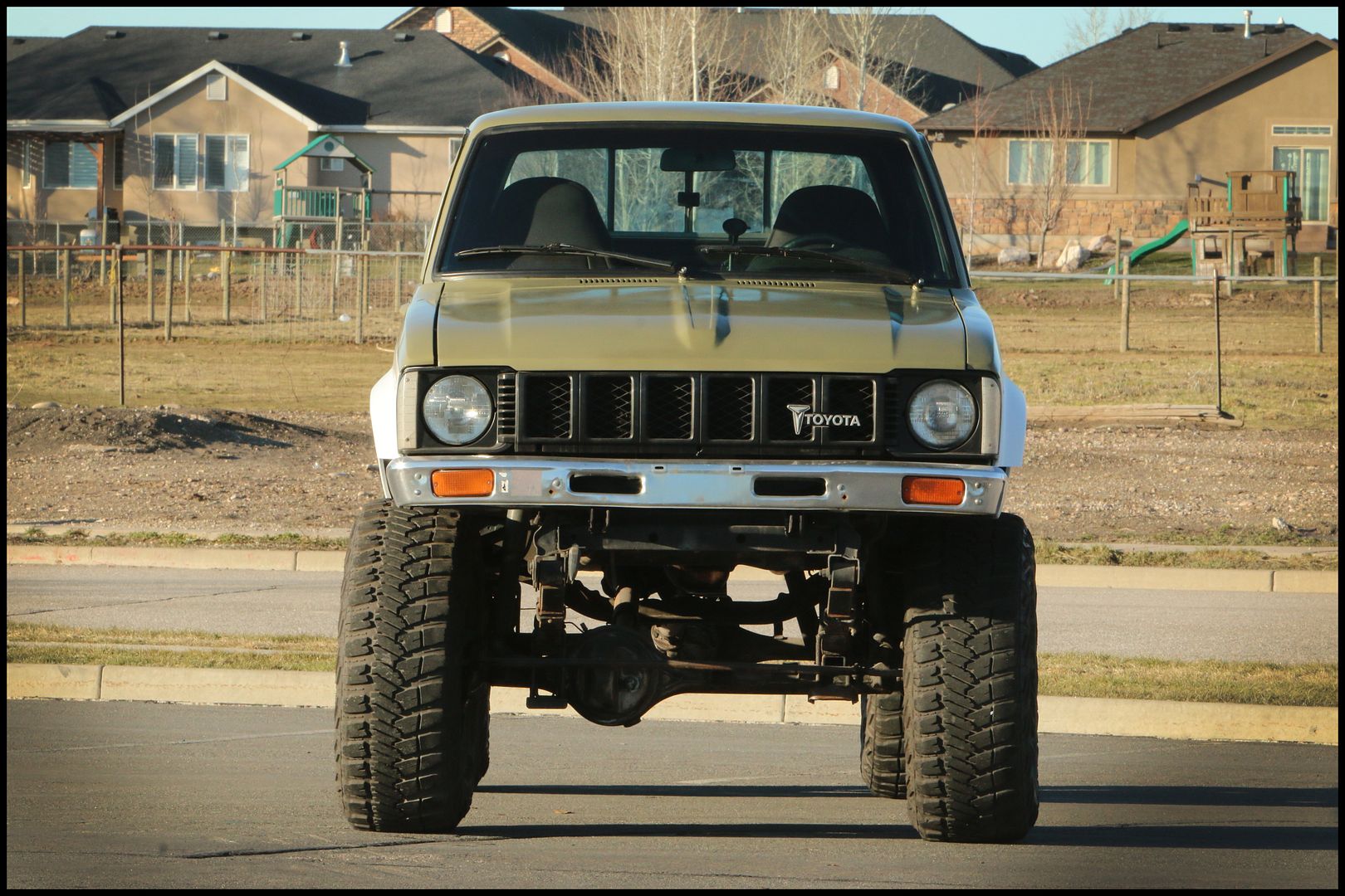

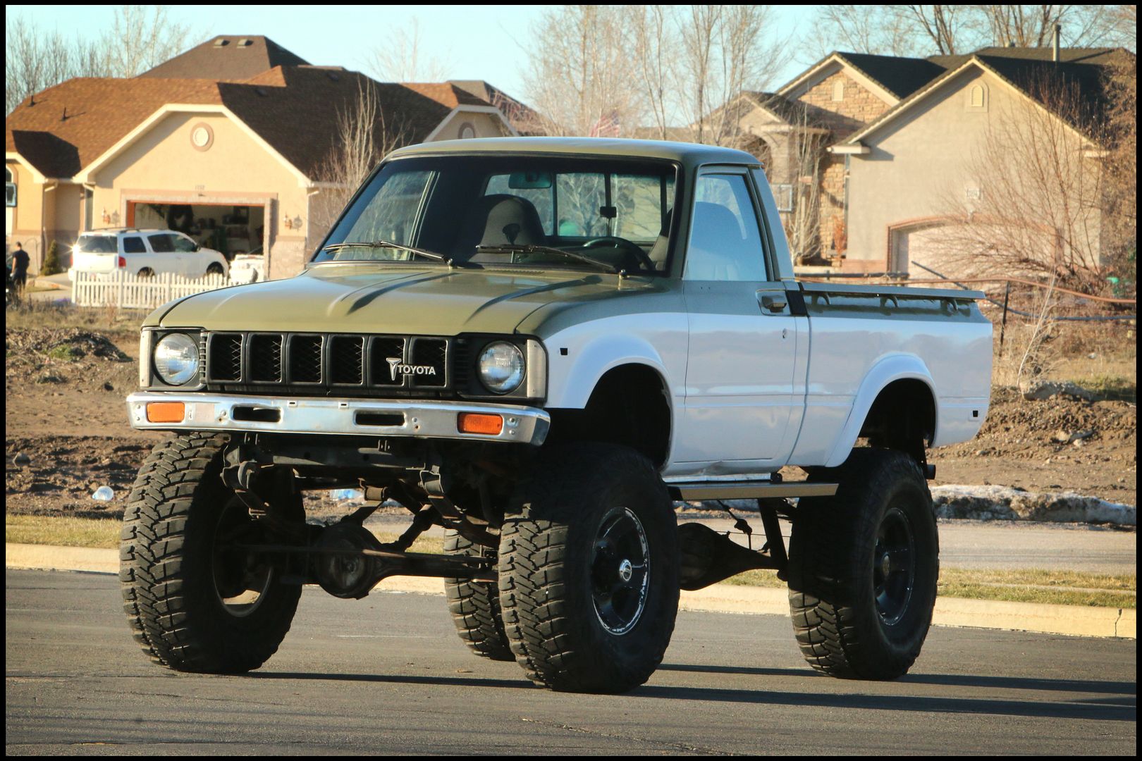

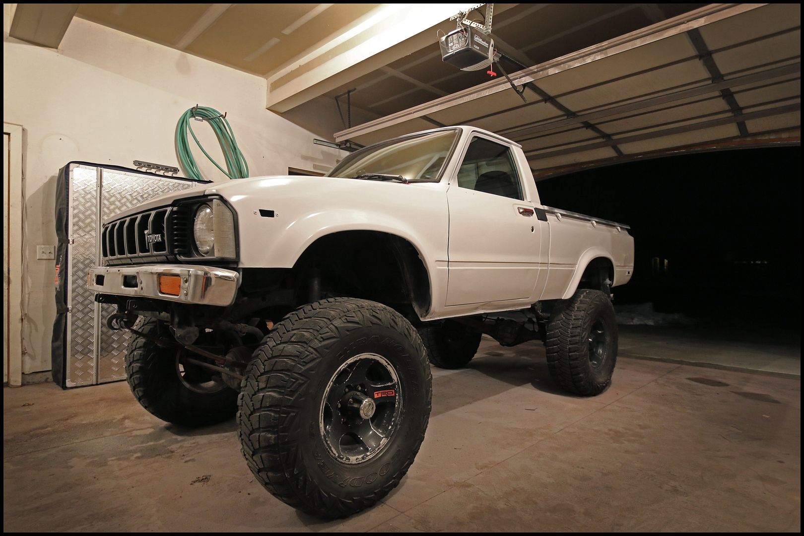

Next up is a suspension overhaul, and addressing the front axle that has numerous issues.

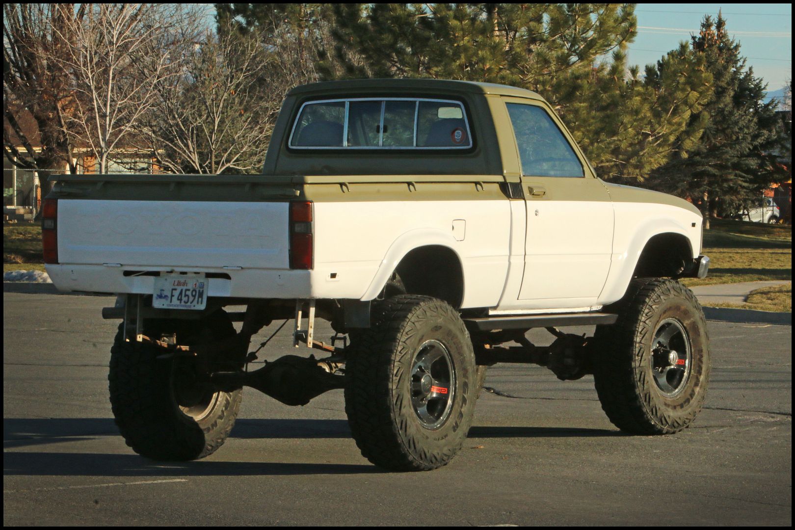

Yes I know the camber looks completely wonky. Likely bad bearings but I need to check for a bent housing. It's not as bad as it looks in this photo because the wheels are slightly turned which seems to exaggerate the effect. Look at the pic from a few weeks ago with the front wheels straight and you can see it's definitely not as wonky.
Sliders
