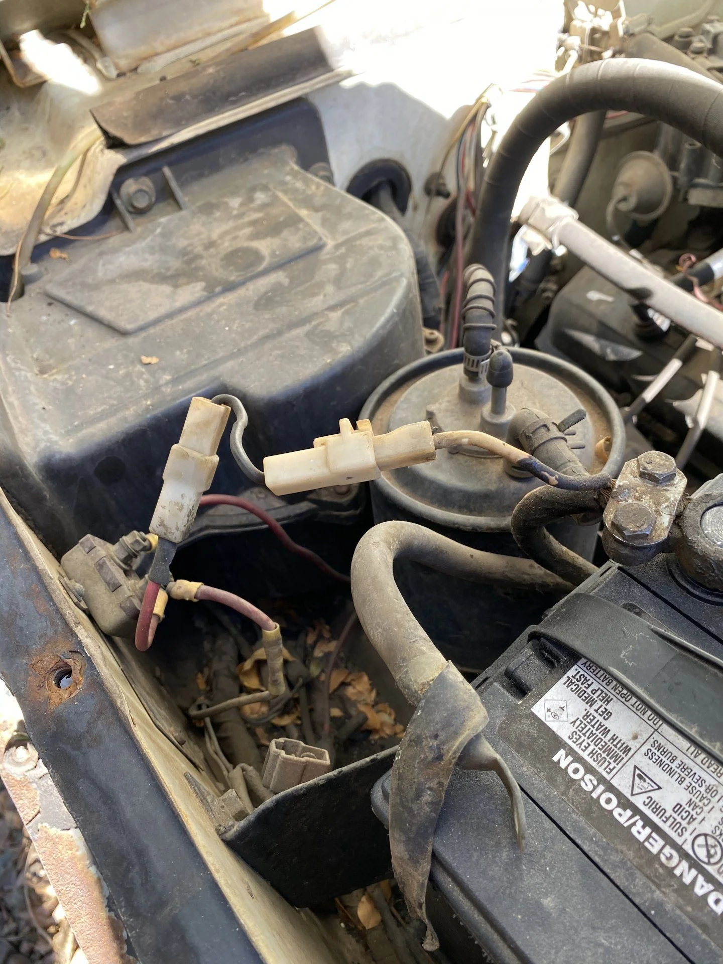

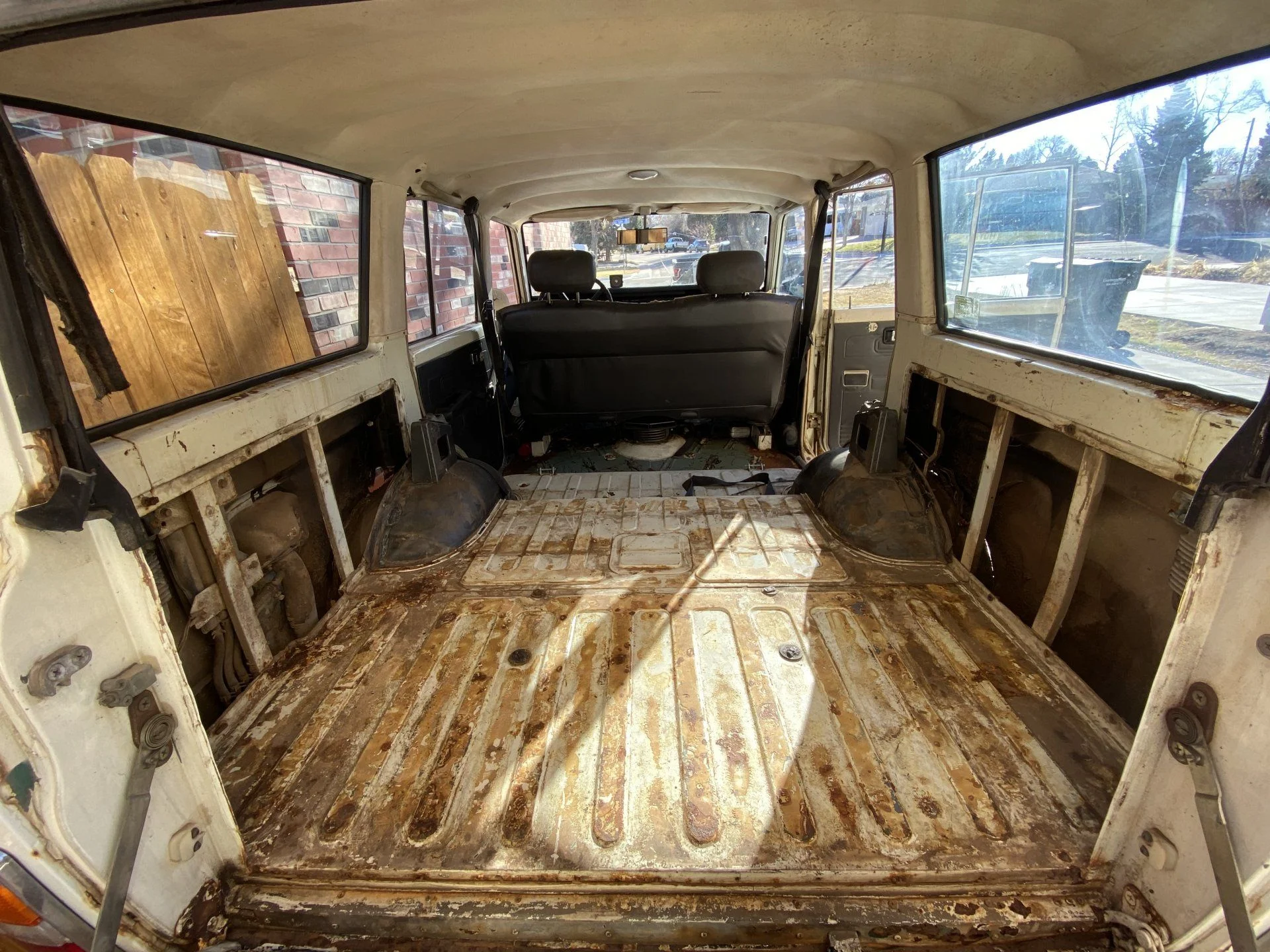

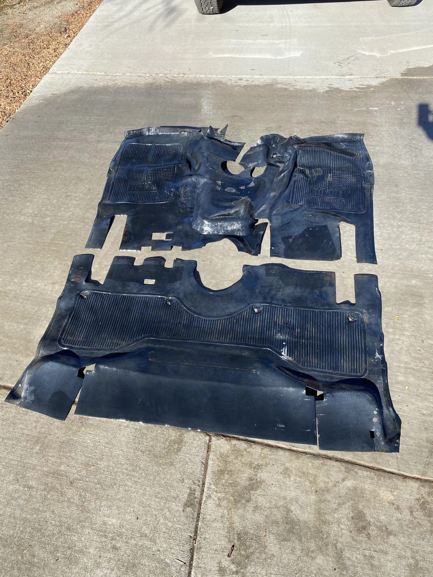

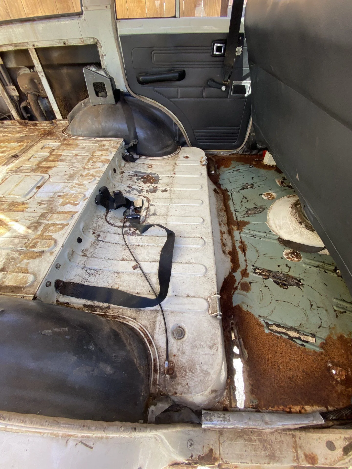

Another quick day on the Pig, taking care of some housekeeping. Trying to get down to a clean slate (finally). Washed off the mouse pee from the floor mats and pulled the back cargo panels and seat. Also, found some questionable wiring that lead to a no start situation, need to add that to the list of cleanup. Trying not to get overwhelmed looking at new holes I am finding. One step at a time, channeling my inner @wngrog and taking notes on his latest project. Hopefully mine is salvageable!

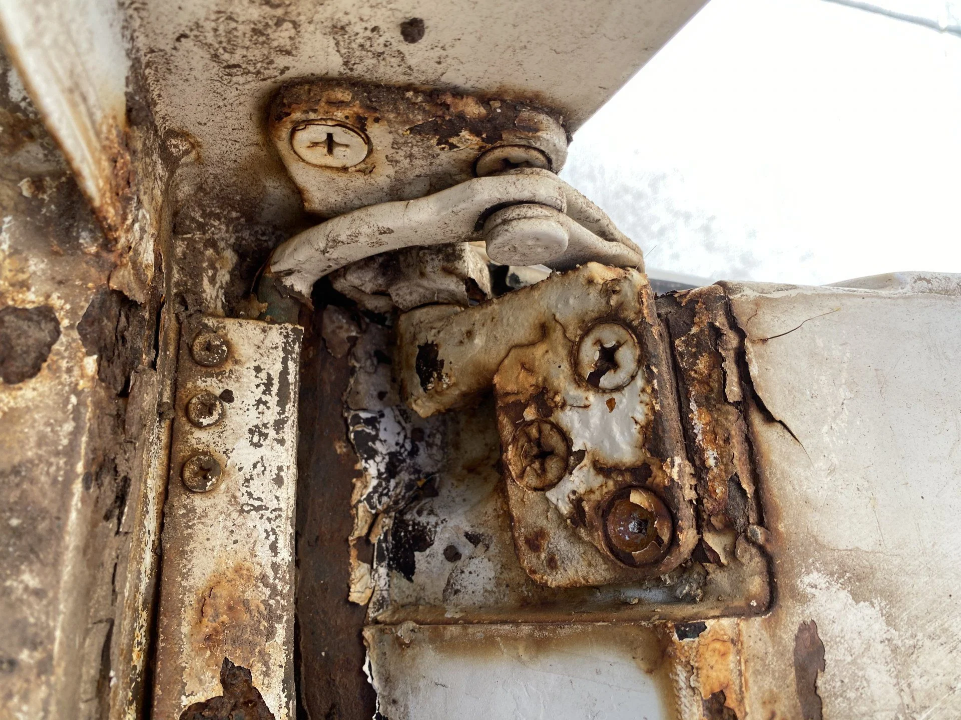

***Also, any suggestions with getting the back tailgate screws out? I already started to try and drill out the other side.
Impact driver may work...
I had some luck welding a nut to the screw head. The heat from welding helps free up the screw and you can get a good bite with a wrench on the nut.
Would JB Weld work? Haha. Fresh out of a welder.
@PabloCruise used the impact with no luck. I’ve also used a torch on it but didn’t seem to make a difference.
Yeah the torch is the way to go. I found that I needed it to heat longer than what I expected. Heat heat and then heat some more and use one of those hamer impact things. You know it twists as you beat on it with a hammer. Be careful when you hammer the body side. I hammered away and got them out, but on reassembly found out that I had hammered the whole body mount out so that I had to use shims to bring the opening back to the oridginal width. It makes me sad when I get surprises like that!
