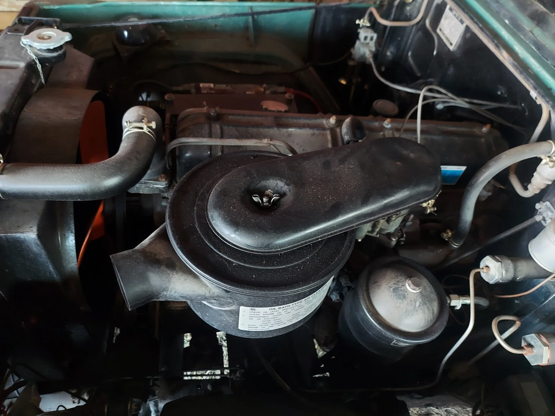

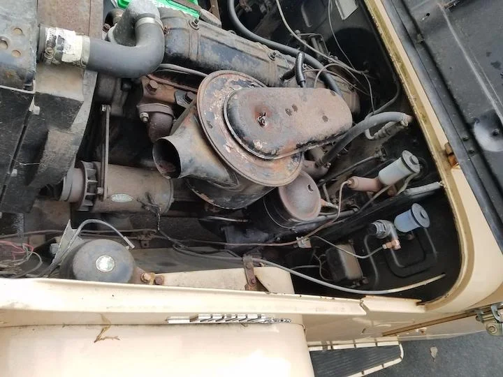

Anyone know what the correct air cleaner was in 1962? I have this:
And also another that took a hit at some point.
Maybe the answer is neither. If so, know what years they did belong to?
It does, thanks. I think the design was also around in 1961, per a classfied ID.
Man I think I would attempt to remove the yellow with Good off or acetone and see how it looks before immediately jumping into a frame-off. Get it driving first! :)

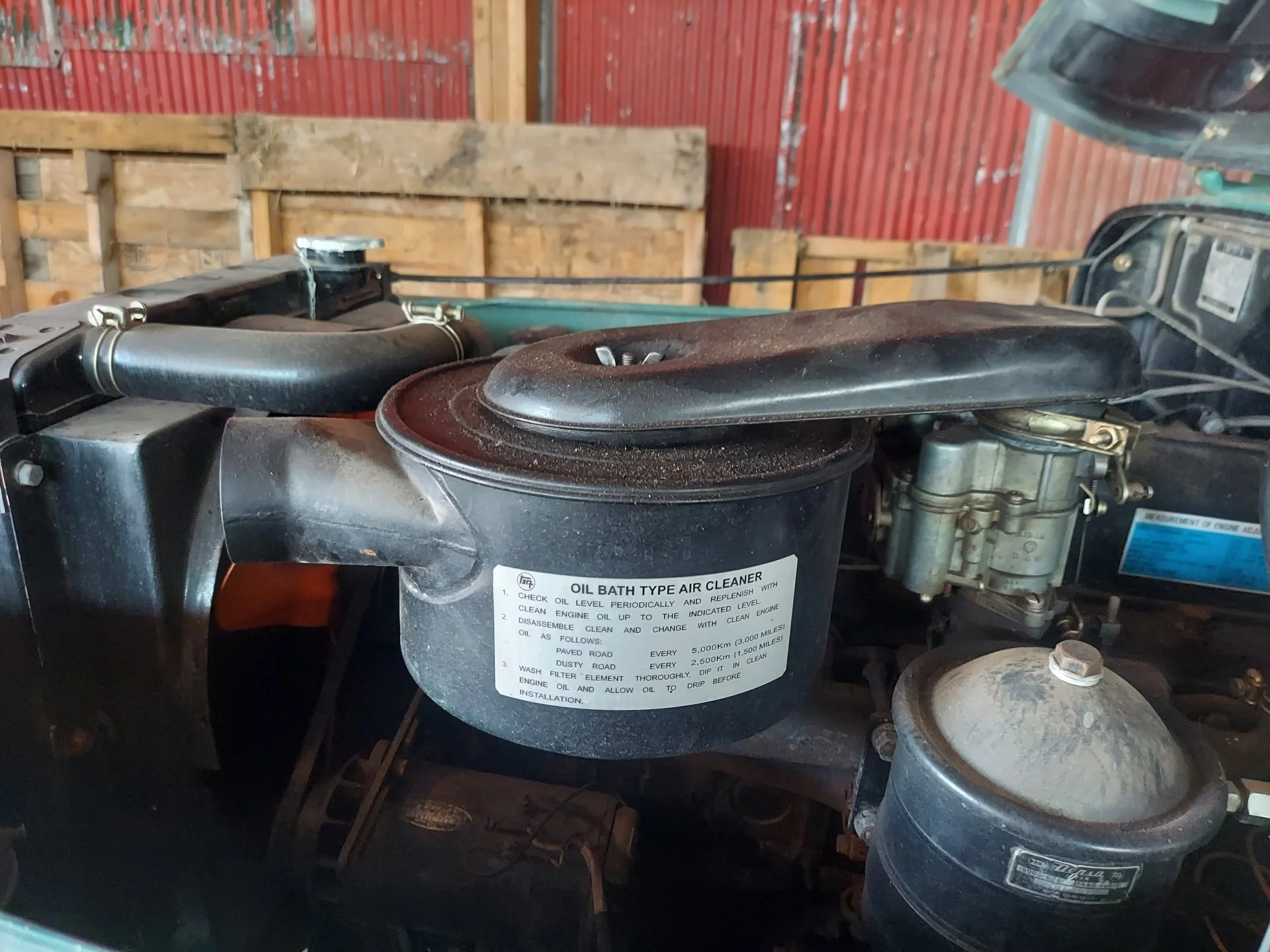

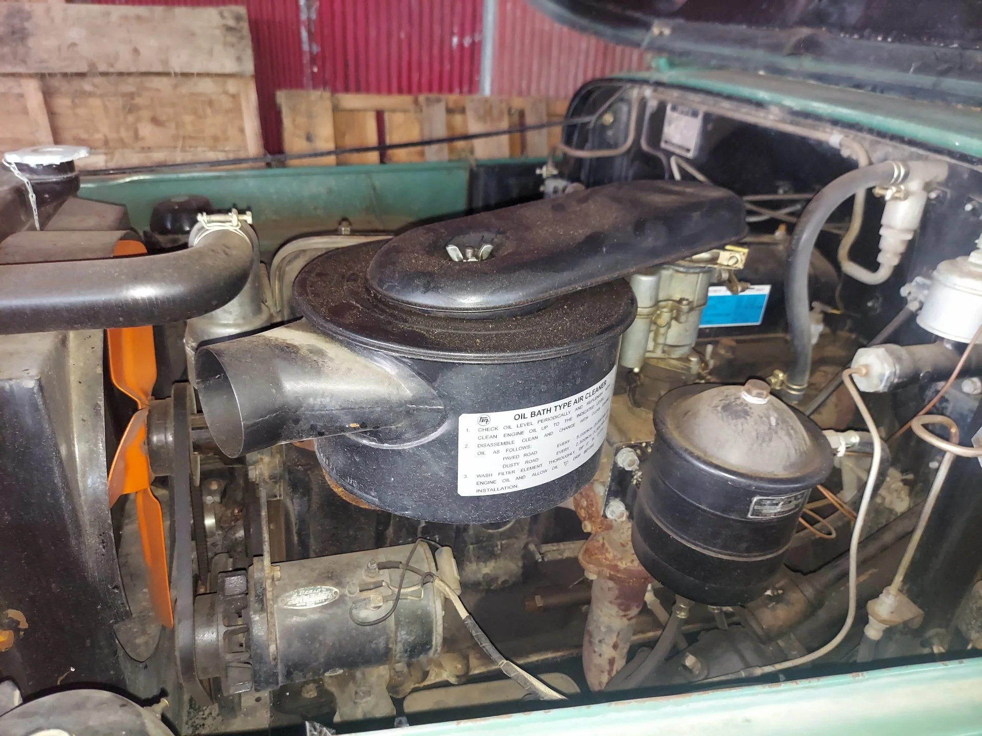

I think you should have this air cleaner, this is in a 63 Cruiser. I think dog kibble was a dealer add on.

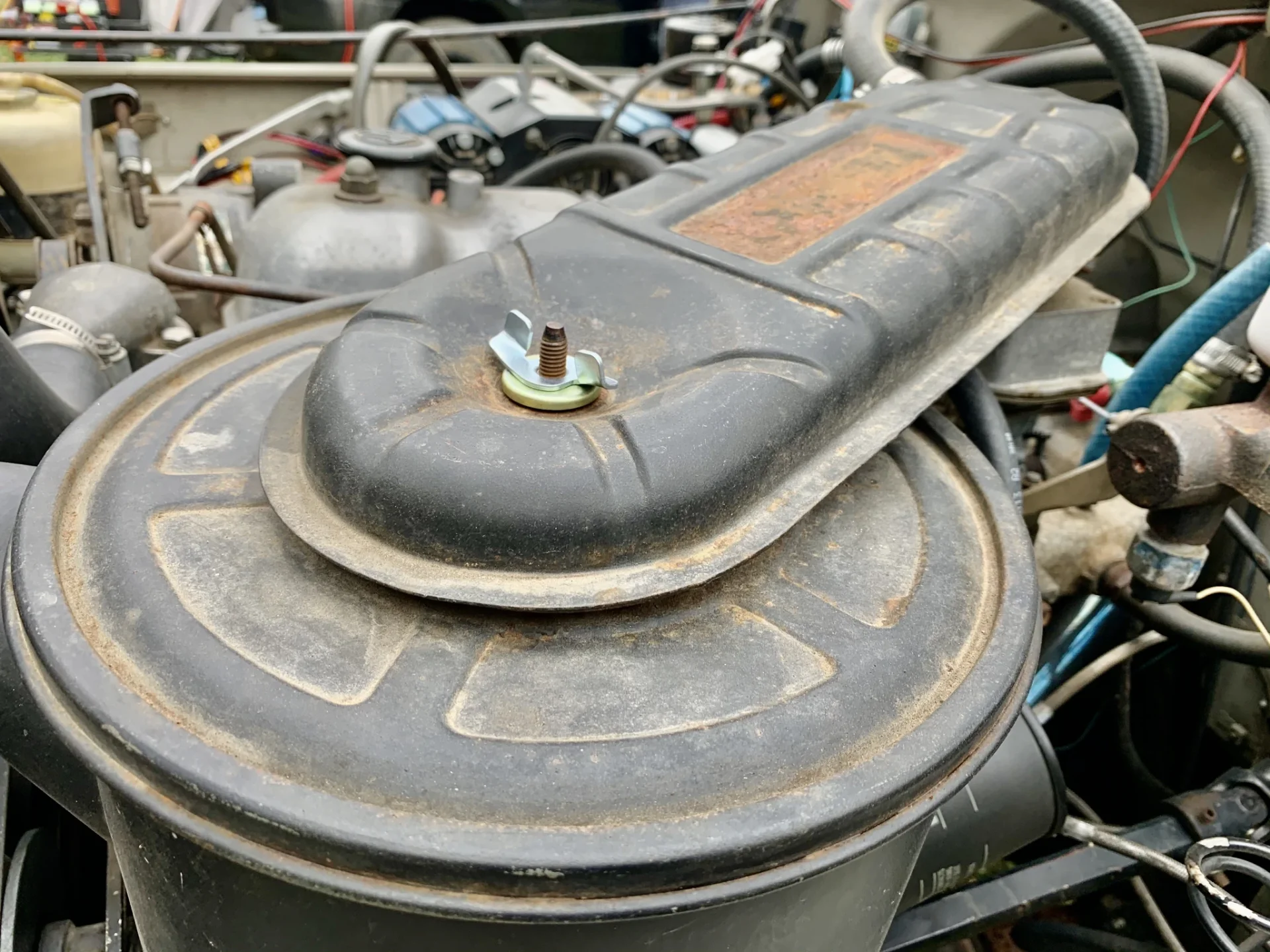

Correct, 64 is when the air cleaner changed to the one pictured. Generator was replaced by an alternator. Destin's 64's restore thread believe had this information. For the most pair US market had an oil bath air cleaner up thru 67. Then was a dry paper element after that. The FJ25s I've owned with the original engine had the early 40 style minus the tube for valve cover vent. The two 1961 production FJ40s I have both have the vent tube which is part of the PCV system. Seems first few years of the FJ40 both PCV and non PCV were used. If you have a vent tube on your valve cover will determine which air cleaner you need.
Cool! I wondered when the transition was for the ribbed vs smooth air cleaner top. :)
Anyone know what the correct air cleaner was in 1962? I have this:View attachment 2731749
And also another that took a hit at some point. View attachment 2731750

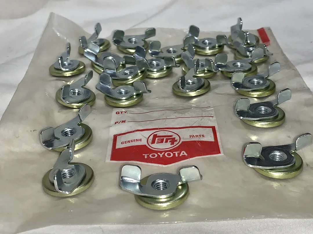

Kieth ,
I mailed you out one of my NON-USA larger size Spec . Updated Air Box wing nut grommet seals combo nuts
you need one , like we talked about
in mail today
thanks

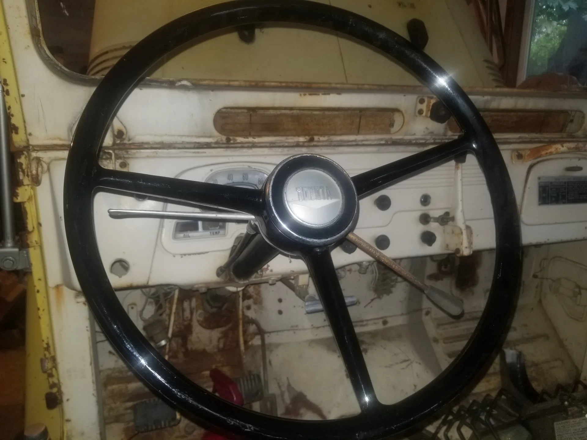

Hats off to @Birdhead for this restored steering wheel. The horn button is original to the truck AFAIK. I could not, for the life of me remove the old one buy hand, but a puller popped it right off. I haven't actually assembled the mysterous horn bits inside yet, but they seem to all be there.
Thank you
