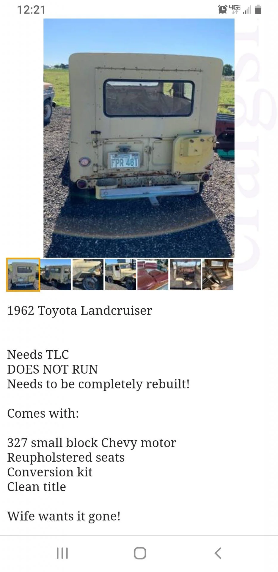

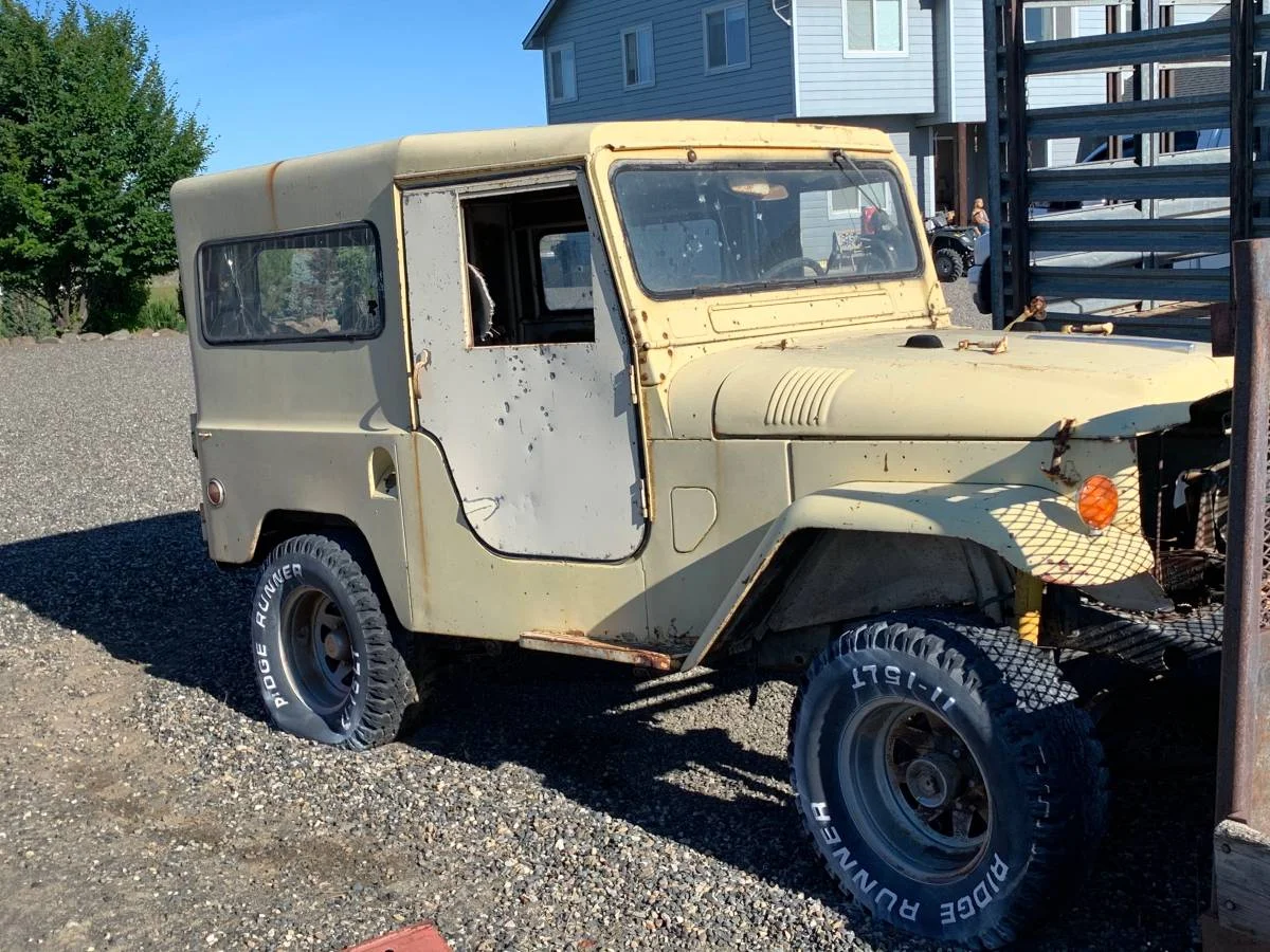

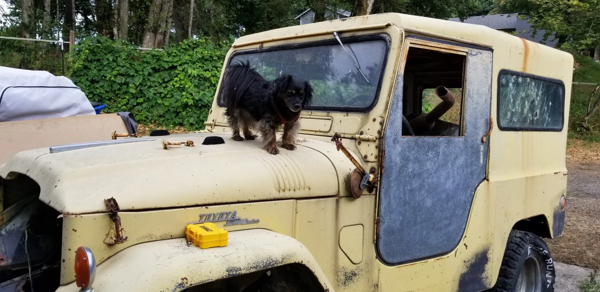

@Ocho77 posted about this Craig's list ad in my home state. I figured it had gotten snapped up. The phone was never answered. Text responses, extremely slow.
Buyer would not take a deposit, they didn't like PayPal. Her Craigslist pics.

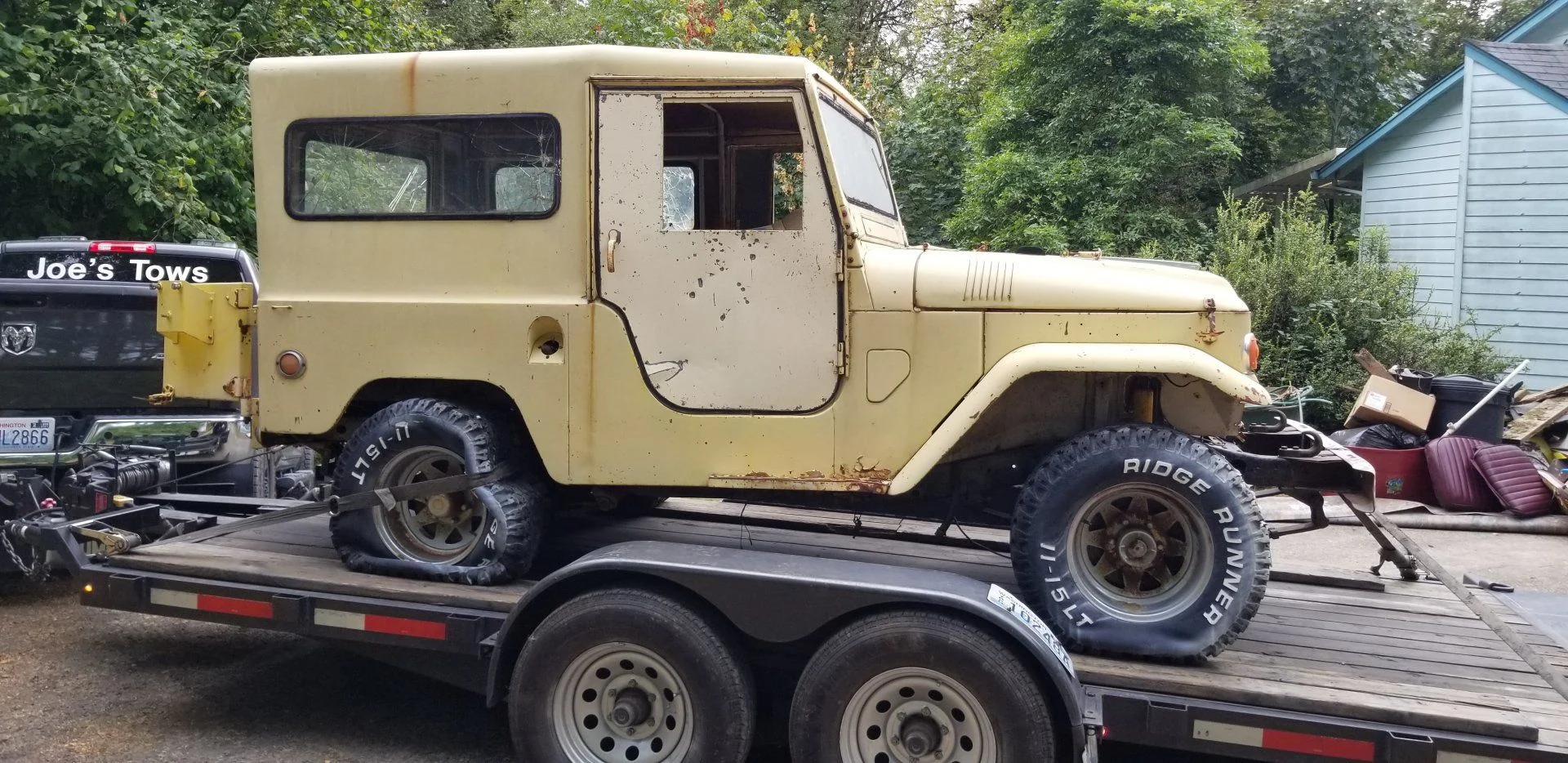

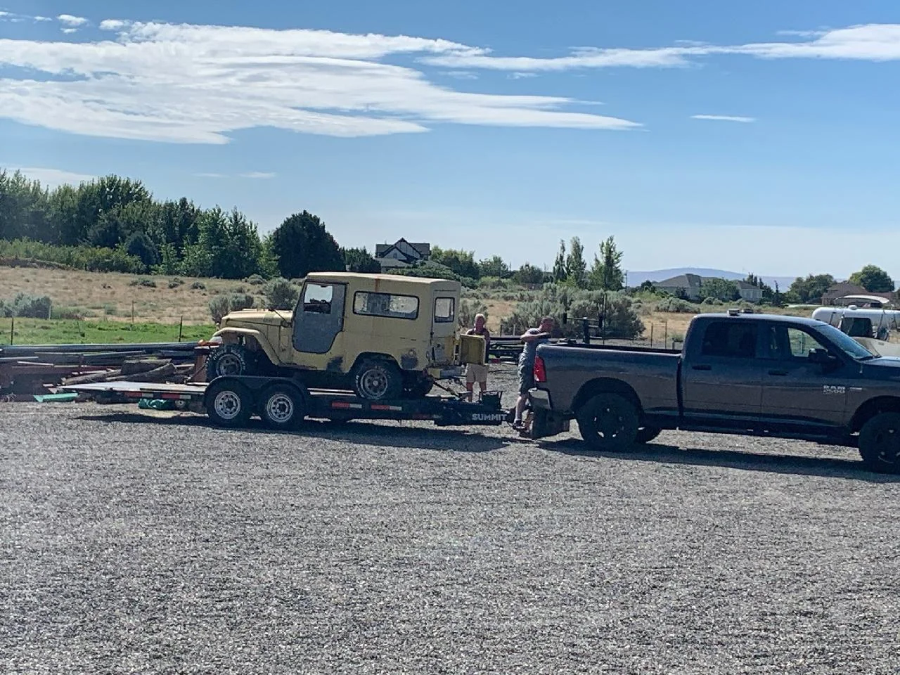

Was it worth the trouble? Oh yeah. Here she is leaving the desert.
Meet Bonnie, actually in my driveway. It was not easy getting her here.
Joe's Tows in Pasco was great. Their motto: We don't want an arm and a leg, just your tows." A dad worthy pun.
The plan? Possibly my first frame off restoration. Thankfully I won't be begging for many of the usual parts, but I do need a motor. And I'm going to have lots of stupid questions.

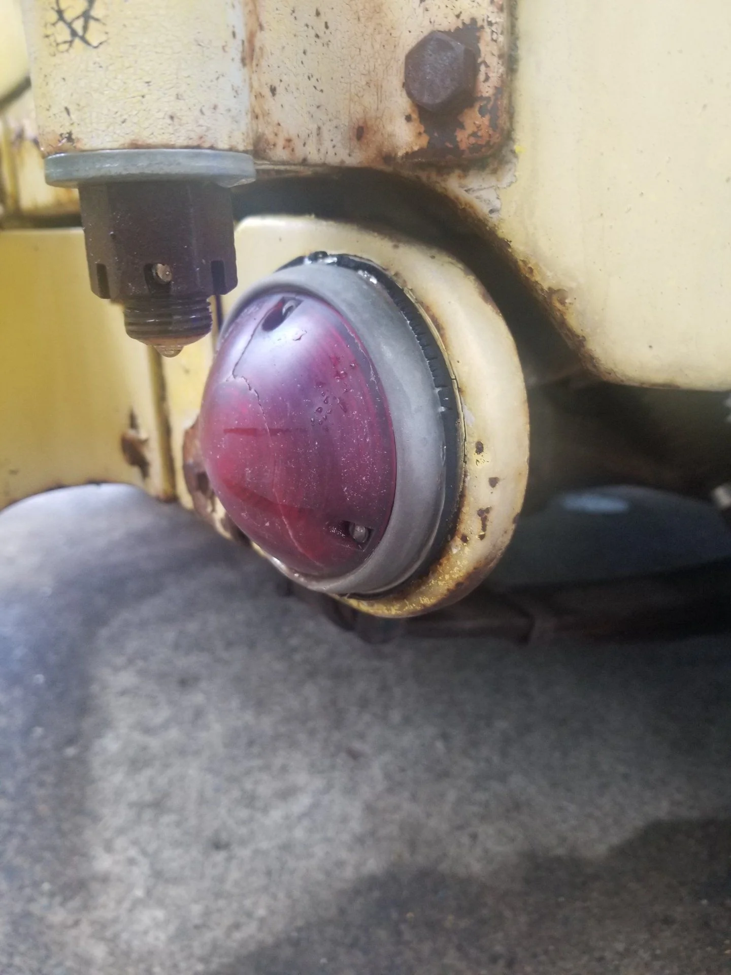

Think I'll need some lenses like this. Smaller than my '64.

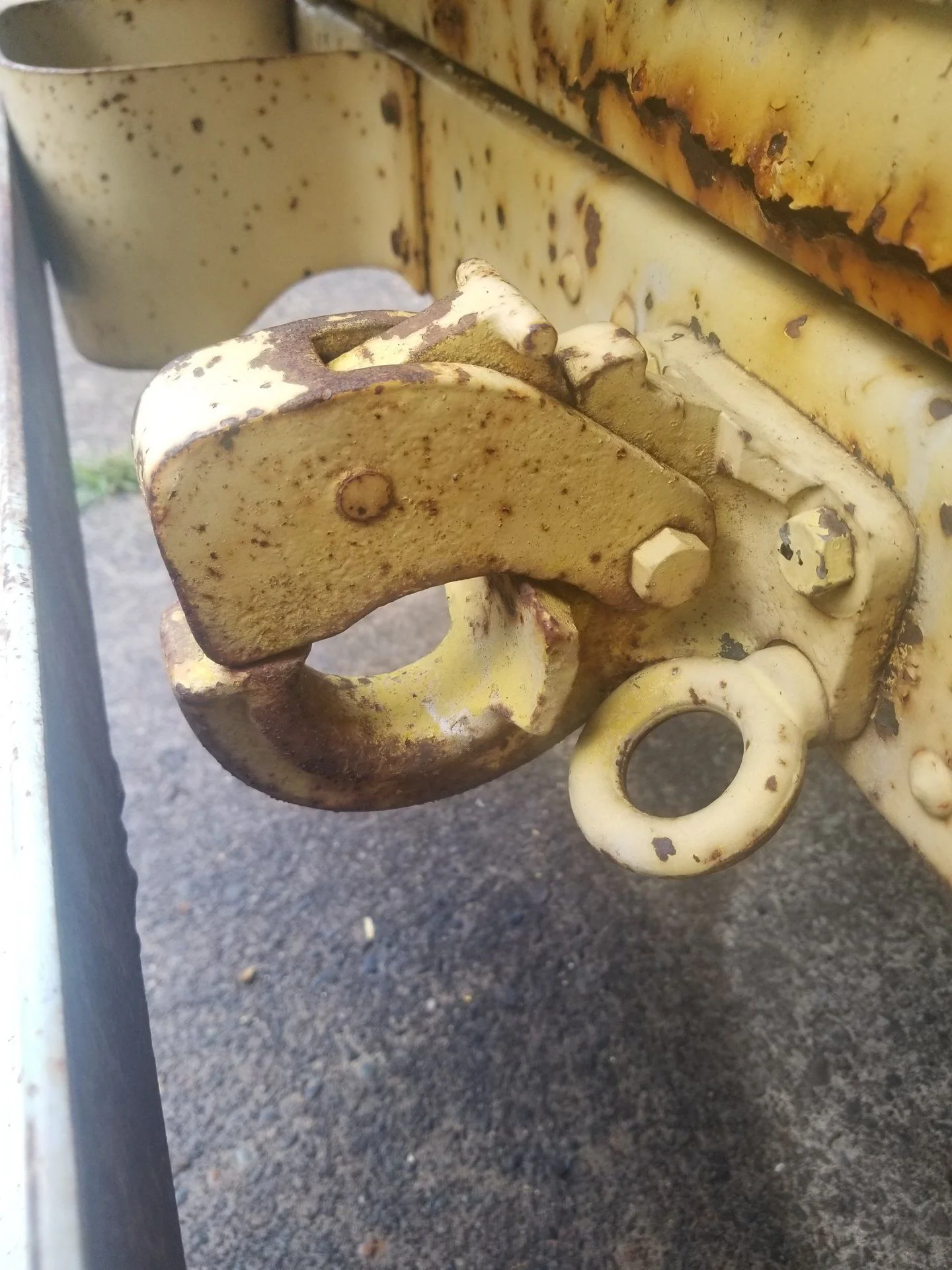

And a pintle hitch, no unwelding required Arne.

Nice hitch socket and pintle! Always amazes me the bits that survive on some of these trucks vs the ones that don't.

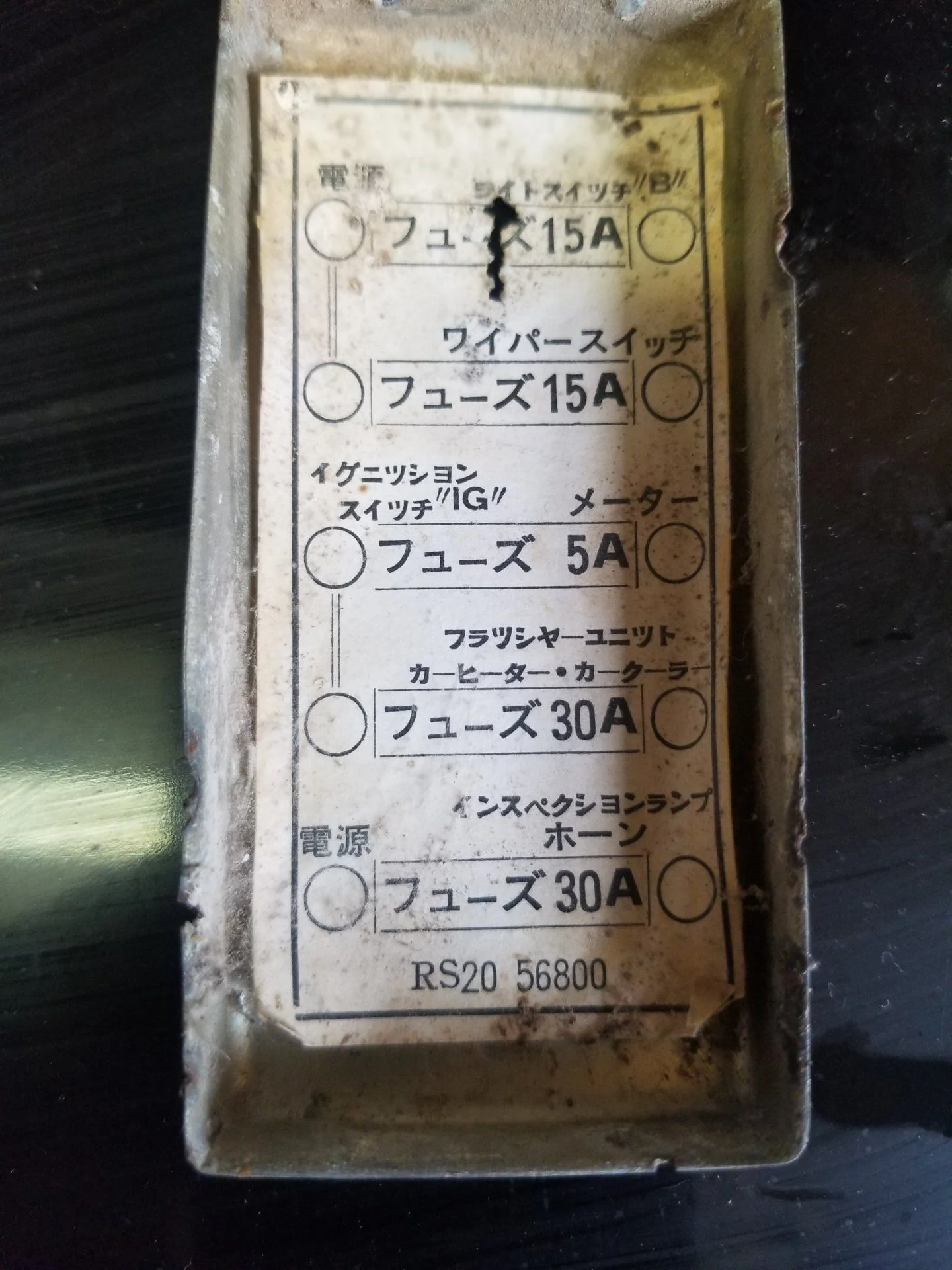

I only know a little Japanese, but now I know which fuses to use:

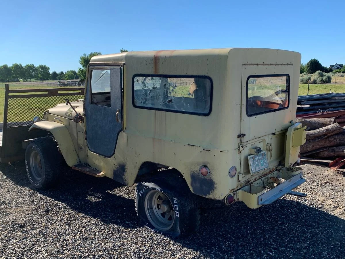

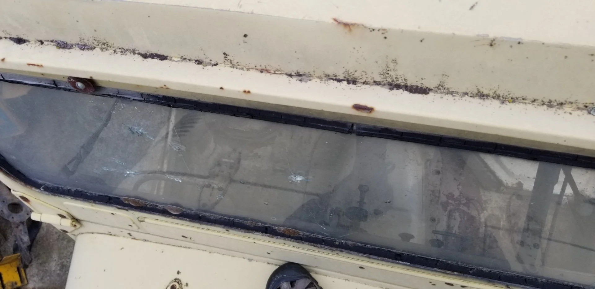

And how was the top attached? Securely. Welds, rivits and lotsa bondo.
@whitey45 the torch worked well to clear bondo so I could see what was PO and what was Mr. T.
Here is the windshield attachment. The channels are intact and should be salvageable.

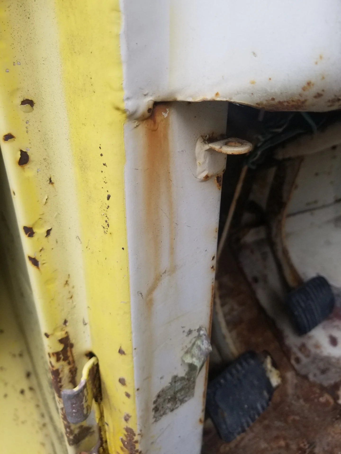

What does this little tab do?

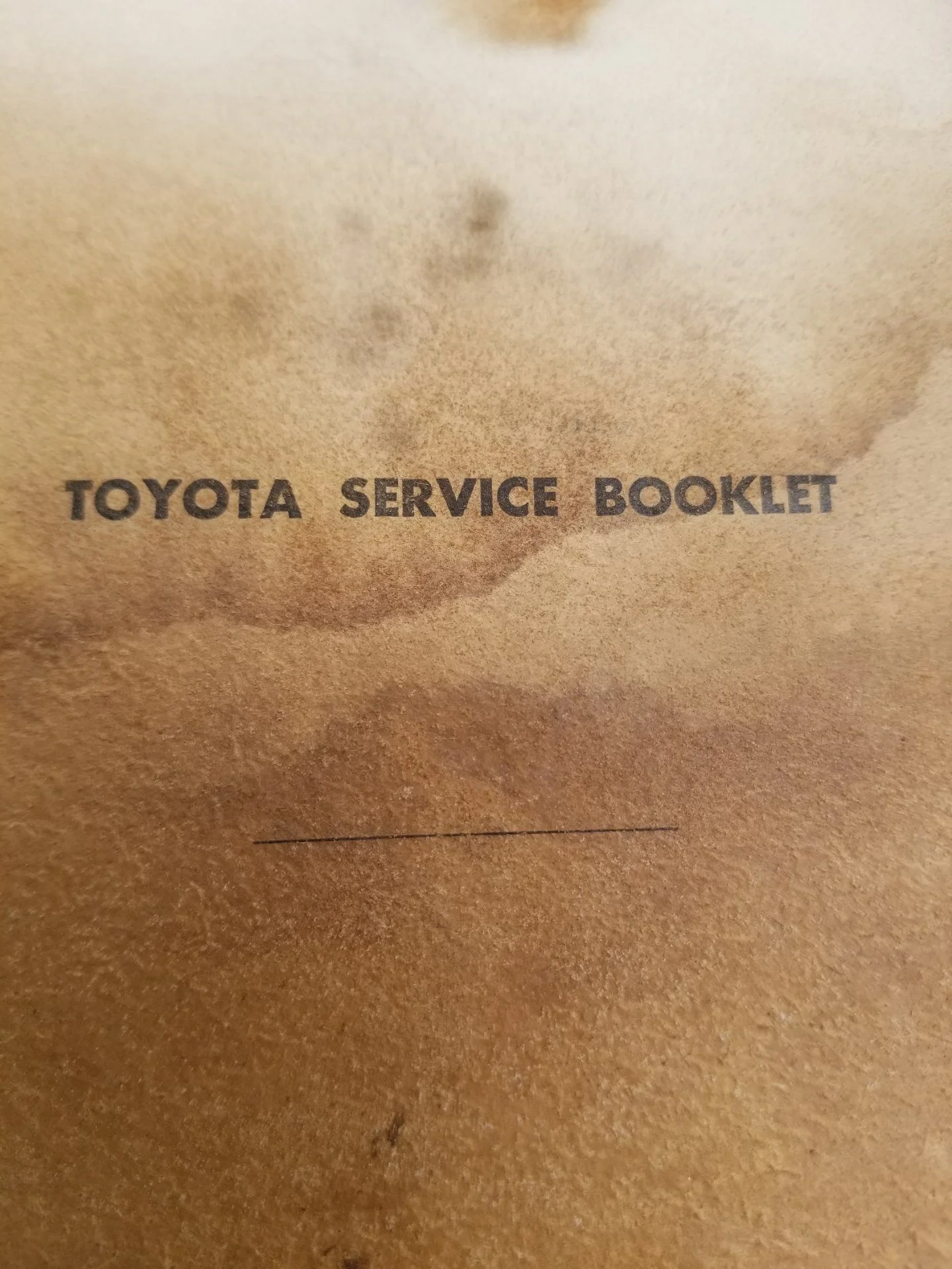

In trying to date this vehicle, I see it's service booklet number is a bit earlier than the one in the picture posted by @nuclearlemon for Annie.
trailer socket. annie had one too. there's a little chain that runs from the door to the tab under your dash. it had a vinyl cover like the tailgate chains. i had my service booklet too. check out my "little orphan annie thread"...she was an original 62 softy also, so you may find useful info.

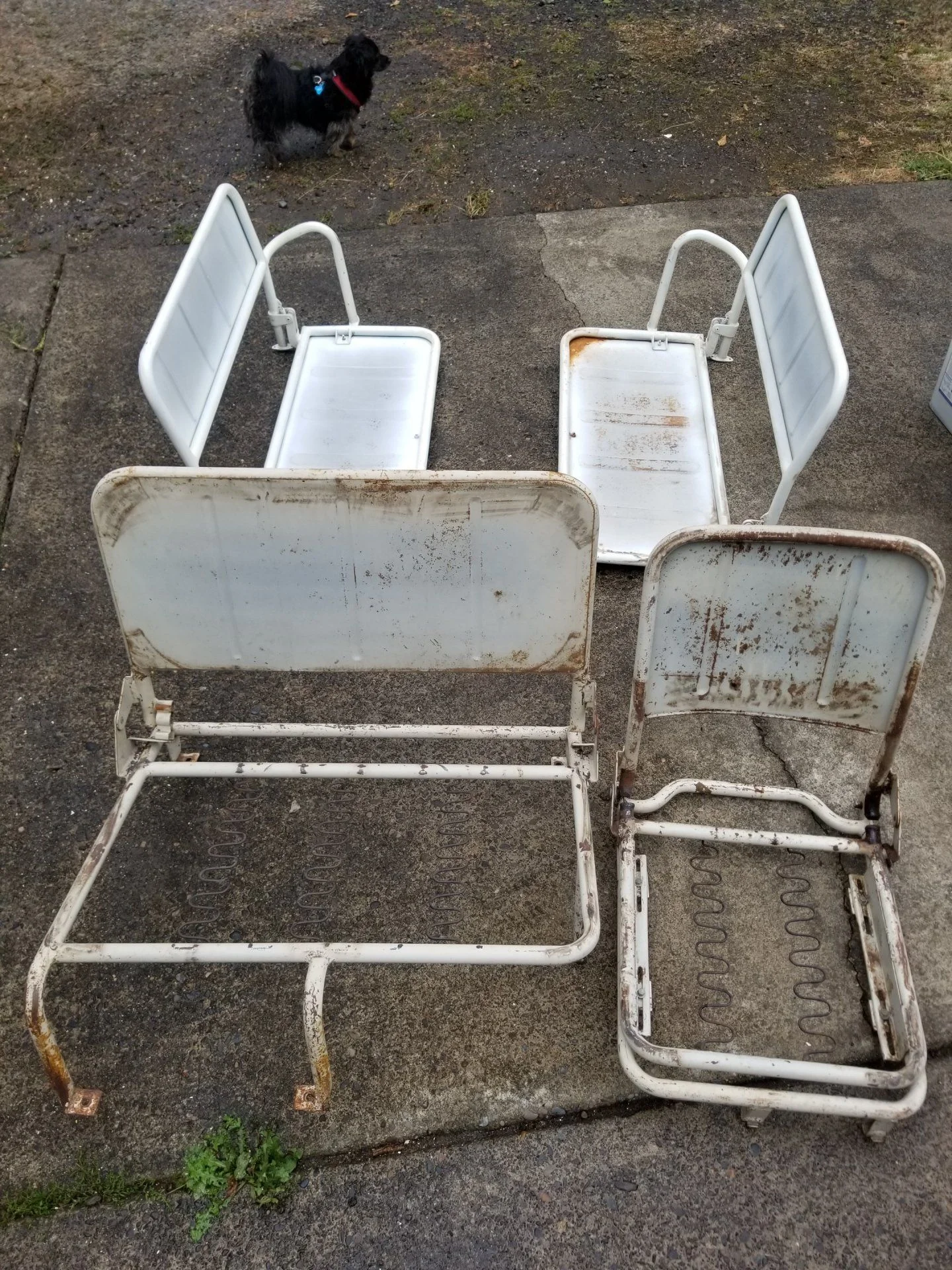

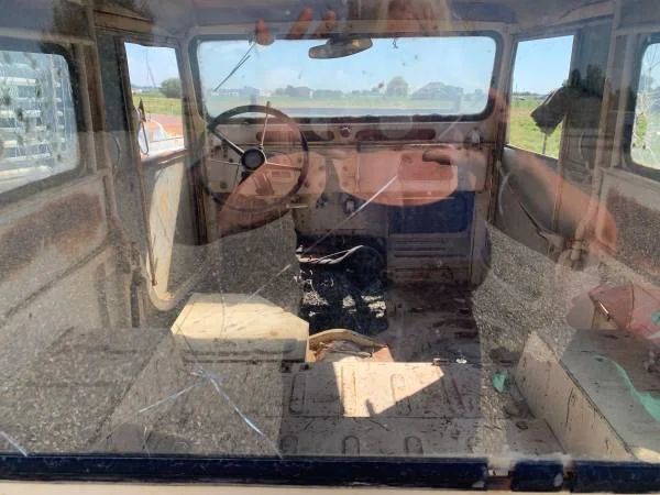

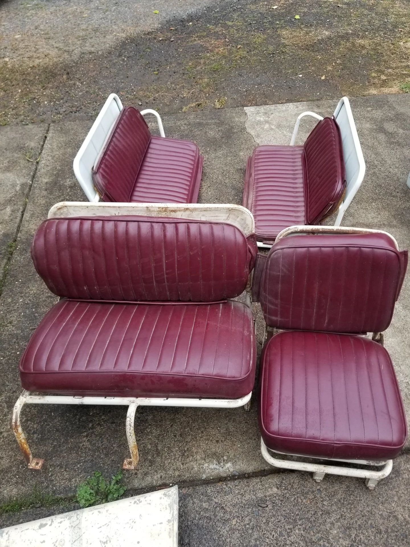

@middlecalf, seat frames, and upholstery. The seller said he had them reupholstered, and I think that person used the original stuffing.

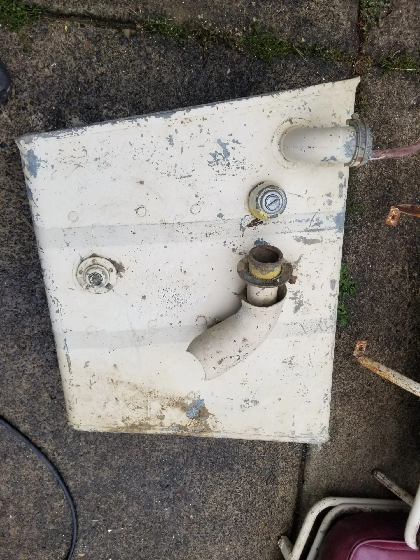

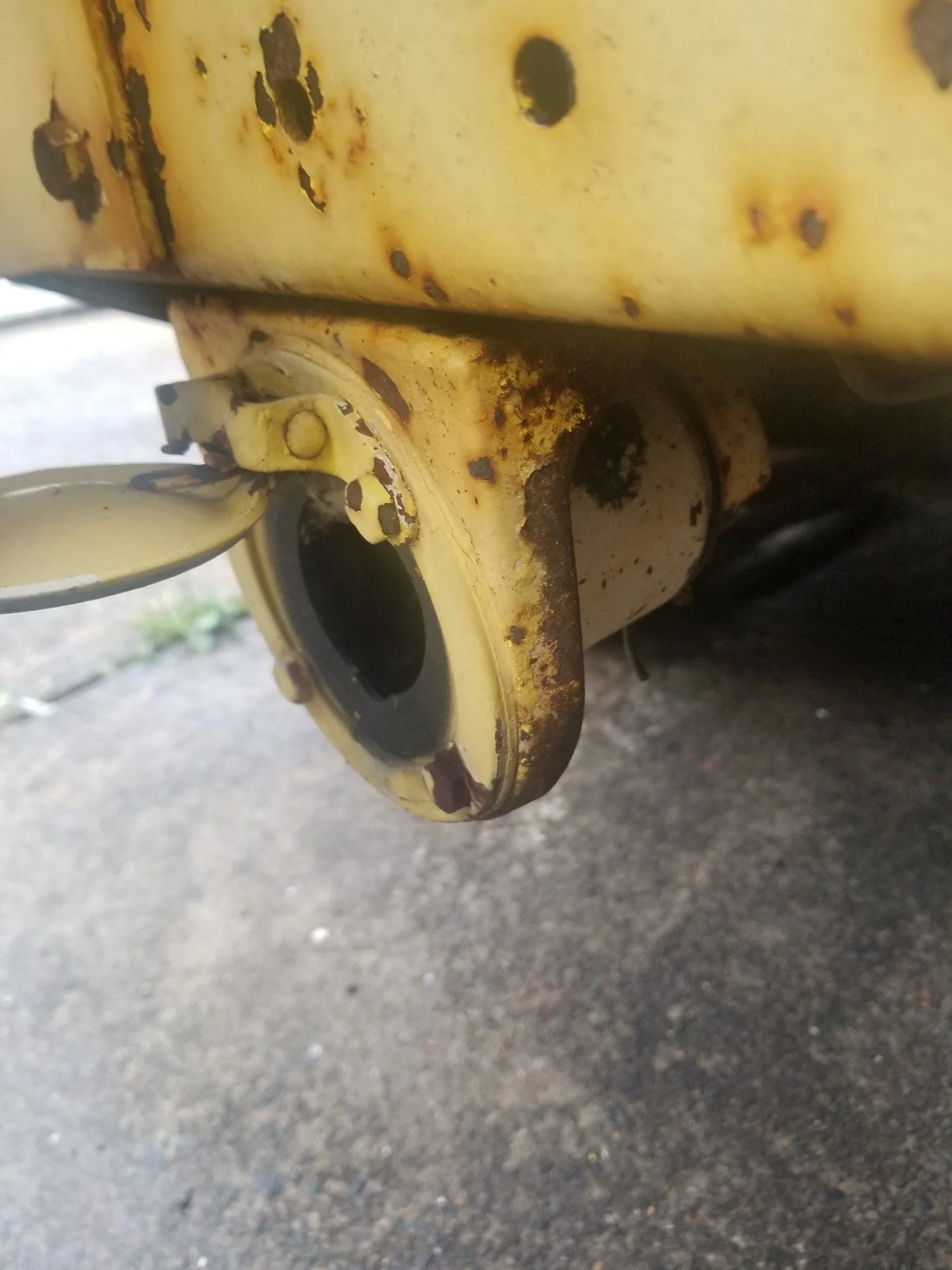

The gas tank, and the small cover locking gas cap.
No key, the inhumanity of it all!
Those seats are awesome. Jealous of the originality! I’ve a bunch of questions on their stuffings and substructure after you get down the road a bit with your fun discovery. Lots of original stuff!
@middlecalf, seat frames, and upholstery. The seller said a he had them reupholstered, and I think that person used the original stuffing.
you'll be happier with the original seat padding vs newer foam crap.
as for the mia key...easy enough for a locksmith to duplicate. had to do the same with annie
