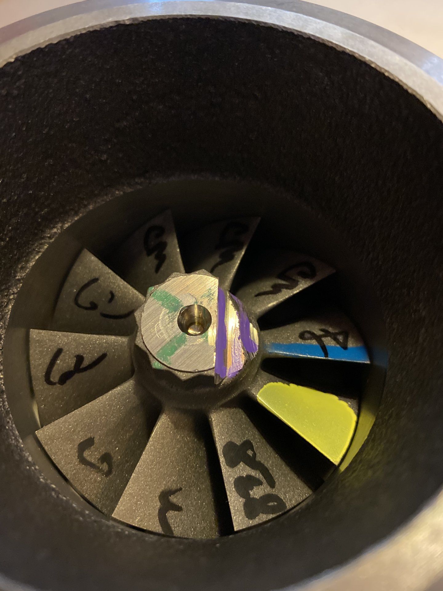

So my turbo is here and next up is finding the time to start on it. Quick question though about the turbo itself. I assume it’s fine or Borg wouldn’t have sent it out but this seems like an awful lot of material having been shaved off to get the fan balanced. Thoughts?
That is not a bolt head or anything, it is simply a pad to balance the shaft. The turbine and the shaft are all one piece.
Thanks!
I might post another pic when I get home just to show how deep those two purple cuts are. This pic doesn’t do them justice.
Nope not structural at all, it is there to grind off and balance the assembly. The only reason it looks like a fastener is so you can hold it steady while you tighten the nut on the other side of the shaft that holds on the compressor wheel.
Ah, okay. So it’s not really structural or anything. Very good to know, thanks again!
I did my Mechanical Engineering internship at Garrett (Allied Signal at the time) back in the early 90's. Part of my job was to verify balance on all of the turbine/shaft assemblies for the prototype units prior to assembly and then balancing of the rotating assembly after assembly. The drive feature on the hub is used to hold the turbine/shaft assembly during several stages of the manufacturing process. After that, it is just sacrificial material for balancing the rotating assembly. They get cut on twice, once for the turbine shaft assembly balancing, and then again for the rotating assembly in the center housing with the bearings and compressor wheel. I saw some with far more material taken off than that. Not an issue.
