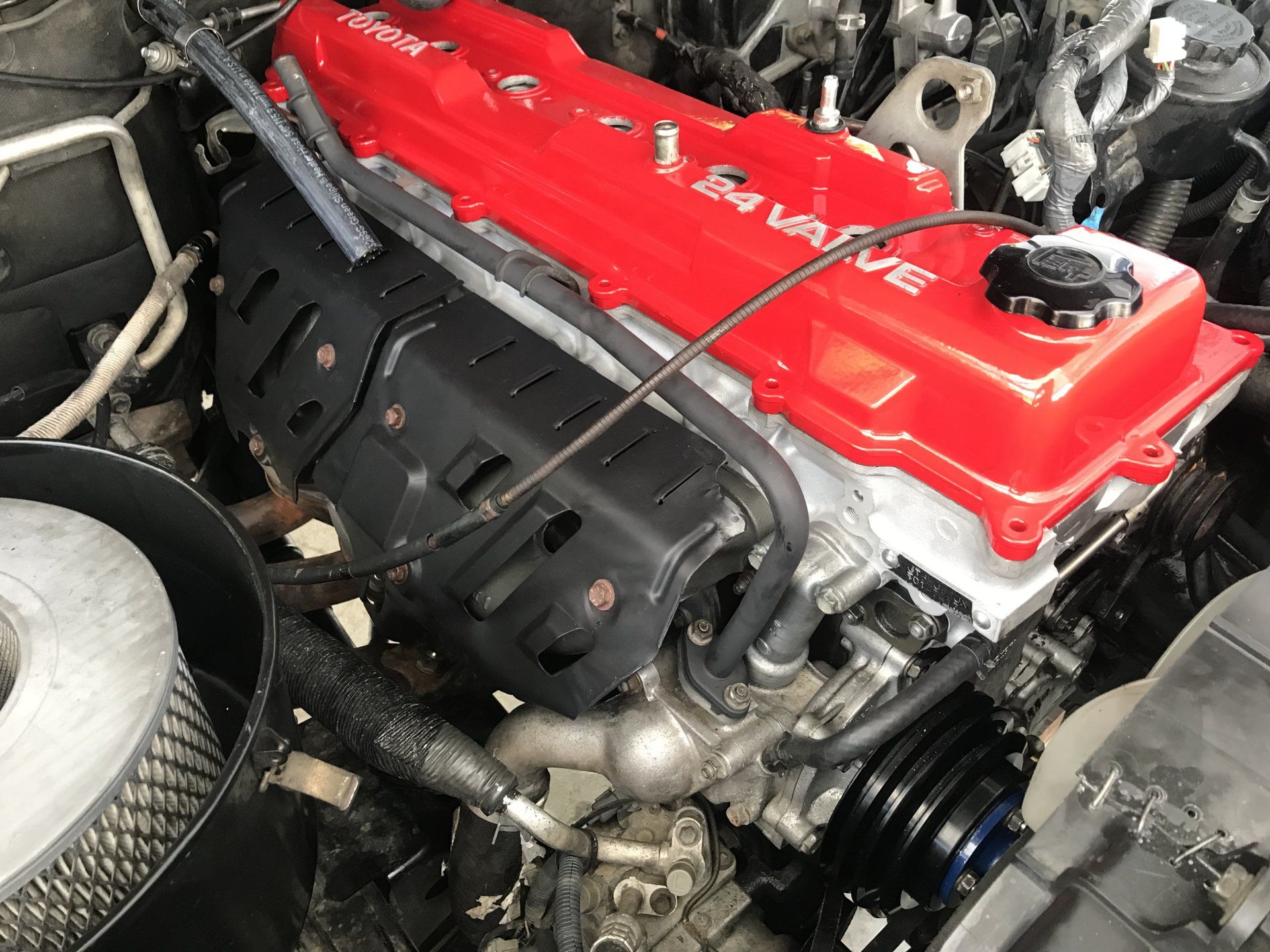

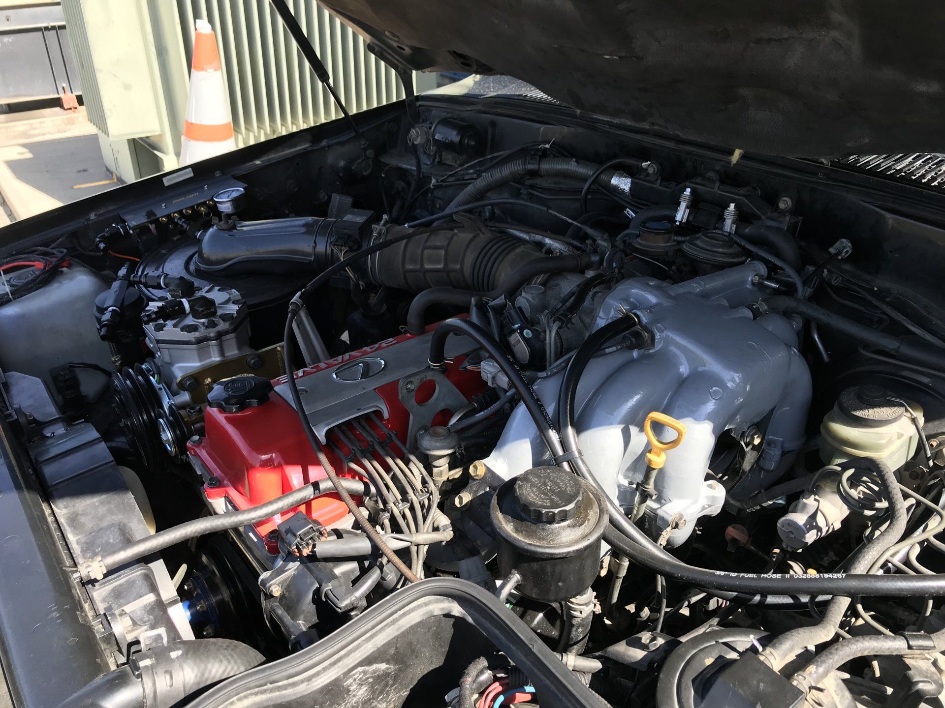

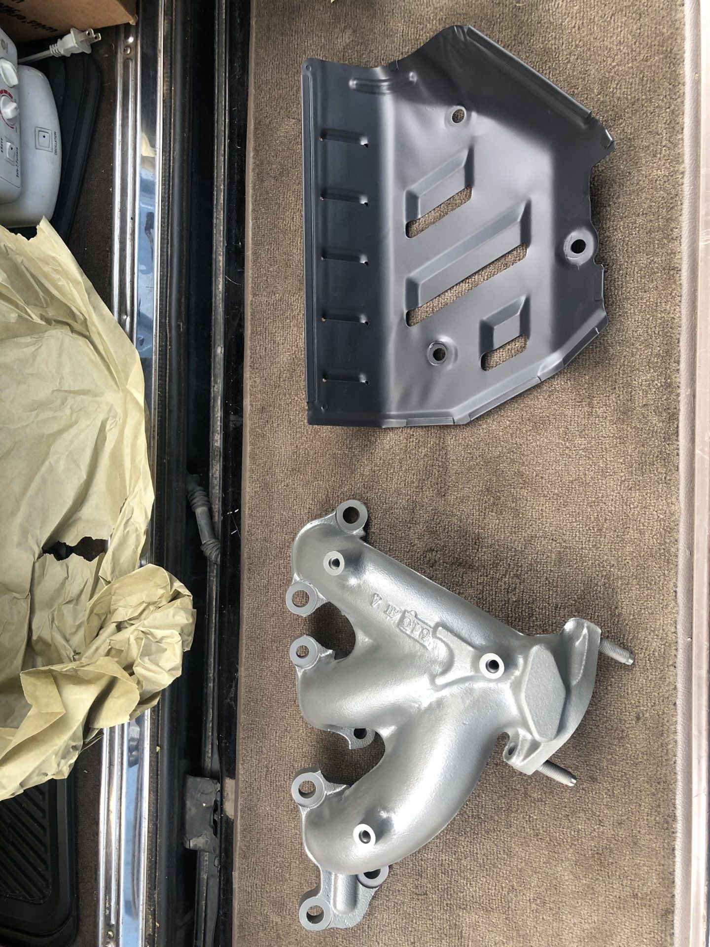

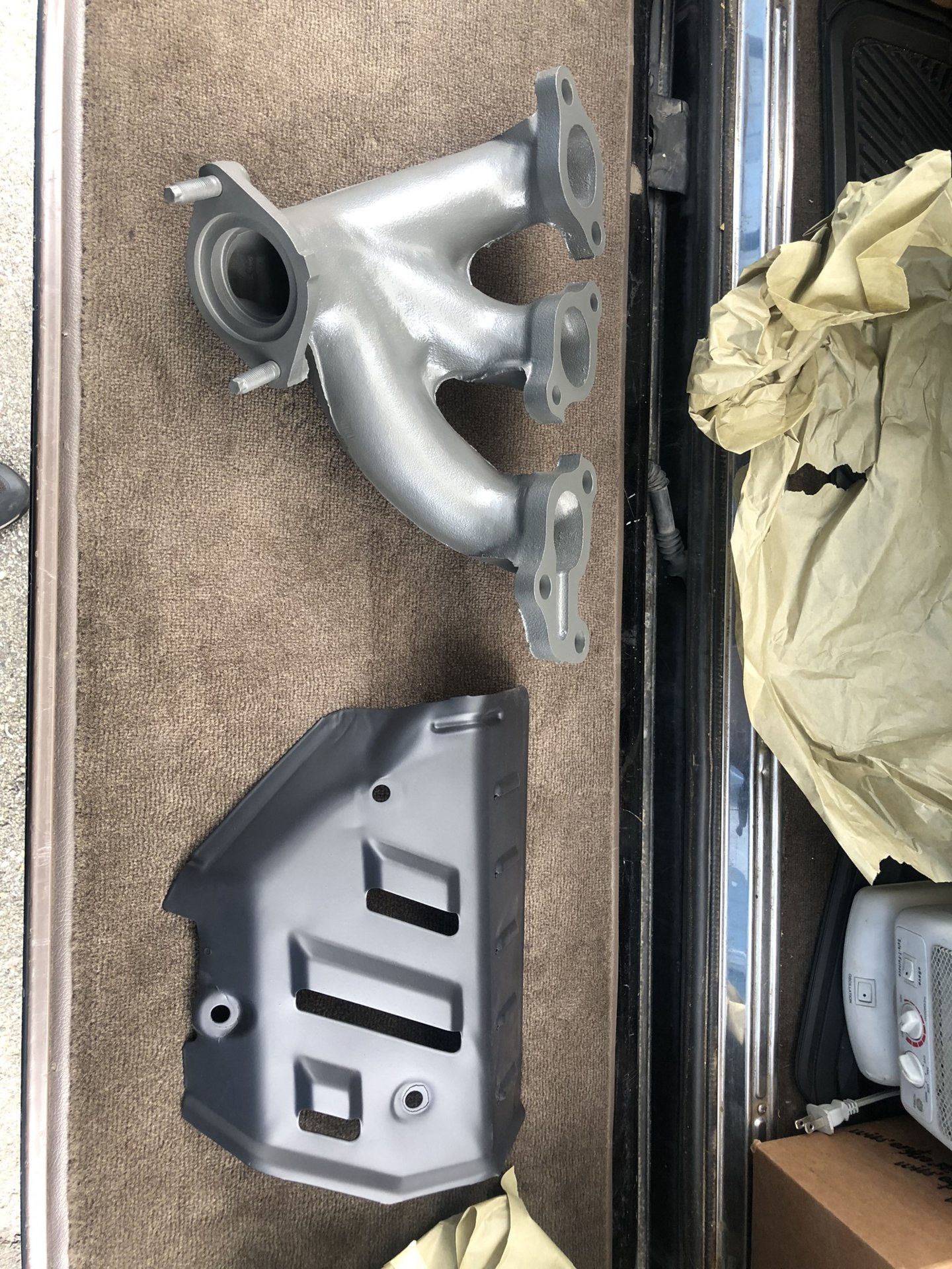

I ceramic coated my exhaust manifolds & heat shields. They look really nice.
So nice, that I powder coated my valve cover & intake manifold too. 😍
