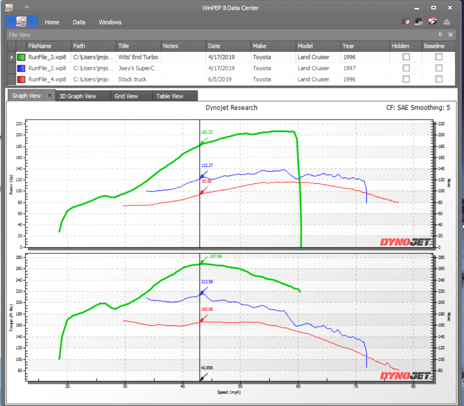

Stock 120AWHP 170FT LBS
Supercharger 155AWHP 238FT LBS
turbo 214 AWHP 277 FT LBS
Well I finally bit the bullet and got a WinBlows machine JUST so that I can use the Dyno software. Ugh
I still have lots of things to figure out with it but I pulled together a comparison graph of the three trucks. Although these are not the best numbers-wise, they are the best looking as far as a graph. I'm ok with the numbers overall be a touch lower. I have yet to dyno the new turbo truck anyway.
Out of curiosity what altitude was the non FI /Run4 run at? Looks like stock HP is in the 115 range....imagine folks at altitude are closer to like 85/90hp. So the turbo essentially doubles the power. :D Thats sure to put a grin on some faces!
