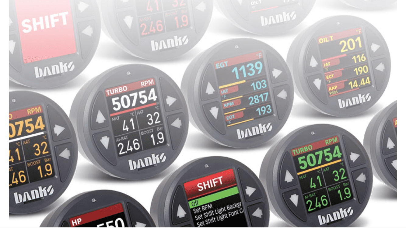

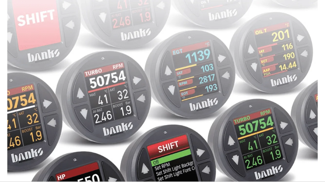

This looks like a cool compact customizable widget of a guage.
This gauge was talked about, maybe in this post, maybe somewhere else, it is a nice setup for post 2010 cars/trucks that come turbo from the factory but isn't ideal for our truck, because the information it pulls from OBDII will have nothing to do with the turbo.
This looks like a cool compact customizable widget of a guage. View attachment 1938840
