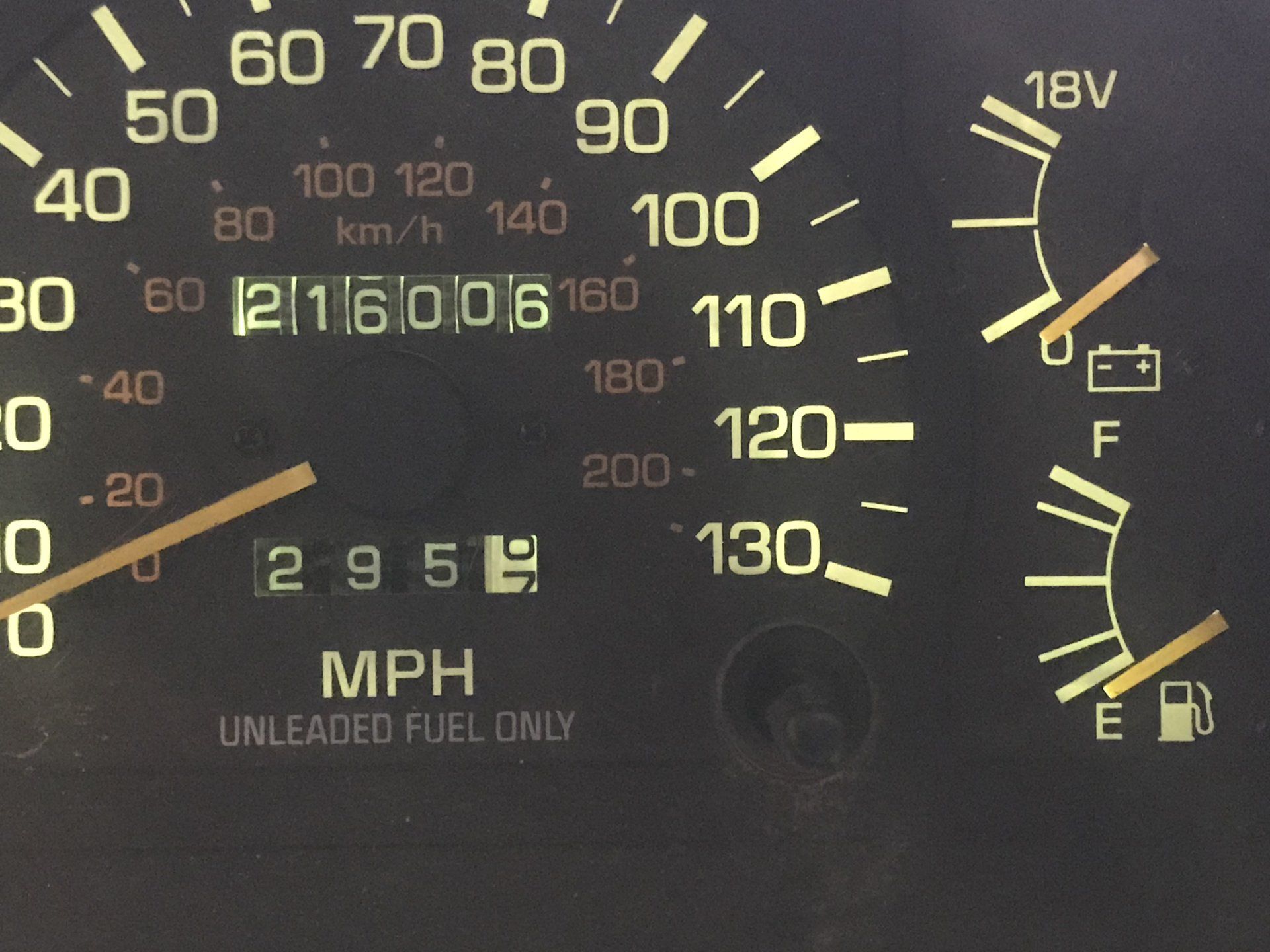

I could have easily hit 300 but next gas station is 52 miles away. The light just started glowing. I have never seen an 80 hit 300 miles on a tank. My own SC’d 80 gets 220 on a good day and I’m stocked to get that! 😳
Last fill up on this truck on the way out to Flagstaff was 270 with a bright fuel light. I really pushed it. Dylan can attest to his previous fill ups.
Oddly enough, only 18 gallons went in just now. So that means 16.44 MPG. 🤔
View attachment 1940823View attachment 1940824
$84 bucks for 18 gallons?! where was that so I don't go there...
everyone needs to understand that even a bone stock 80 has error in the speedometer. Slap on some 285/75R16" tires and the error increases. So posting your numbers here is a garbage in garbage out scenario unless you have a calibrated speedo.
I will caveat all mpg claims in the future with appropriate math equations. As an engineer, I'd like to think I can grasp the basic concepts to properly determine mpg. If you'd like to check my mileage, Google the distance from Colorado Springs to Avon, Colorado and multiply by two for the roundtrip that started with a full tank and ended with the light on.
Haha not sure how we ended up in a “calibrated instrument” measuring contest but I think it’s fairly safe to say with 1 fill up nothing can actually be said about mileage.
But if you have a vehicle that has never achieved 300 miles before the light comes on and after a change it consistently does it’s ok to say that there is an improvement. No instruments required.
That being said I do not think we are at that point with this setup. And I will put money on the fact for 90% of drivers there will not be an increase.
