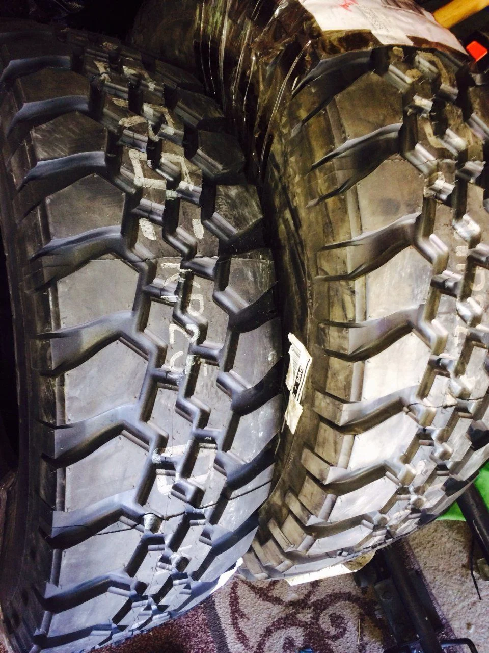

Next one is good year mt tires non directional radial tire Very good tire on any condition performs awesome , downside is. Side wall is not strong .
Goodyear MTR is awesome. In every way
And last BFG. Looks perfect and is the best one so far I have used
Any one of those tires can be found easily brand new surplus around 800 a set or less
