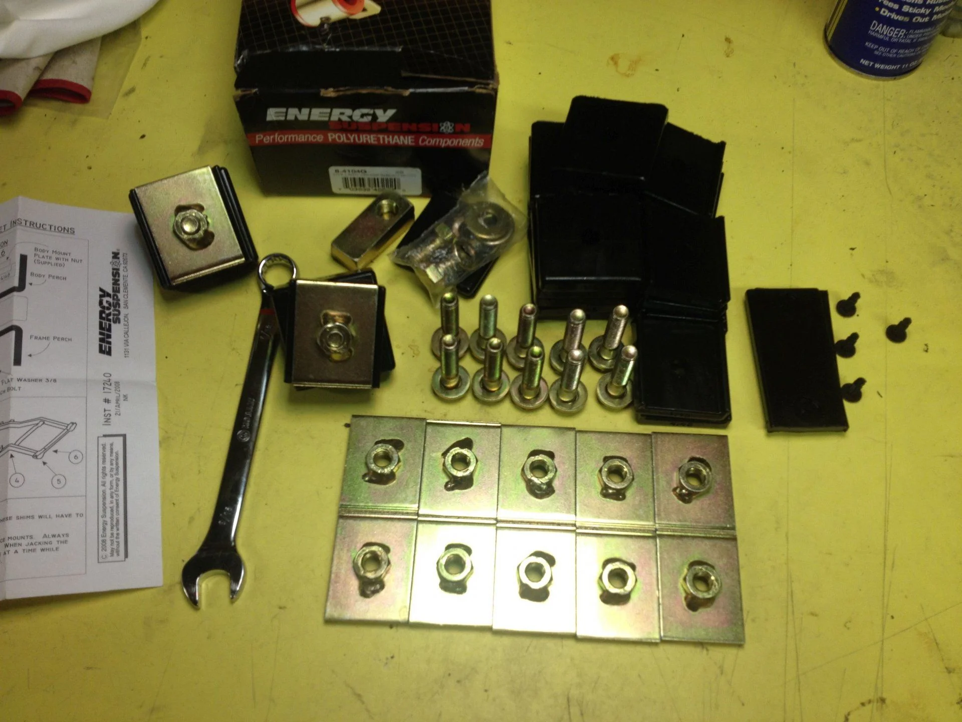

FWIW - I used the Energy Suspension on mine, and would use it again.
Did mine two weeks ago with energy suspension, the whole project went well. don't forget to soak your bolts down with some pb blaster.

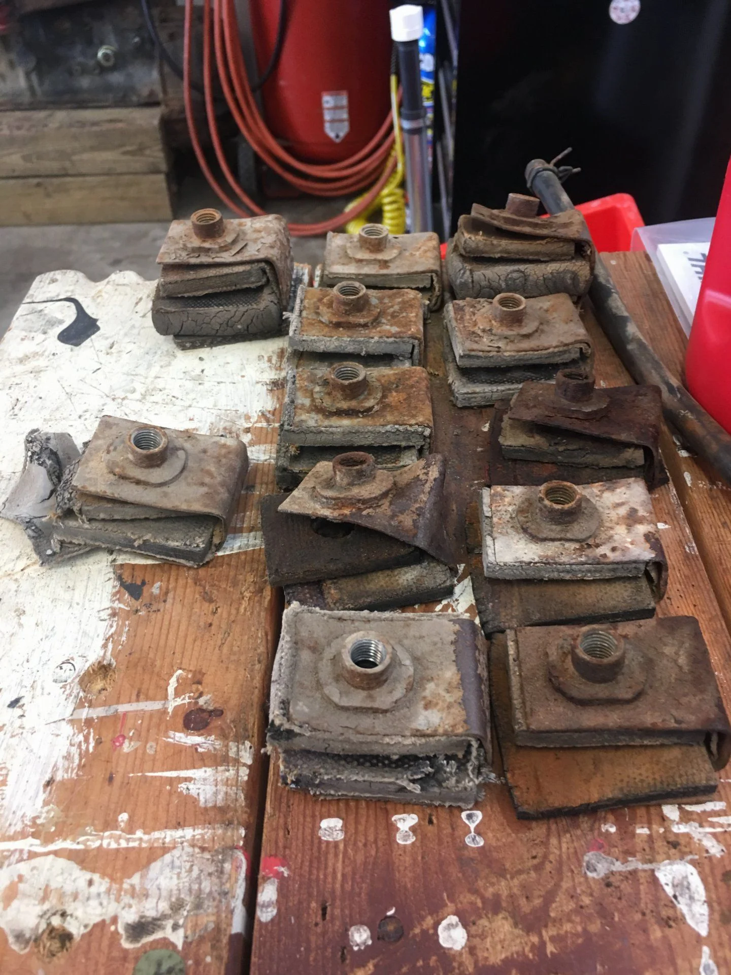

Daystar kit is installed. Other than it being time consuming, I'm happy with the kit. They are one piece mounts just like the OEM ones. Lift up the body a little, slide the old out, slide the new in, put in a new bolt, and move to the next. My original ones were due to be changed.
