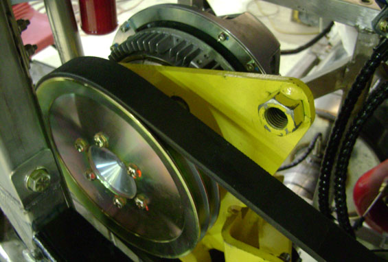

Phil, I know Tools has talked about measuring the fully open & fully closed temps using a heat gun, rather than than LT's half-open, water bath method. Which one are you talking about?
Heat gun to emulate the air coming off the radiator at the same distance. A Fluke meter with a thermo coupler on the spring.
Set at 95° opening here in AZ it would be open before you even started the engine.:eek:
Yes but that would be the first stage where there is very little shearing surface for the fluid. Unlike the black clutch were this area is very dense with shearing surface.
It has been mentioned that the black hub clutches flow more air during an idle state which would indicate that advancing the blue's timing shouldn't be an issue.
I heat soaked two new clutches last week and can tell you that the timing was substantially lower than your 125* setting.
