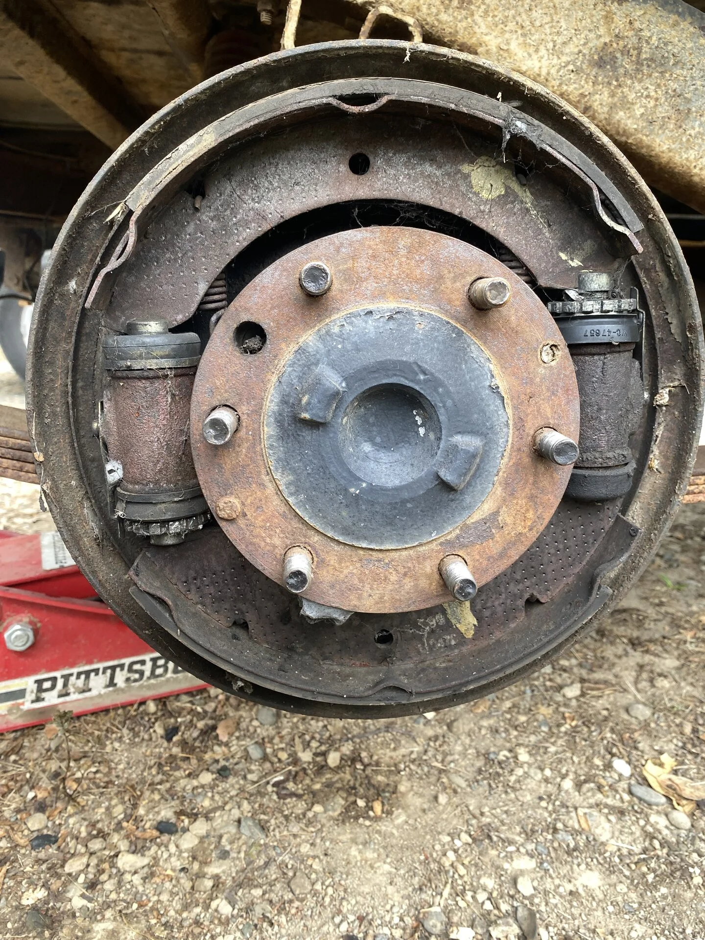

Took off the drums, not near as bad as I thought I’d find. Adjusted the shoes to drag, gravity bled again. Feels slightly better.

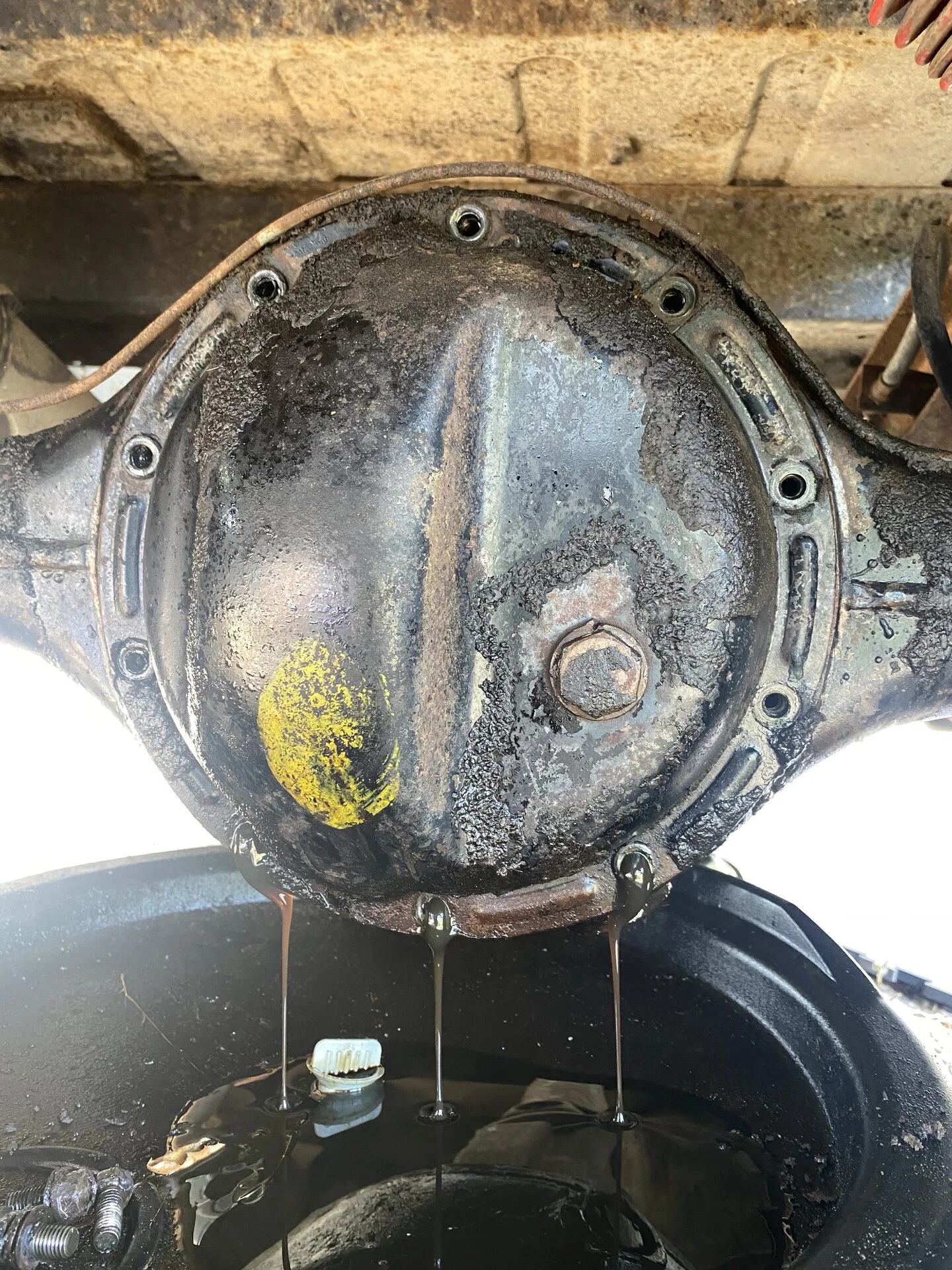

Then I dove into changing the rear diff oil. I was just glad there was some to change lol.

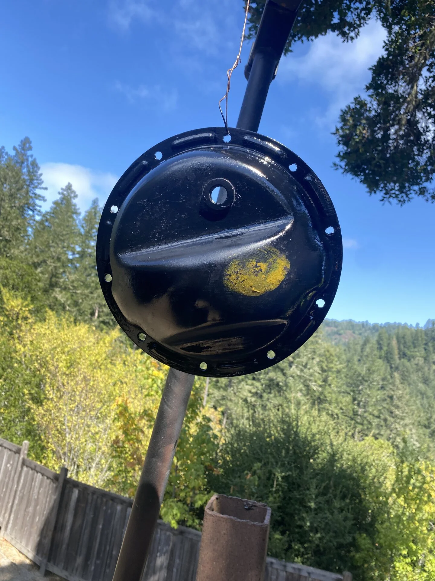

Painted the cover, I hope to reassemble and test drive today but may run out of time.

I adjust the drums until the drum won’t turn, bleed then adjust them to proper spec.
