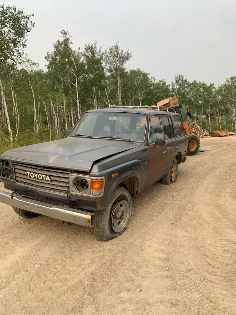

This starts back is 2018/2019 when a customer reached out to my dad for help selling a LandCruiser.
My Dad( @simonliew ) works on alot of LandCruiser at his shop and was helping a long time customer sell their fj60. Their 60 got rented to a movie before being sold to ontario or quebec. Once it sold she said we should come take the parts truck away at no cost. She didn't want the parts to go to waste.
The "parts truck" turn out to be a 1985 5 speed BJ60 with 625000KM.
It had been sitting in their yard under some oak trees for years(probably 10+). On our first look over it it was missing a battery cable,a headlight, and had mismatched doors. other than that it was just rust on the rockers, rear quarters, rear sill land lower tailgate. Everything from there up looked pretty good, including the roof! Looking inside, there were some random parts and brand new replacement steel panels for the rockers, rear wheel wells, and rear quarter panels We also found a brand new in box dash cover.
My dad asked a friend if we could store it on their property. it sat there for another 3ish years. a couple months ago My dad and I picked it up so i could start working on it.
the 60 outside my dad shop.

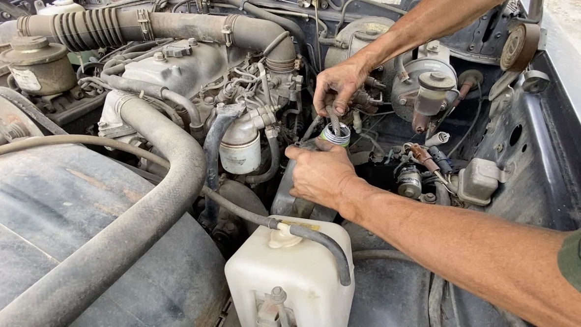

To get it running we plumed in a oil container full of diesel beside the injection pump, hooked up one battery(crossover battery cable was still missing), and started pumping the fuel primer before turning the key. It finaly started running but would keep dying. the EDIC motor kept rotation non stop so it would die if we kept giving it gas. We later found it was the ground from the engine block to the frame that was broken. I unhooked the edic Linkage and the engine started running fine! it doesnt smoke sounds good. Its hard to believe it has 625000 km on it. although we dont know it is was every swapped out since we dont know the history.
plumbing in the fuel

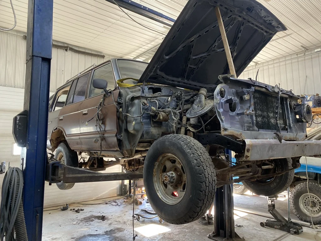

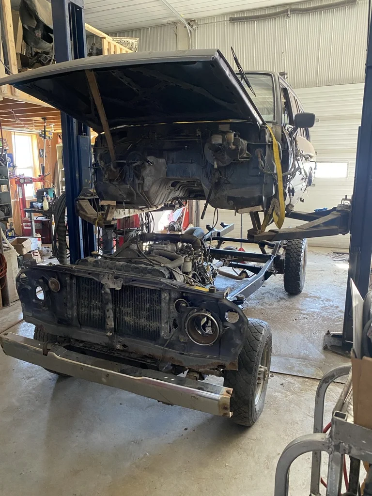

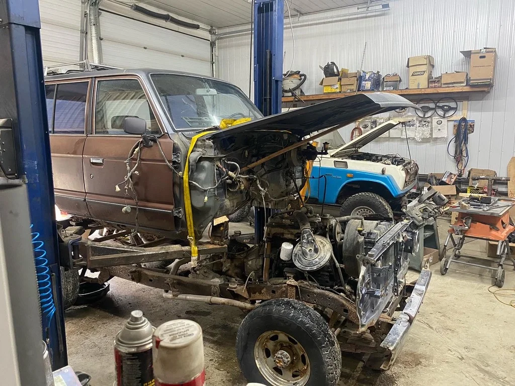

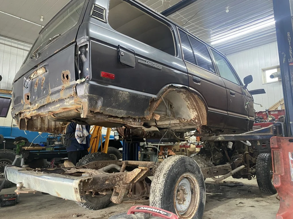

The next few day i really dug into it. My dad convinced me to to remove the body from the frame to fix the frame. he was right about that lol.
So I started unhooking everything underneath, removing the whole front clip, and unhooking the engine.

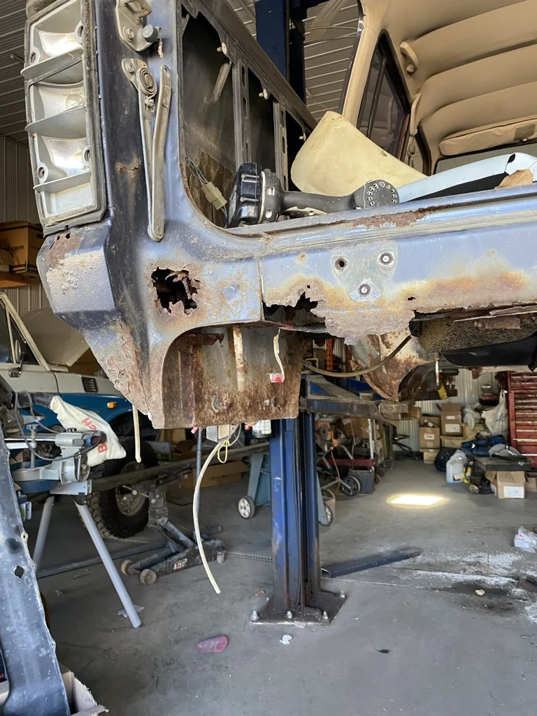

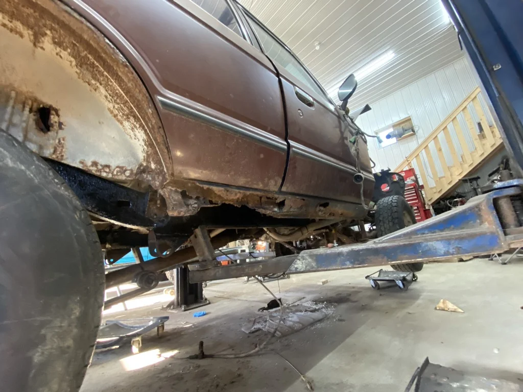

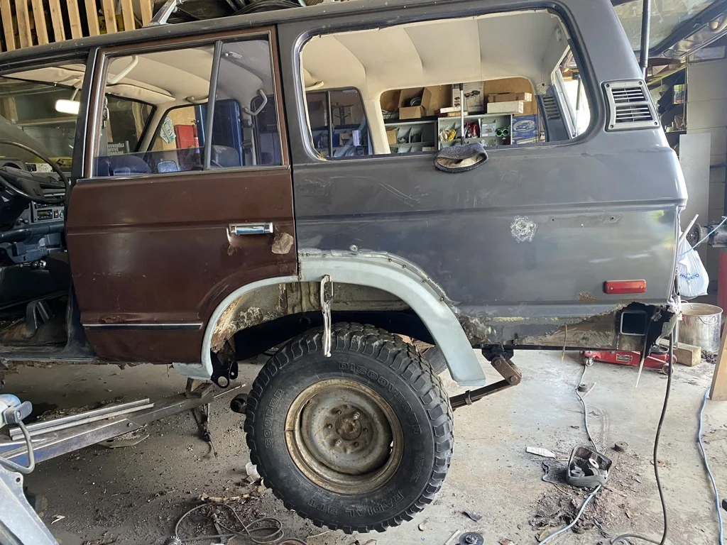

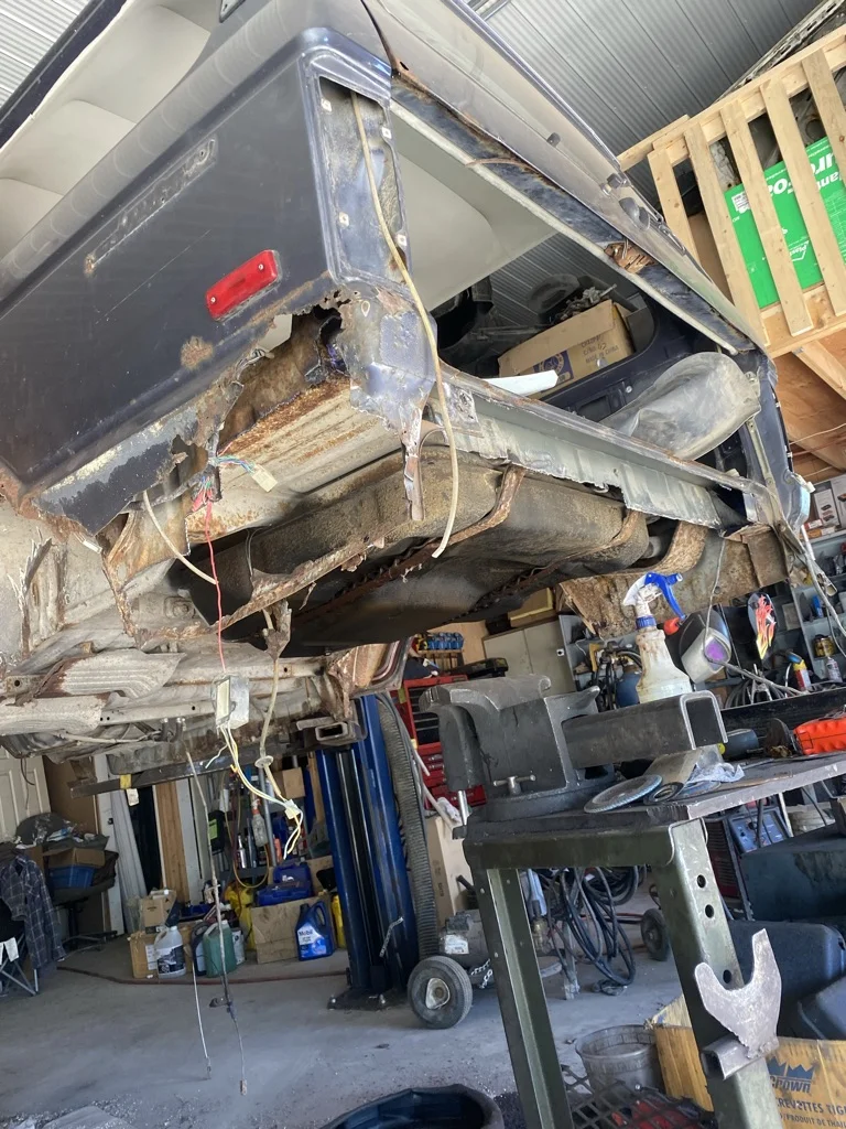

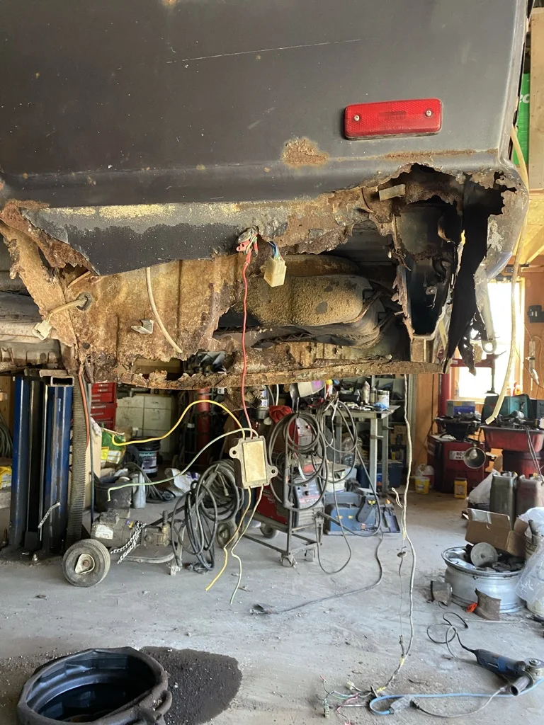

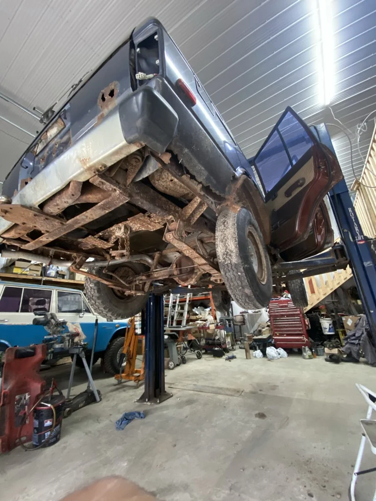

you can really see how rust the rockers and wheel well and rear will are here. rememebr it has 625000km and this is manitoba, canada. But the rest of the body has almost no rust!
I had to strap the front of the cab down to the hoist because it was lifting up.

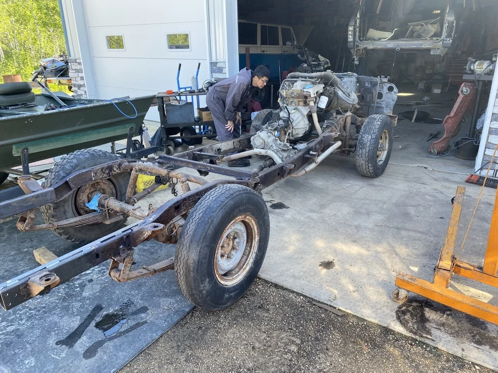

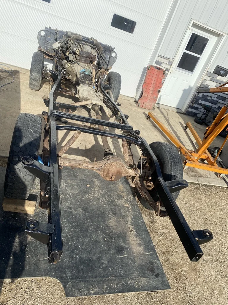

Not that the body is off it was time to start on the frame.

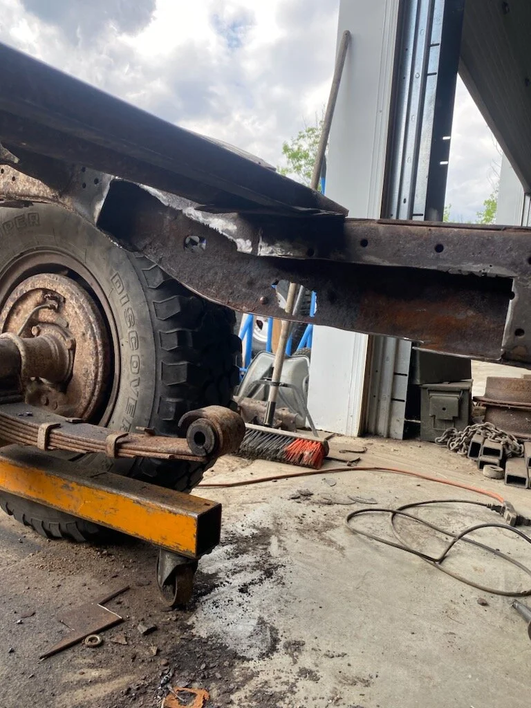

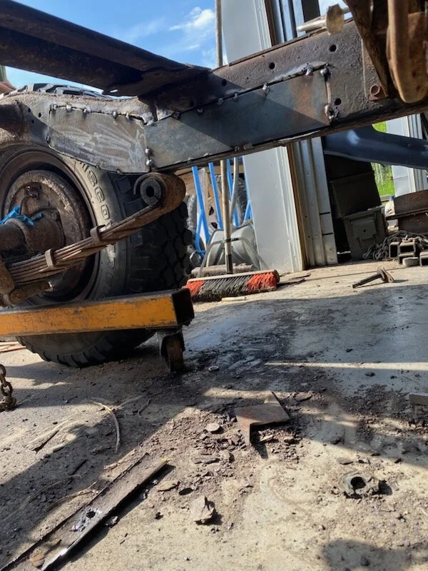

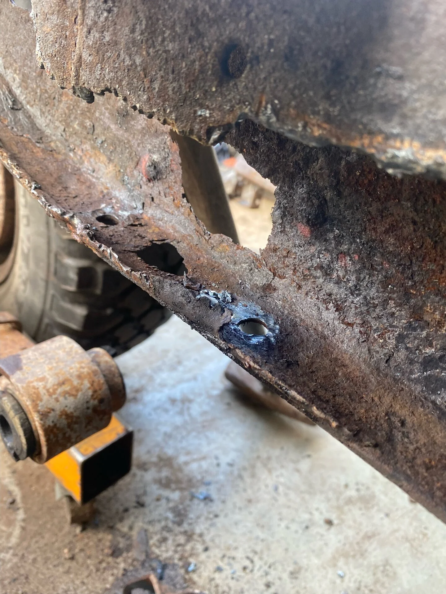

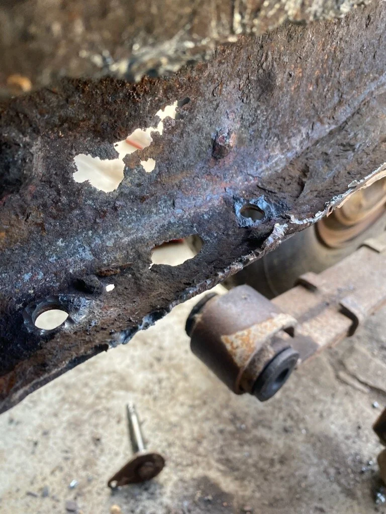

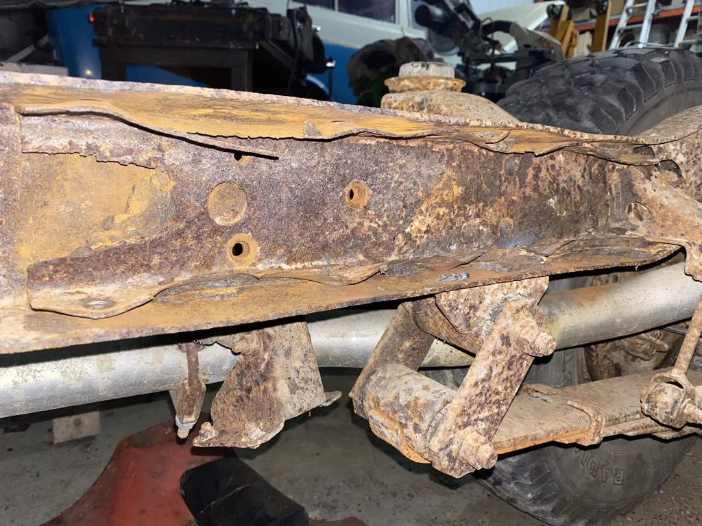

I have to admit the frame it pretty bad from in the typical rust ares. I also hate rivets more than ever now.
i started with removing the homemade? hitch, and rear bumper. I used a combination of plasma, cuttoff wheel's, sledge hammer and pry bars the get the rear bumper and tow hitch off. I than started cutting out the rivets for the inner c channels. This was a couple months ago but im pretty that that took a couple days.

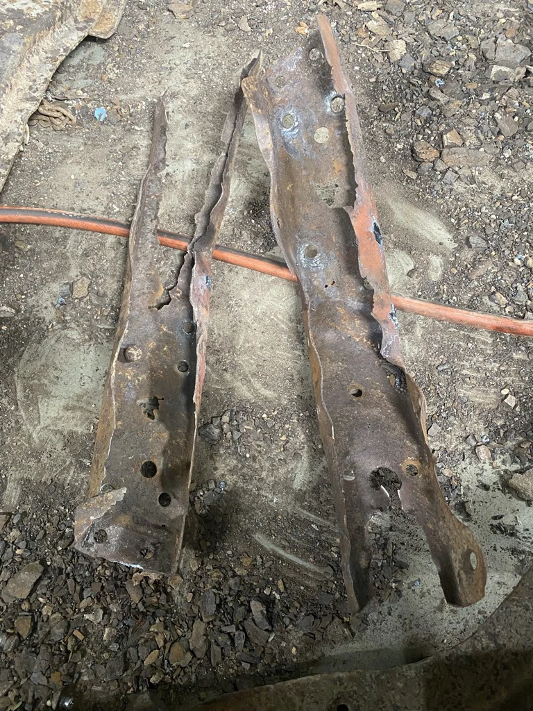

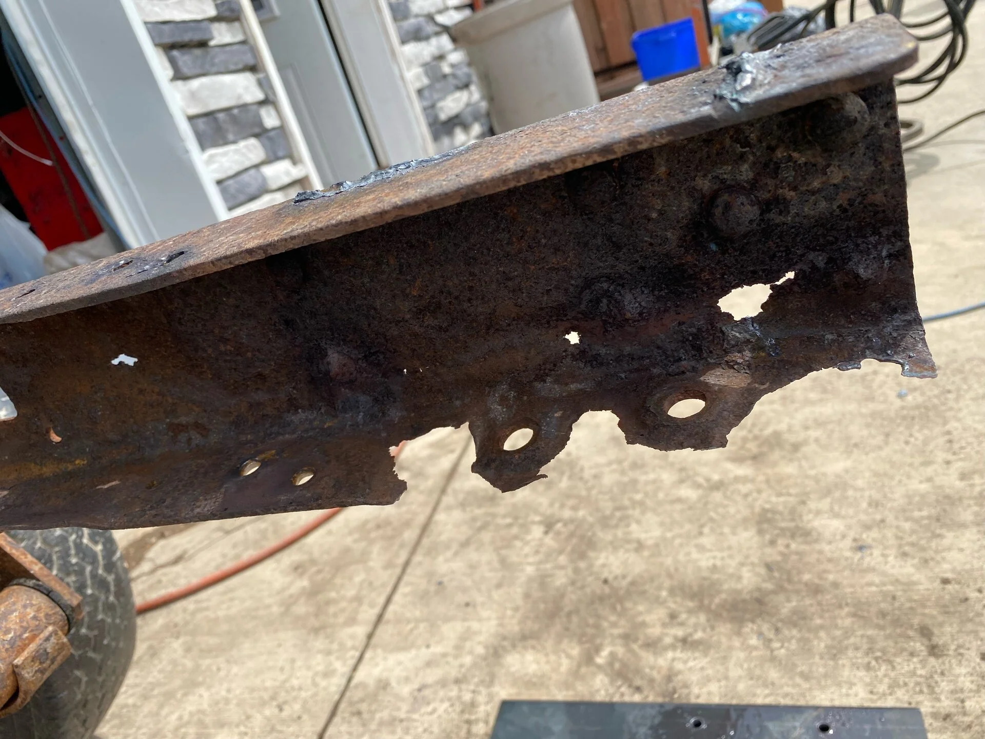

pic taken after usign the airchissel and ply bar to remove all the rust. and most of the rivets. The channel is almost gone lol
Whats left of the c-channel

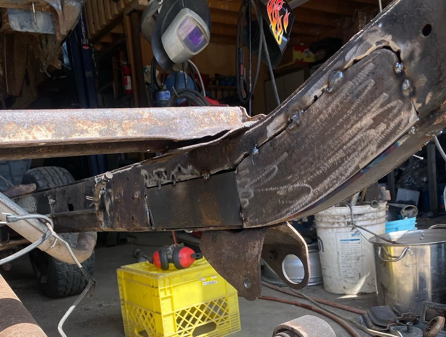

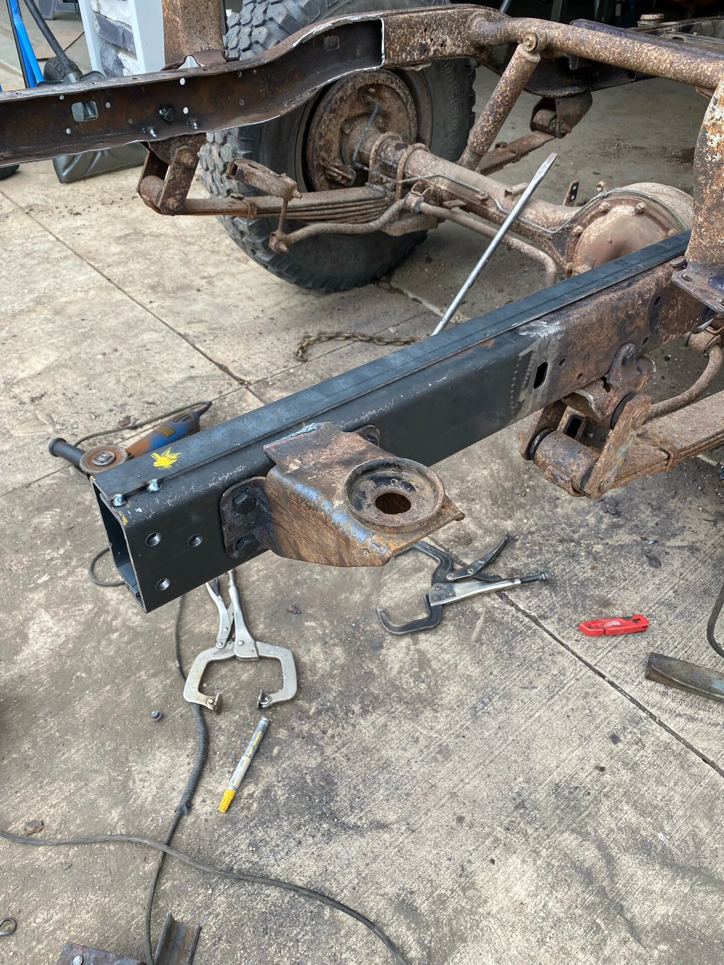

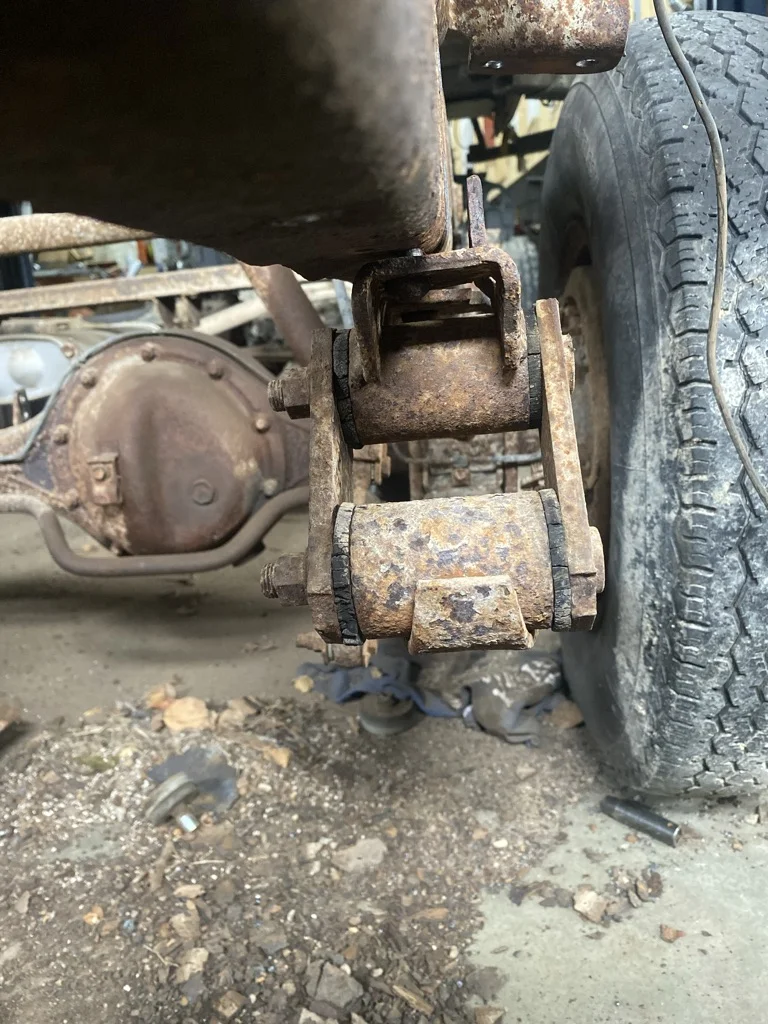

i removed the rear spring mounts, to replace the rear frame on the right side.
This is awesome!

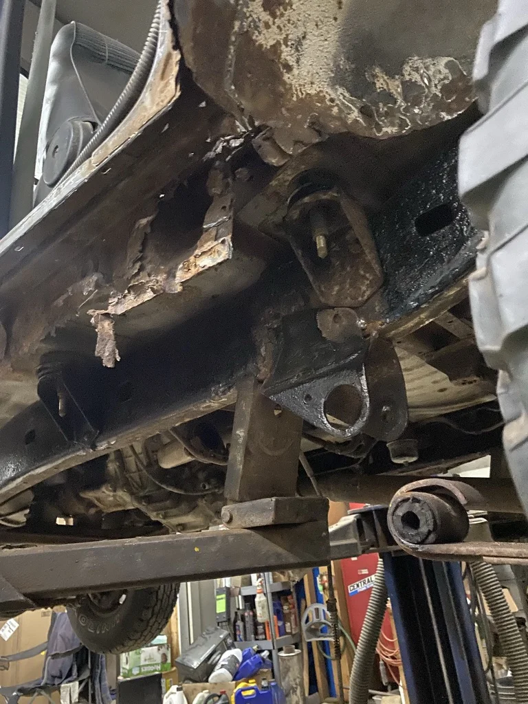

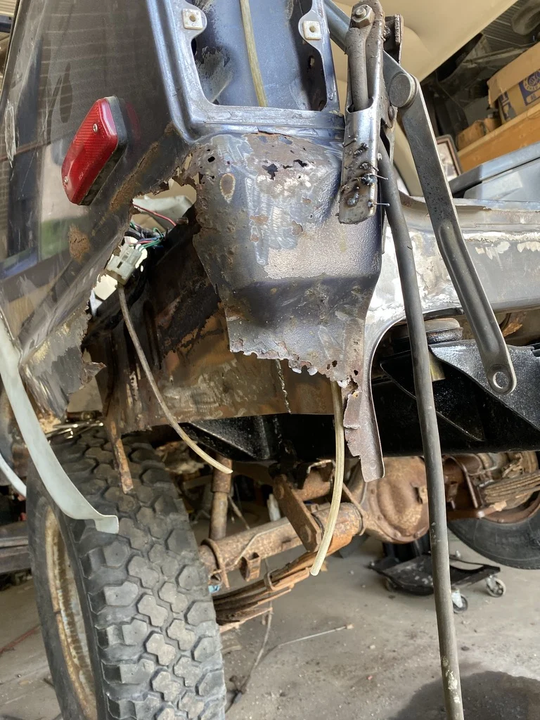

Next i started working on the rust by the front mount for the rear springs. The more I cut the worse it got, I ended up having to remove the rear spring mounts(more rivets... which i hate) and cutting out the rust.
Frame is mostly done so I started working on the rear sill/body mount. i needed to do that before i could put the cab back doen on the frame. I could work on the rest of the rust while the truck was on the frame.

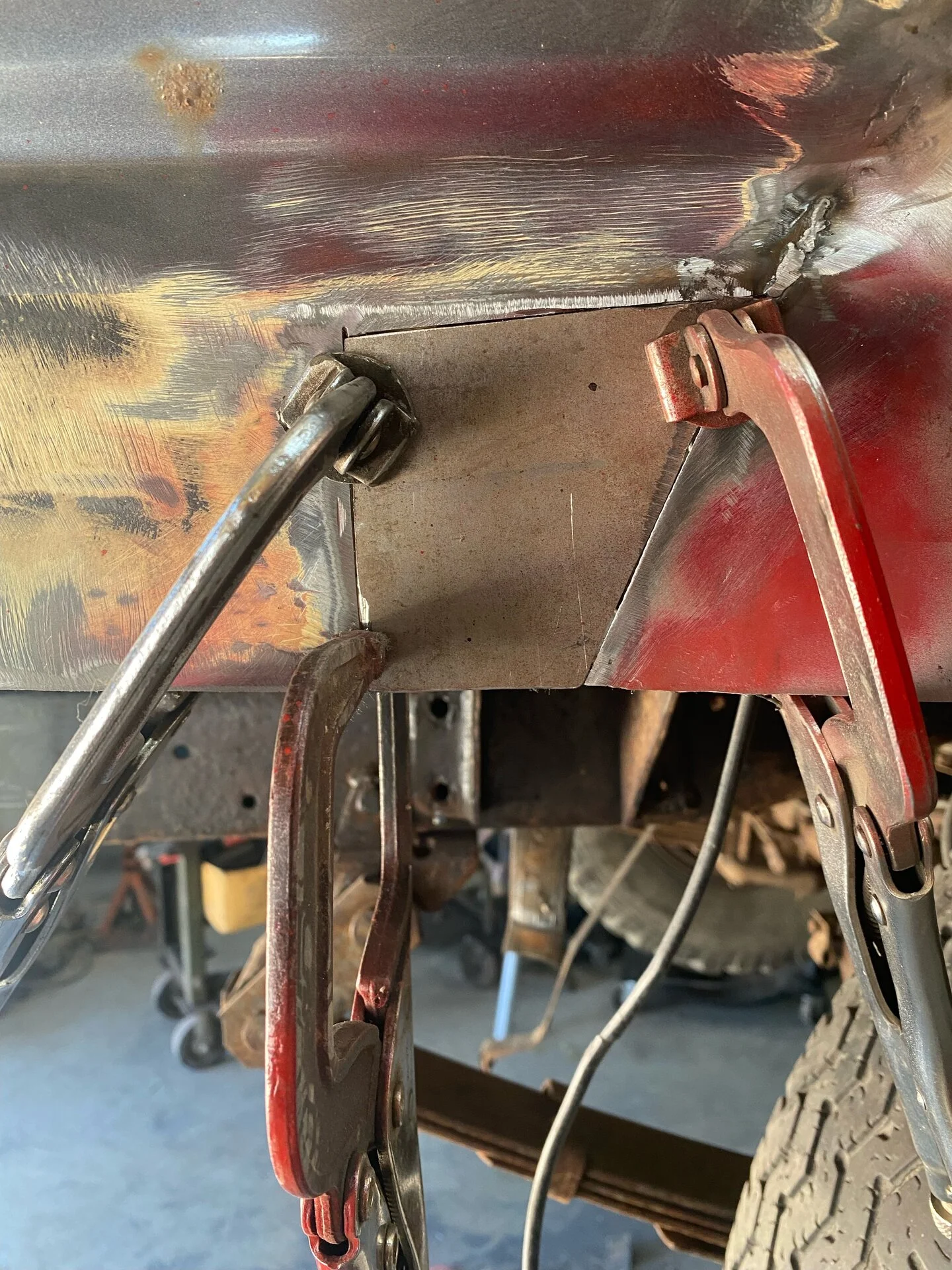

End of June the body was put back doen and i started working on more body rust. The first cut was scary. this is my first time doing somethign like this. I proabbly spent a hour just standing there and looking at it before I made the first cut.

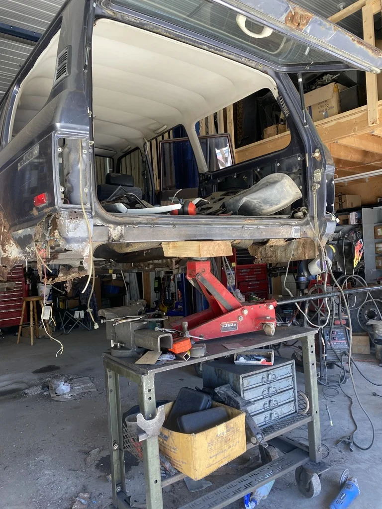

The left rear quarter panel was full of mud. so it was really bad and no aftermarket replacement panel would be able to cover this part.

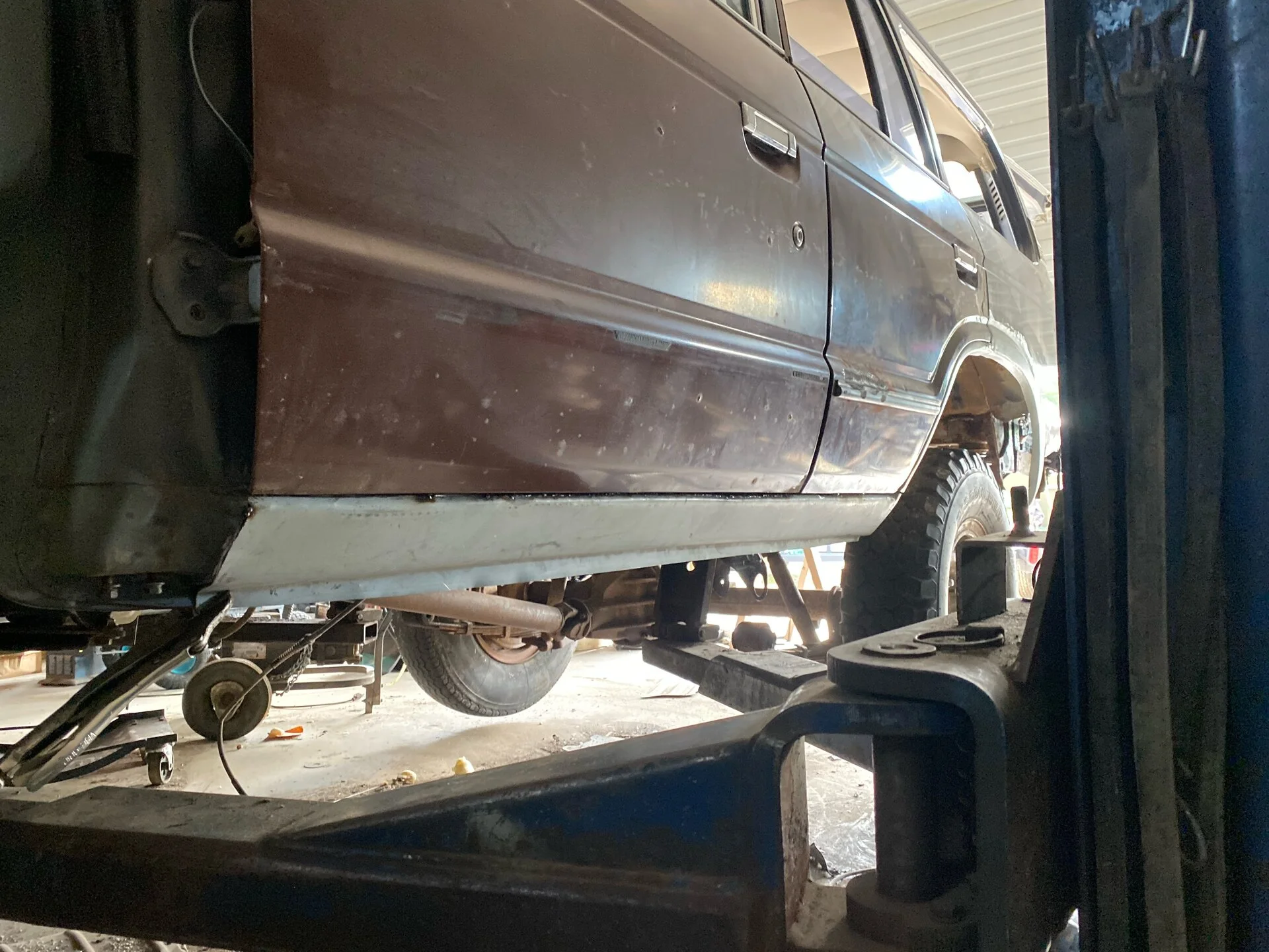

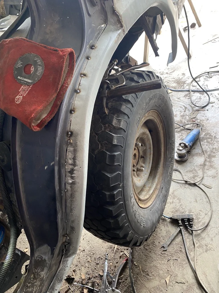

The other side getting welded in. I butt welded every body panel on the truck. I didnt like the idea of overlapping sheet metal and using body filler. The replacement panels worked really well. not perfect but if i did this without them it would take forever.

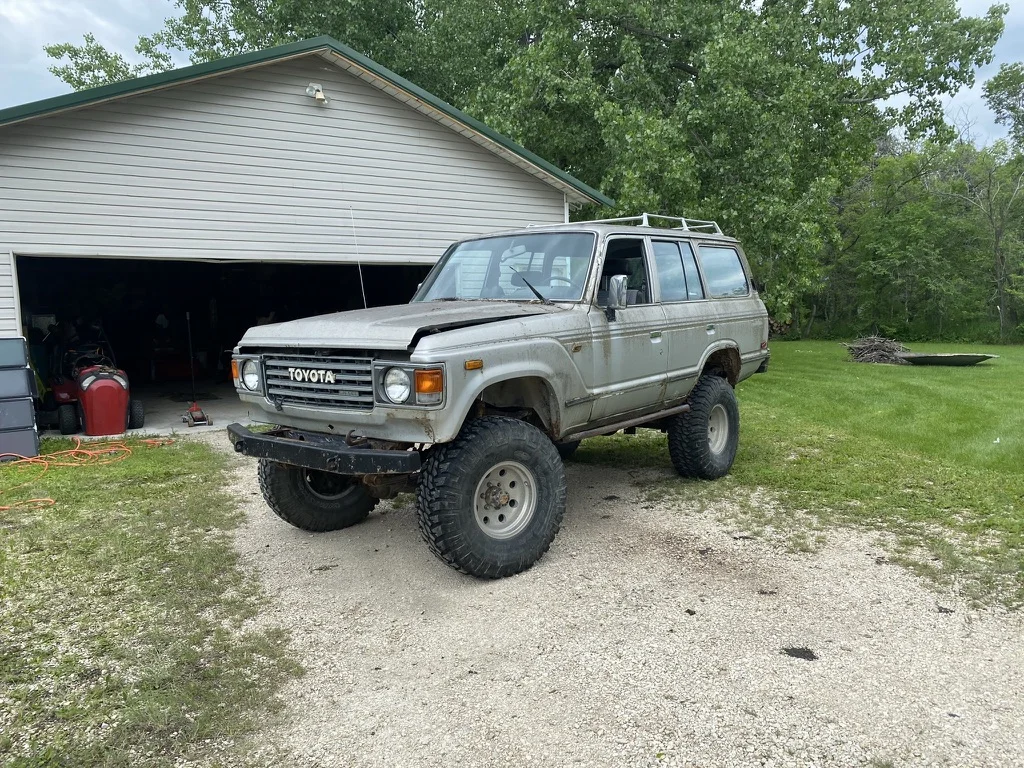

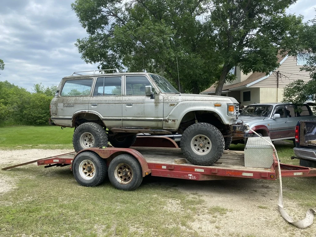

In may, when i started this this bj60 barn truck build, I made a deal to buy one of my uncles cruisers. My dad built this for my uncle probably 20+ years ago. inside the truck i found a 7th annual black hills cruiser classic aluminum sticker.
He gave ma a really good deal, since it had been sitting for 10+ years in his backyard. I bought his Turbo'd 1987 HJ60. He Had had it for a long time. He used to daily it and has drive it everywhere. Its been to Albert for river shiver, Williston, and utah. He even rolled it at his cabin, so this is the second body on it now.
It has arb lockers, soa with cut and turn. and body armour. He also gave me a york 210 and broken(lol) 8274. He had a brand new uninstalled Marlin Crawler Toybox for it, which is now sitting in a closet at home because my dad traded some work for it a couple years ago
