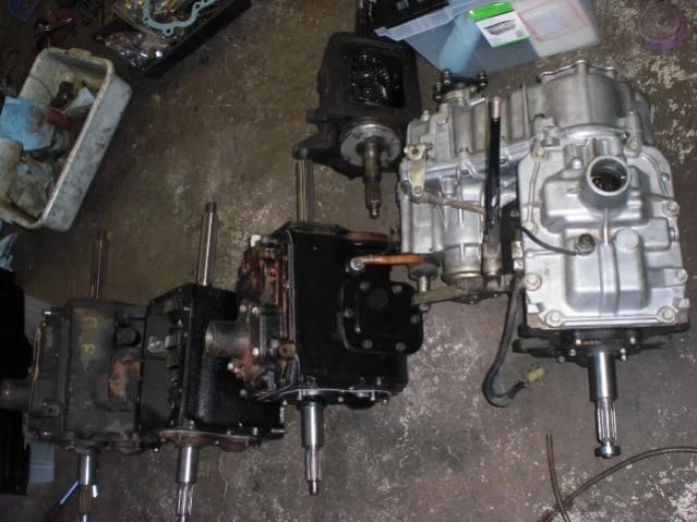

Today I started separating the H42 from the one piece t-case. By prying I was able to separate the cases about 1.5". Only took four hours.
I'm going to need to rig up a puller tomorrow to finish separating the cases.

Separated the cases
Made a homemade puller this morning and that did the trick. Yes I was too lazy to cut down the angle to a reasonable length.
I was able finally loosen the t-case drain plug. It required a nice constant gentle force on a 1/2 drive socket with a hi-lift handle as a handle extension. The drain plug will be replaced with one that takes a hex key.
While I have the t-case finishing draining (yep it still had gear oil in it and a fair amount of rebuilders grease), I took a look at the transmission output shaft splines. There is noticeable wear.
I'm going to start cleaning the cases tomorrow. They aren't too bad so some simple green and elbow grease should do the trick.
The transmission, bell housing, and speedometer gear housing will need to be painted. I'm thinking the bellhousing will need to be painted with a high temperature paint due to the proximity to the exhaust. Thankfully I have an old clothesline post at my place that can be used as a paint stand.
I'm debating the double seal mod to keep oil from leaking into the e-break. Once I remove the speedometer gear housing I'll be able to check for wear.

Removed the speedometer gear housing from the back of the t-case last night.
The speedometer gear is pretty worn down. I'll will likely swap it with the one that is currently installed behind the t-case in the truck, though if that ends up damaged I will replace it.

Yesterday I opened up the H42. Seeing some rust on the gears, I methodically scraped all of the surface corrosion of the gears on the input shaft. The H42 is at Mark's Off Road getting a new tail shaft put in.
Found out the t-case that came with the H42 was in fact a 4-speed t-case. The corrosion on the input gear is beyond what I want to run. Since I'm going to need to buy a new input gear, I'll get one to use the 3-speed t-case that is currently on my truck.

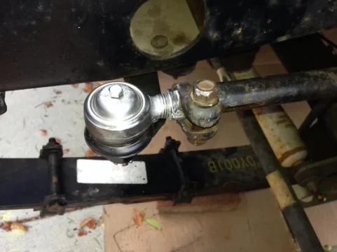

Today I finally put the tie rod end on the drag link. Only 5 years I think since I purchase the set. Found the TRE when unpacking a box from the move this week.
