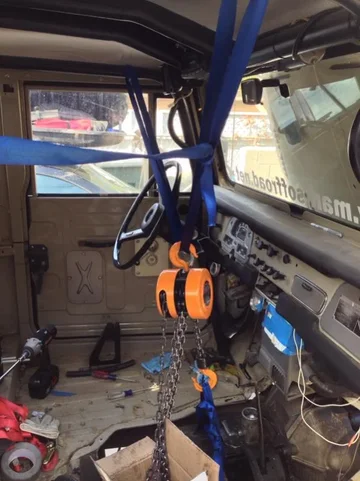

Taking a quick lunch break before unbolting a lowering the transmission and t-case.
The roll cage is doing double duty today as the framework for the lowering system.

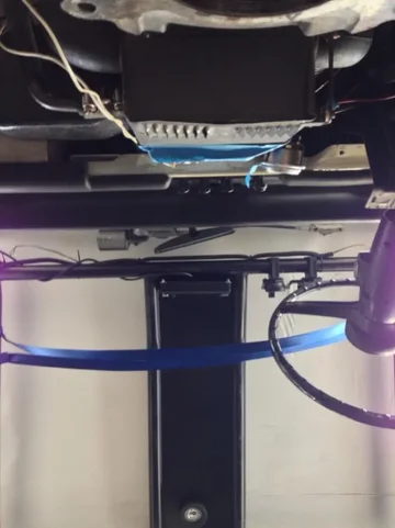

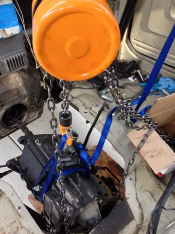

Lowering the transmission
And the three speed is out
I had to take apart the t-case linkage to clear the frame rail, but aside from the it rolled out easily with the furniture dolly.

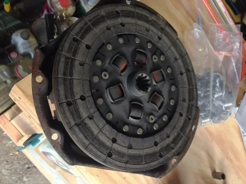

Pulled the clutch this afternoon.
Nice view looking up into the truck.

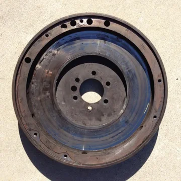

Ran into some problems this morning while attempting to remove the flywheel. I was able to keep the flywheel from turning, but even with the electric impact gun (200 ft-lb) I wasn't able to get any of the bolts to turn. I didn't spend too much to win each bolt as I saw no rotation of the socket.
Any thoughts aside from a more powerful impact wrench?
That's what I'm thinking.
Also the lock plates weren't folded up to lock the bolt heads. I'm now wondering what else may have been overlooked by the shop that did the rebuild.
I use a pry bar in the teeth of the flywheel to 'lock' it to the bellhousing, and a half inch breaker bar on the bolts. I had the same problem with the motor my customer bought from saryon7.
X2 I just pulled mine the other day With a breaker bar. If needed you could use a cheater pipe over the breaker bar for some more leverage.
Got the flywheel off, but not out. The half inch breaker bar worked, no heat required (though I had a torch on standby).
The collectors for the headers runs just enough under the bellhousing to prevent the flywheel from dropping free. :bang:
Also found that the shop that installed my engine used an necessarily long bolt on the left rear engine mounts. I had to back that off to see if I could find a way to slide the flywheel out. :bang:
I think there may be project creep because of this. The old rusty exhaust may come out in favor of a stainless one run correctly. The two piece headers would be replaced with Tri-Y headers to move the collector farther forward. Then custom stainless exhaust the rest of the way back.
Flywheel is out, finally.
