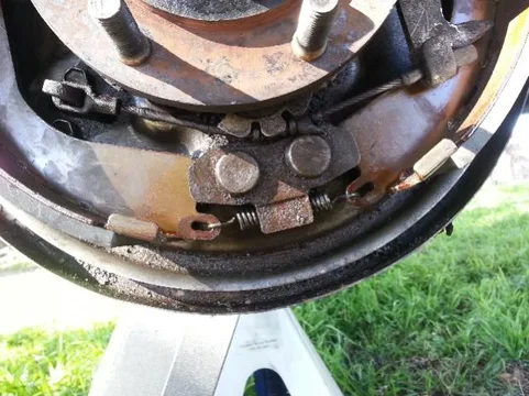

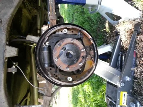

Do these look right? I need the brakes and they work fine, but the hand brake isn't working now. I'm sure I installed everything correctly, they match up you the pictures I took before I started. Should I loctite the spacers back on or do I have to tell something inside the drum to get the hand brake to work.

Looks fine from here. Likely not adjusting shoes out far enough, I would advise to tighten (expand the adjuster) until the drum is locked in place then back off until you have just a hint of drag. Road test to seat in and then recheck.
Thanks I decided to put it back together and it all works fine. I just needed to tightened everything up a bit.

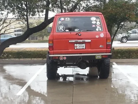

I've always had some driver side lean with Big Red, but I've been noticing it more lately. Not sure if it's the weight of two batteries plus my fat ass or it's just in my head. What's the best way to correct this? Swap the rear springs to the front (if that's even doable), re -arch the current ones or order new heavier duty springs and if so what's recommended. I'll post up pictures of how bad it is when there's better light outside. Thanks.
The surface is a bit slanted, but it still has a noticeable lean. What's the best way to tackle this. By best way I mean cheapest safe way.

I was wondering who would be the first to make that comment :). here are the right side up pictures.
can't really tell from the side
Again I'm looking for cheapest safe way to fix this. any input is appreciated
All of my cruisers have had some lean (40,61,80,100). Just roll with it. It fits your gangsta look :)
I'd keep the stock springs due to ride comfort. HD springs on an SOA would be stiff and feel like crap on a tall truck.

That angle looks like a broken spring, but I suppose they are all fine so no idea. Maybe a broken spring replaced with one old pack.

Taller rear spring goes on the driver side here in the states...
Swap springs side to side...
A friend of mine just picked up a rough Series III Rover and the PO had installed a taller shackle on one side :rolleyes:

I thought it could be a broken spring as well, but it's not. It just bothers me because I have an obsession with symmetry, but it's still functional, so I won't be shelling out a lot of money anytime soon.
Will swapping them fix the lean or make it go the other way?
