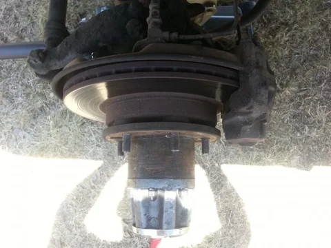

I forgot to add this picture. You can see how the brake caliper sticks out a bit further than where the back of the wheel will sit. Spacers should fix that right up. Now my concern is the tires might stick out too much since it's only 2.5 in backspacing and 1.5 in spacer on each side. It might look ridiculous just as long as it is functional.

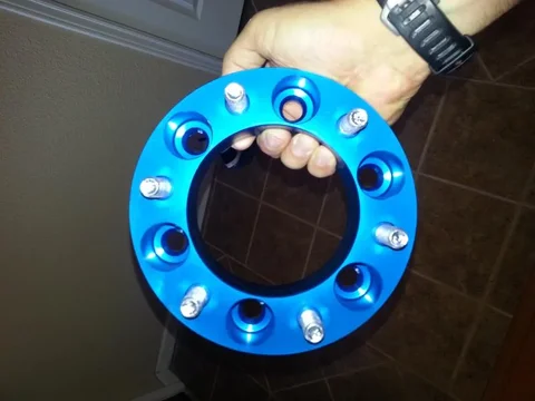

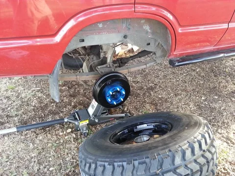

so the UPS package I been waiting on finally showed up. My 1.5 in Slee spacers
finished my quiz and I quit working on my paper that's due and started working on Big Red. Took off the tires and cleaned up the drums and painted them a bit then installed the spacers. Torqued them to the required 85lbs. Then I mounted the new tires. They are heavy and with a healing knuckle and torn ACL it wasn't easy mounting them.

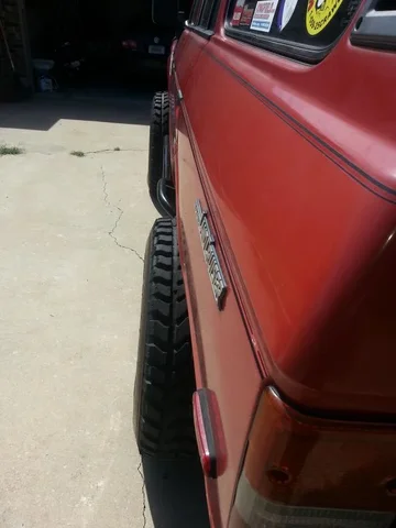

Here's what it looks like from the side. I drove it and was pleasantly surprised. No vibration like I was worried about and a much better turning radius. I gotta chalk test them to figure out the best tire pressure. I'll write more after dinner, I'm starving right now.

The base came out wider with the 2.5 in backspacing and the 1.5 in spacers, I'm still getting used to the narrower tire look. So far I like the way they handle, no road walking like the creepy crawlers. I'm going to drive it on the highway right now to get a better impression. Will post more pics later.
It does look more "bad ass" with the crawlers, but I'll bet you're going to notice better overall street performance with these.
I already noticed a great improvement on normal drives. It seems to get up to speed faster and it handles more like a pickup than a bus. The tires are also quiter and can drive in a straight line, with the crawlers You can't take your hands of the steering wheel. I think I'm more comfortable taking much longer trips with it now. I do however feel a slight oscillation type vibration in the shifter knob while driving. I'll take it in next week to have the tires rotated on the wheels just to be sure. Next big project is regearing and lockers.

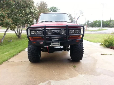

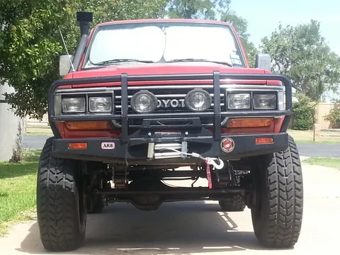

Sweet rig, what backspacing did you order on the TWF wheels? I'm guessing you got the flat centers, I'm guessing no flat centered wheels would work on a 60 without running spacers the way you did?
Could you post a head on shot showing your wheel offset?
I got the 2.5in backspacing because I wanted a wider base. I did get the flat center, I should have taken the wheel off and looked first, but it worked out in the end. It has improved the handling of the rig, I can make sharper turns without it feeling like it's going to roll on me, or rubbing for that matter. Still experimenting with it so much can change, but overall it's been an improvement. Here are the pics I got that I haven't yet posted.
