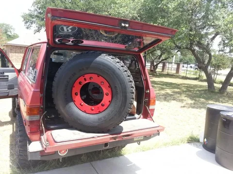

It's been a while since I've posted anything new. I've been busy with school, the rental property and life in general. I finally squeezed the trigger and ordered a set of military tires on Humvee wheels. The centers have been cut out and a 6 by 5.5 bolt pattern has be put in to fit the toyota.
It was a massive pain to lift them and get them in Big Red, but well worth it.

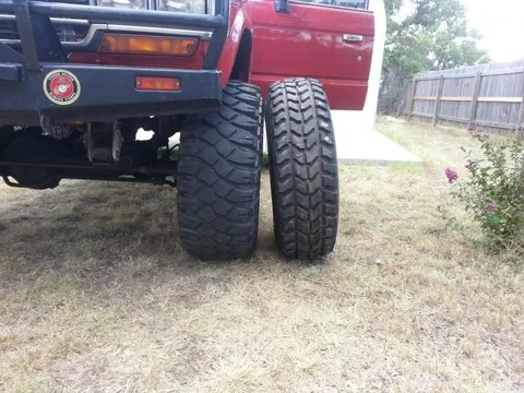

This is what it looks like.
They look good and are taller than my Creepy Crawlers, but they are narrower and I don't like that.

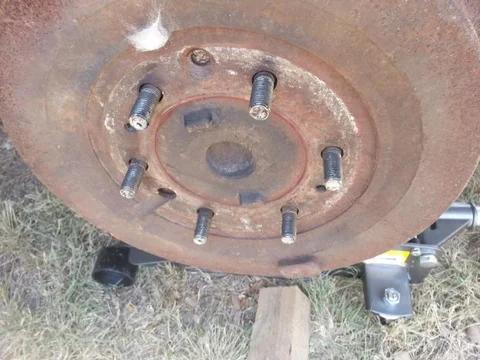

I was so excited when I got home I started airing up the tires and trying to mount them. That's when I ran into a small issue. The drum brake has a little square metal piece that sticks out, preventing the wheel from sitting flush against the drum.
It's at the lower right of the pic.
So the only thing I can think of is to order spacers and mount it. I called Slee and ordered the 1.5 in spacer, they are almost positive it will fix my issue as well as clear the front caliper, the only problem is I have to wait until next Thursday to get them. I was hoping to be driving it with the new wheels for the 4th.
