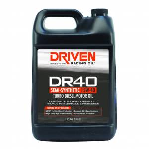

They have a T6 15-40 now yet I haven’t seen it in a store locally yet. Just the T6 5-40
Wouldn't the 5-40 be better than the 15-40 because it can work in a wider temp range? Or am I missing something?
Yes that is true. Since it’s summertime the 40 number is the important one. There are some 15w-50 diesel oils out there that I’ve always wanted to try in our summertime death heat.
