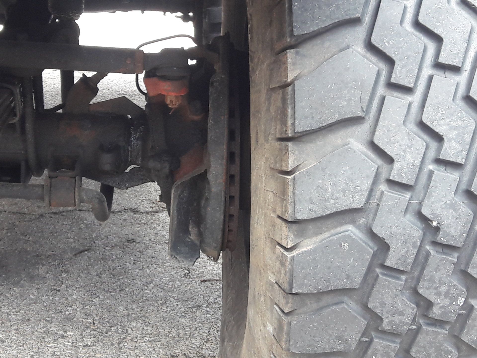

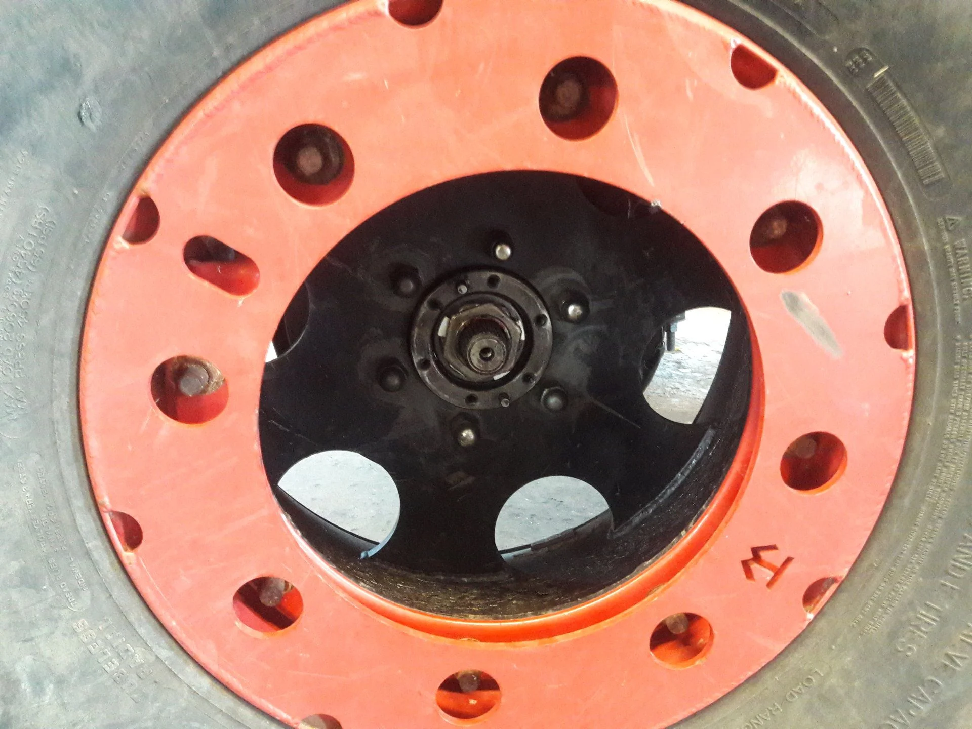

Looks to me like you had a catastrophic wheel bearing failure. Bummer man, that kind of thing is expensive to repair.
Collaterl damage has yet to be seen, don't get him all spun up just as he is shipping out!
^^^ Glad you made it to the shop safe. Perfect timing on the hub swap, as it seems the front end will be coming apart anywho.
Not an exhaustive list:
1. Improper bearing preload
2. Improper use of star (locking) washer between the spindle nuts
3. Failed bearings (wore out and not checked often enough)
4. Improper lubrication (seal failed, all the grease came out)
Running spacers and high offset wheels will put more wear on the outer spindle bearing, and much faster, so it's something that really needs to be kept on top of.
I spoke with Edwin at land cruiser specialist, he says the knuckles still look good. The hub came loose and my bearing is all chewed up and needs replacing. He suggested I also replace my rotors. So hopefully I'll be driving big red pretty soon.

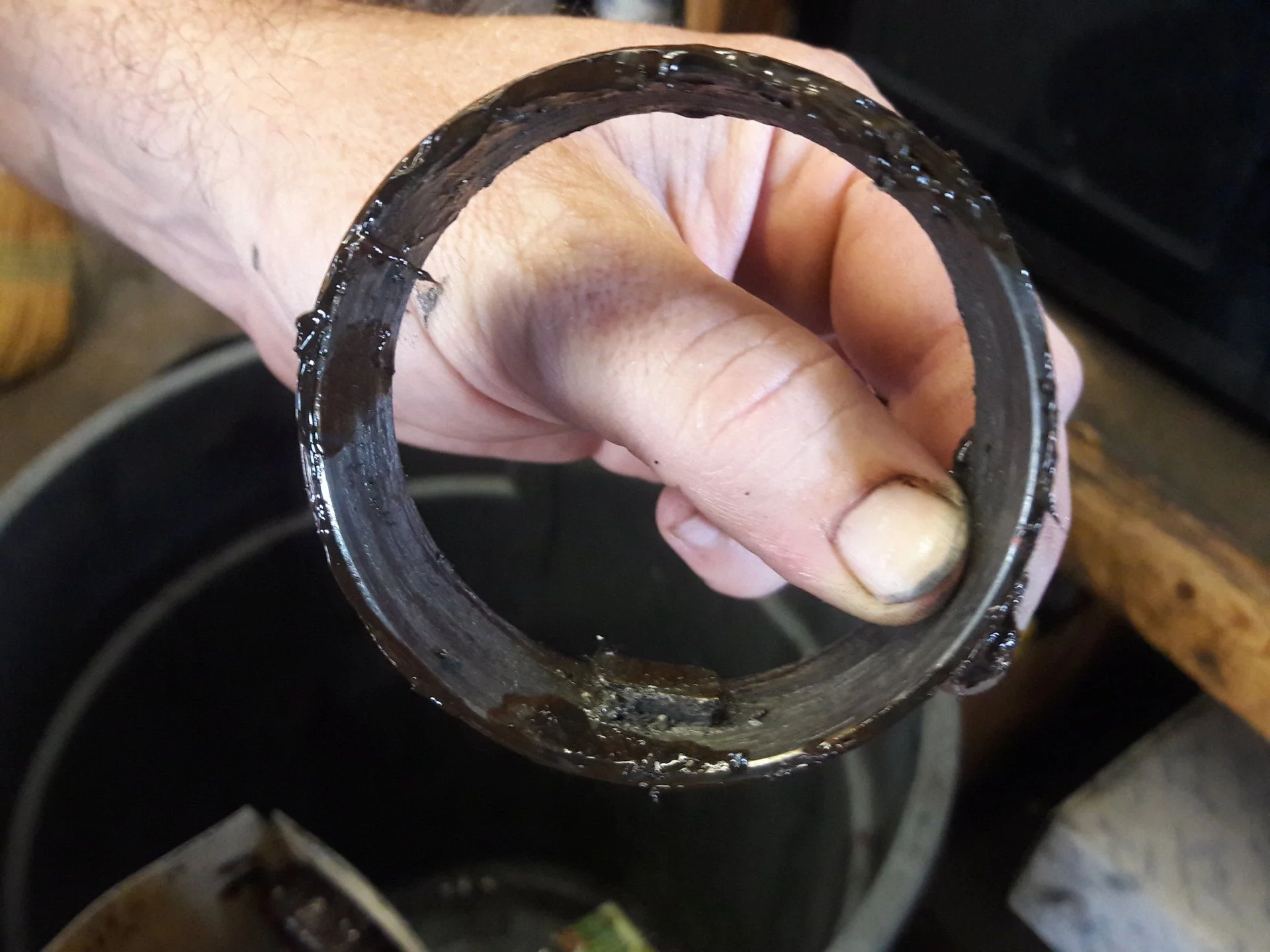

The heat welded metal parts to the race
Trashed bearings and hubs, not reuseable

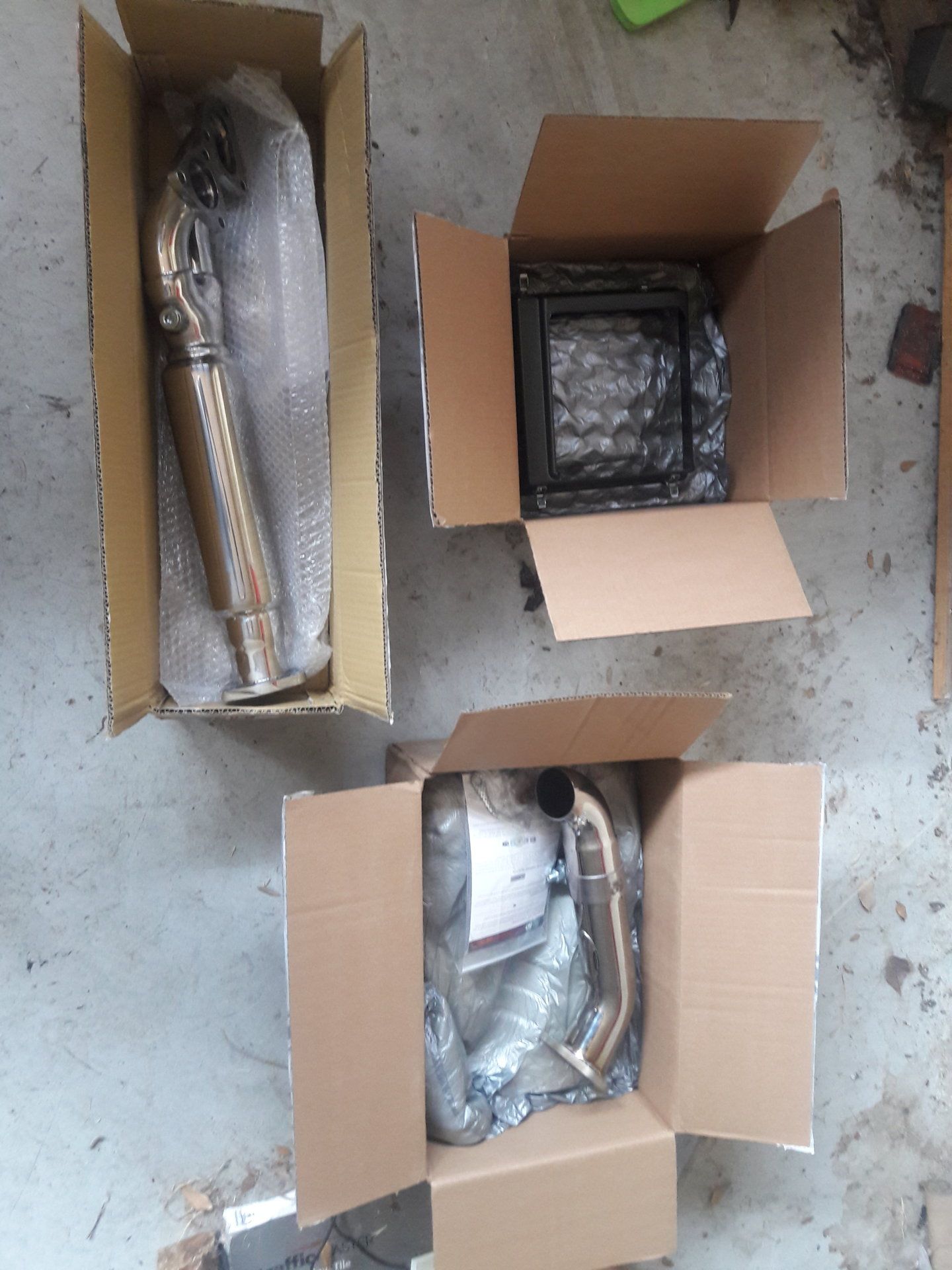

These showed up today for my other toy.
I was hoping to install them this weekend, but it's getting valve adjustments and a new clutch. So next week it is.

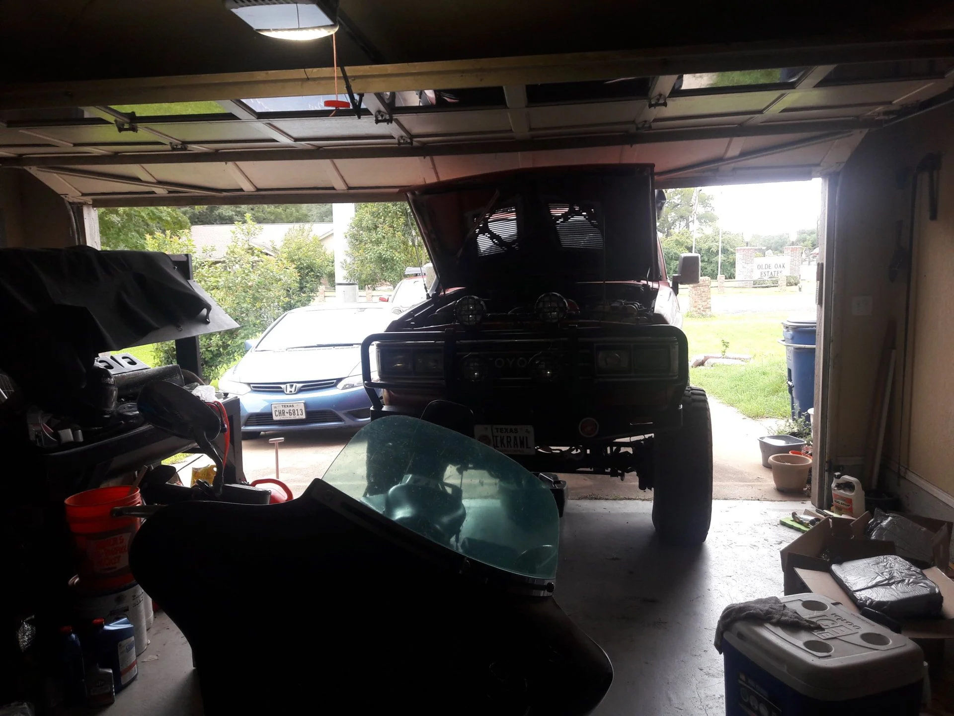

Decided to change the oil, but it started to sprinkle. Pulled the front end into the garage and changed out the oil. Surprisingly I didn't spill any oil this time. Went for a drive after that.
