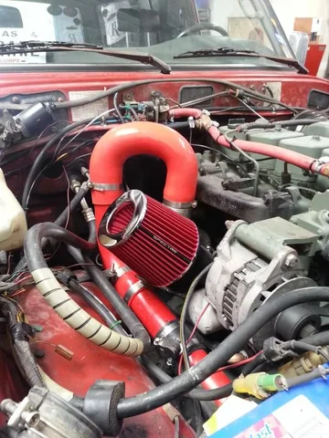

the power steering reservoir is hooked up now and it makes life so much easier. Took apart the inline pump and moved the fuel plate all the way to the left. Now boost hits about 20psi before running out of road. I'm still looking for a cartridge for the HX30W, if i don't find one soon I might just buy Dave's. Tomorrow I'm going to put an air filter on the turbo, the air box doesn't fit so one needs to be made. Monday I'm getting the exhaust welded. Then I'm gonna drive it for a few days to give Edwin a break. After that it's the AC and debugging, should be ready for the trails.

the air filter we put in while we figure out an airbox

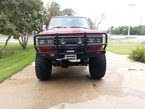

Here are the pics I meant to post up last night. The first official diesel fill up, the front and front-side view. The fill up still hurts the wallet, so time to get serious about making my own biodiesel.
