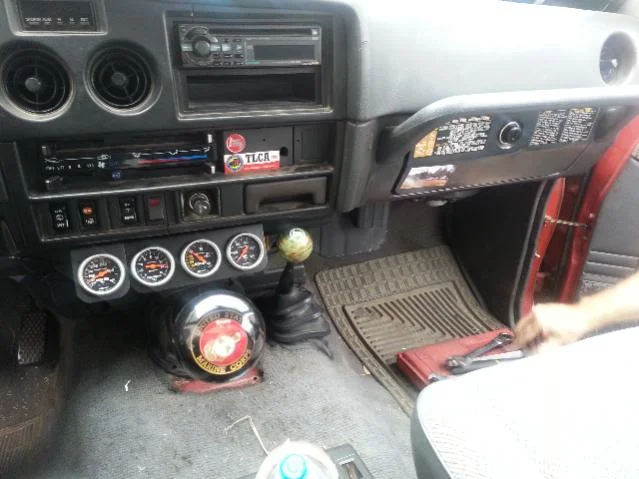

On a bighter note I got these installed and I think they look awesome
That ball looks massive at that angle!

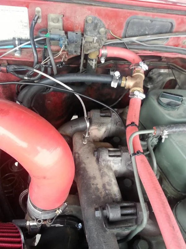

Back to the EGT numbers, I'm thinking the location of the tap makes a huge difference and perhaps that's why mine is reading a little higher than most. I have mine on the manifold right before the turbo.
The rig runs smooth and it doesn't feel like it's stressing or laboring while driving. Of course this is all from the seat of my pants science until I get the tach working. Let me know where you guys tapped in to get the EGT readings.
The pyrometer is supposed to be installed in the exhaust manifold pre-turbo. That's where Dave, Mike and myself have the probes installed.

The reason why is so you can monitor the temperature of the air going into the turbo.
Anything over 1200 degrees F and you have to worry about damage to the turbo, keeping your EGT over that temp for too long can actually start melting the casting.

This is true but more importantly the exhaust valves will melt at 1250* if pushed more than 30-45 seconds. I had a 6bt hot rod that I would see 1800* for short bursts but 10 seconds at a time. I always like to see 400* or less when shutting it down due to the oil boiling and sludging up the turbo. If its still upwards of 400* then let it idle for a couple minutes, your turbo will thank you.
Note: you can install the pyro gauge post turbo but expect a 200* drop in temp and figure that into calculations, pre turbo is most important number.
