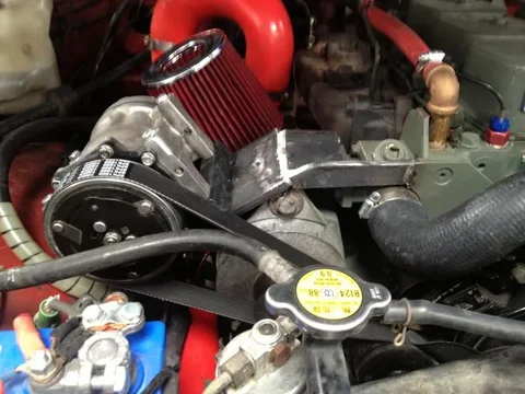

figured it's time for an update. Mounted the AC, but still need to hook it up. the tach is in now as well. you can stand on the ac bracket that Edwin made and it won't move.
Now comes fixing the little things, like cutting the ac hose and playing around with the fuel pump.

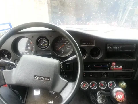

the alternator seems to work well, no issues yet, time will tell, in which case I'll upgrade to a better one. As for the tach we had to get an autometer tach and place it where the stock one goes. I'll take a picture of it and post it in the morning. I need to tighten up the drain plug, has a slow drip. It's just marking it's territory in my driveway now.
as promised, here is a picture with the tach and other gauges. The shift knob looks larger than it really is because of the angle, it's about the size of a cue ball.

Small update. The ac bracket broke today while the diesel mechanic was test driving it. Now he's going to reweld it and reinforce it.
On a more positive note, this is what's been done so far.

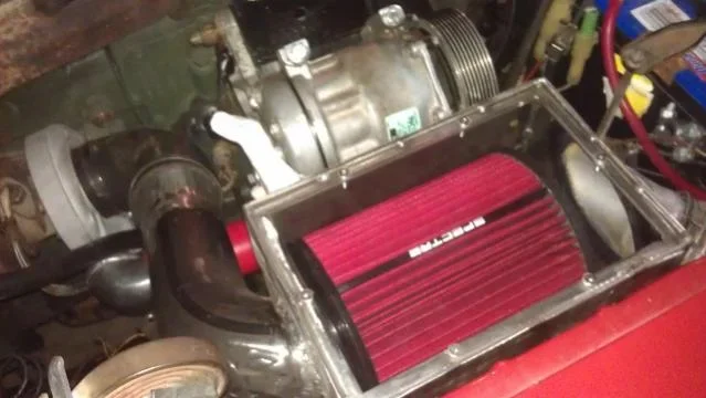

Still looking for an airbox that will fit and the snorkel should be arriving any day now.
Any updates?
Snorkel arrived today, but I wasn't at home so I have to wait till tomorrow. The ac is welded back on and reinforced. Need to hook it up and test for leaks. The pump has been adjusted. Then its installing the snorkel and testing it with everything on there.

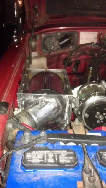

Here's an update. The air box is made and installed. The AC bracket is rewelded and the snorkel should be getting redelivered any hour now.
I might change the air filter to a cone to allow better induction. It just looks restrictive right now. All that's left is charging the ac and test driving. I'll install the snorkel this weekend during our club get together.
