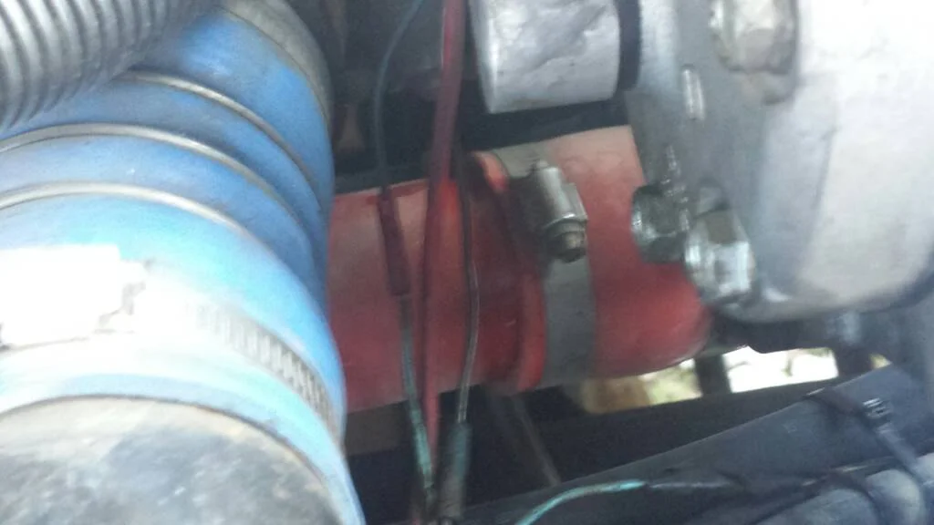

So found the leak. Checked the turbo, there's no play. Tightened it back up and ordered stronger clamps.

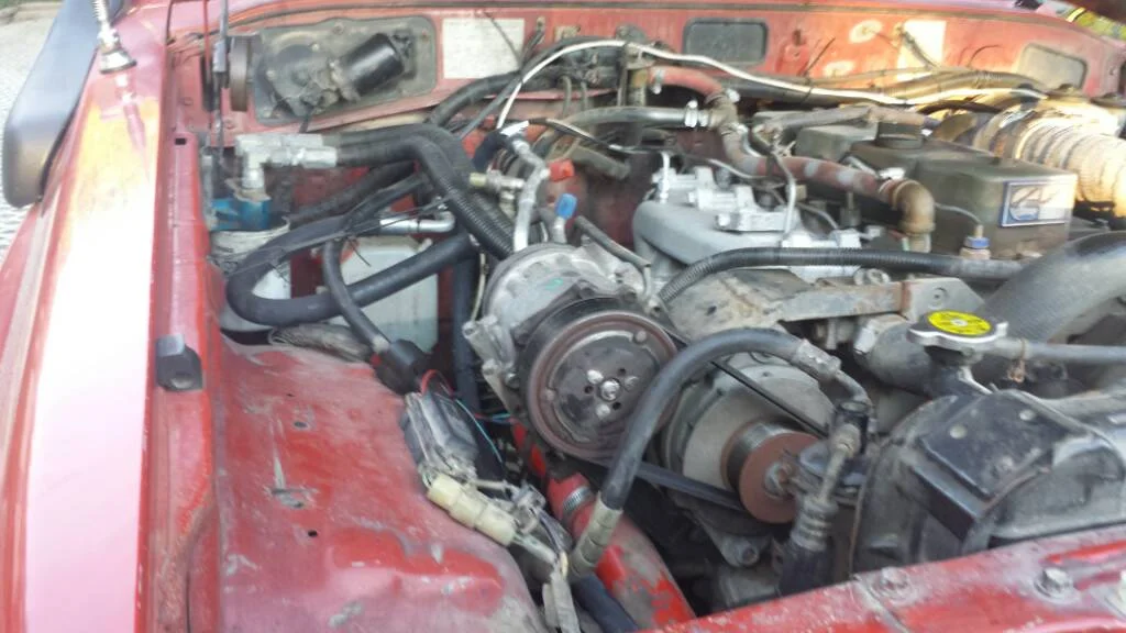

Had to remove the air box to get to it.
While I wad doing that I found where the freon leak is coming from. The joy of owning this rig never ends.
Two issues for sure.
#1, you're using a worm gear clamp on a boost fitting. No bueno. Buy some t-bolt clamps from Silicone Intakes
#2, if any boost tubes don't have a flare on the end, then they will slide off, despite using the best clamps.
There are some methods on 4btswaps of adding a flare to existing tube, or you can buy flared tubing from siliconeintakes, linked above.
As a temporary fix until you can get a flare on that tube, spray the tube with hairspray, then put the boot and a proper clamp back on.
EDIT for clarity. You spray around the outside of the boost tube, where the boot would contact the tube. The hairspray dries tacky and helps hold the boot onto the tube.
