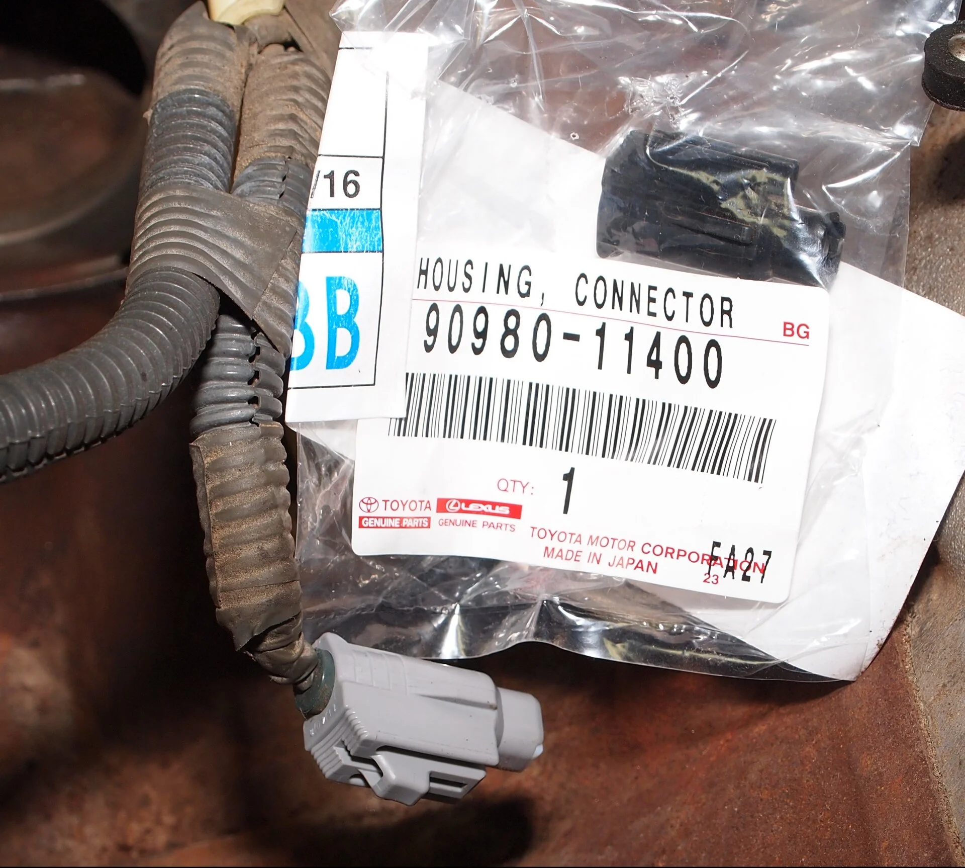

Lock tab, of starter wire housing connector. Almost always breaks.

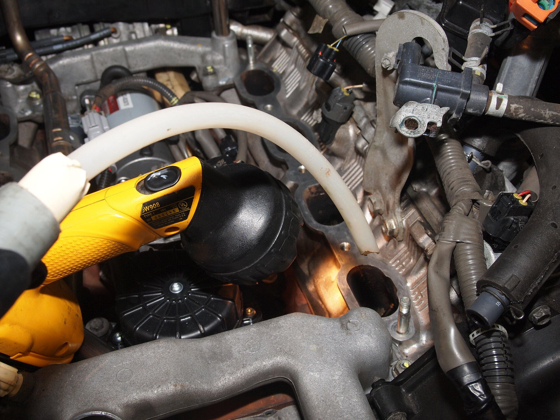

Clean Clean Clean. I clean top of engine before removing anything but engine cover. I finish by getting on top of engine with a flashlight. Then vacuum out ever spec of dust from intake port of heads.

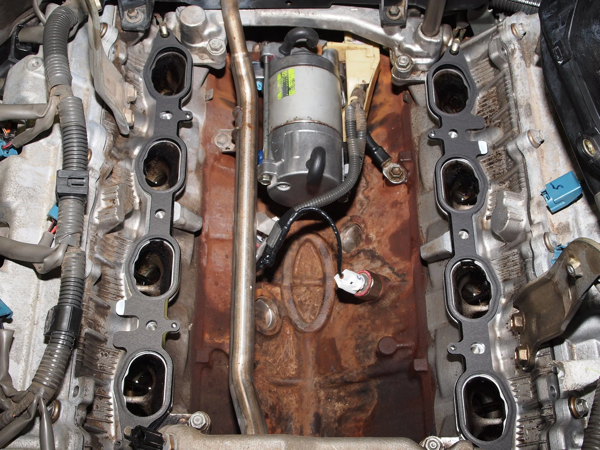

Remember. Intake gaskets, White tabs up.
