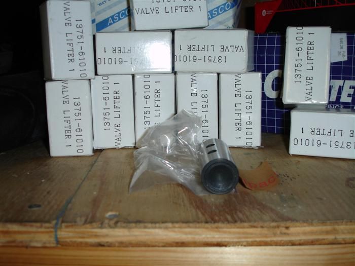

Now on to the lifters that I got from CCOT
All but one are the same. WHich kind of pisses me off. I'm hoping they will exchange it. The one that came in the two piece box but has the same part # on it looks like a much better quality lifter. I wish I had 11 more of those. But something tells me they are old stock.
One on the left is the only one that looked like it did.
And I really don't like the tops of the 11 I got. The One on the left looks a heck of a lot better. I'm hoping to get 11 like what is on the left. We shall see.
I get these lifters from the same vendor as CCOT and have used them for years, but never seen any like the left one......the ones in the pic are new stock....::
