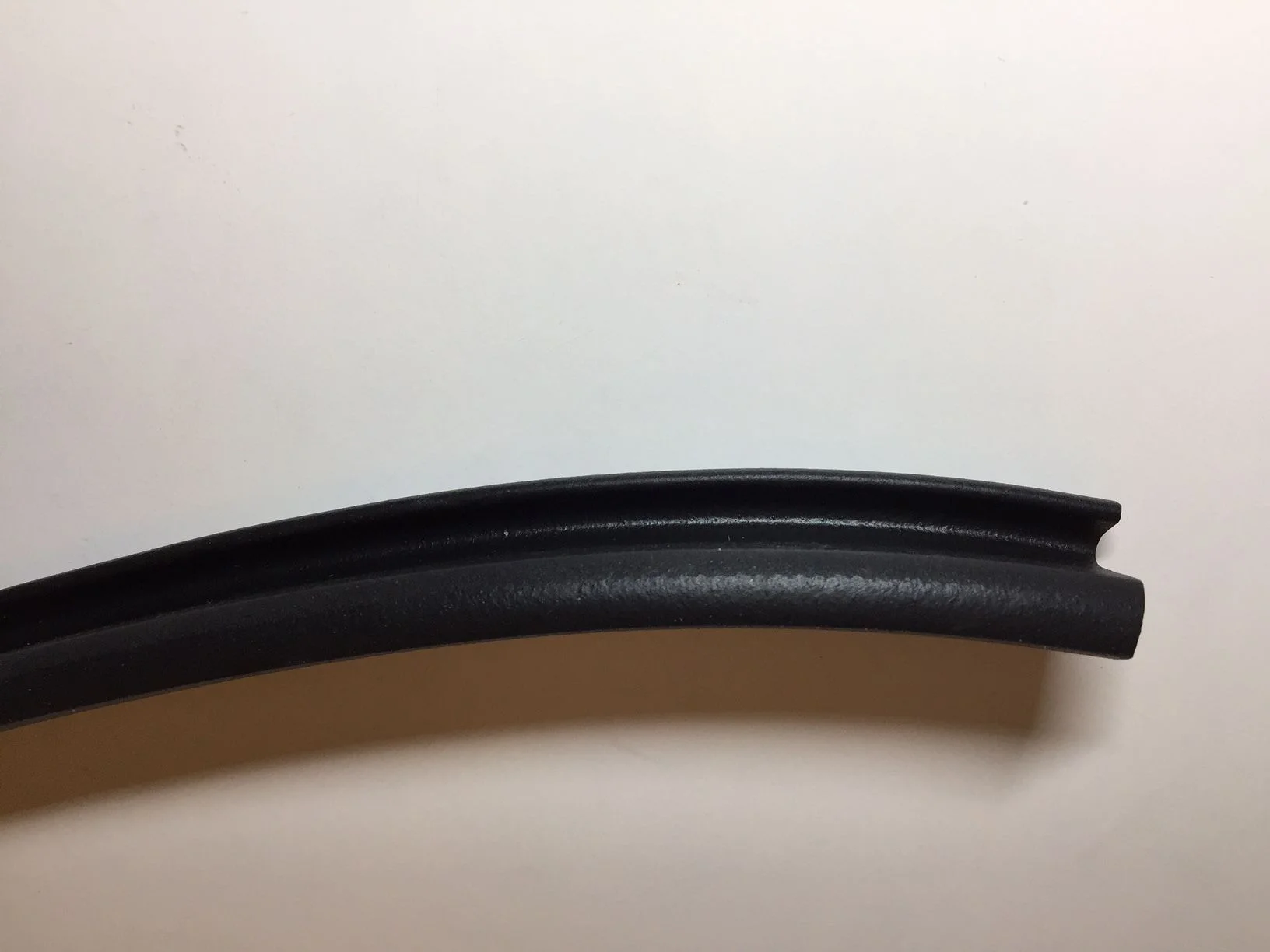

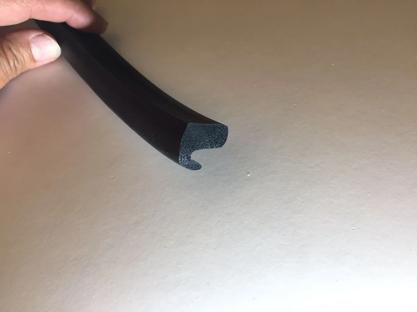

It's good that I checked here. It's also good that I worked on the vertical one first! I need a volunteer to test fit it. @Landpimp ?
Roger, let one of the other guys test it, I suspect they may actually get to it before I might ;)

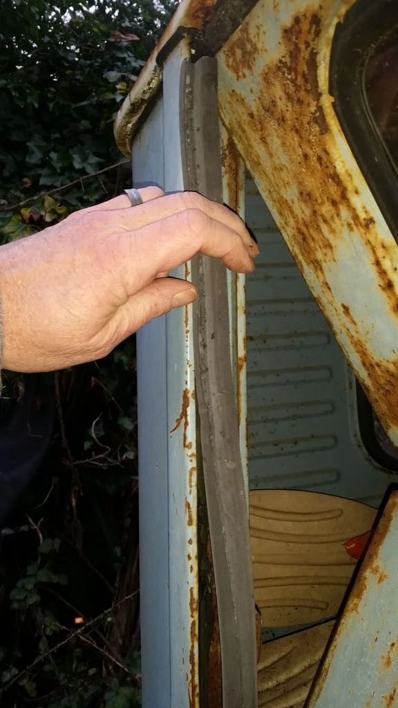

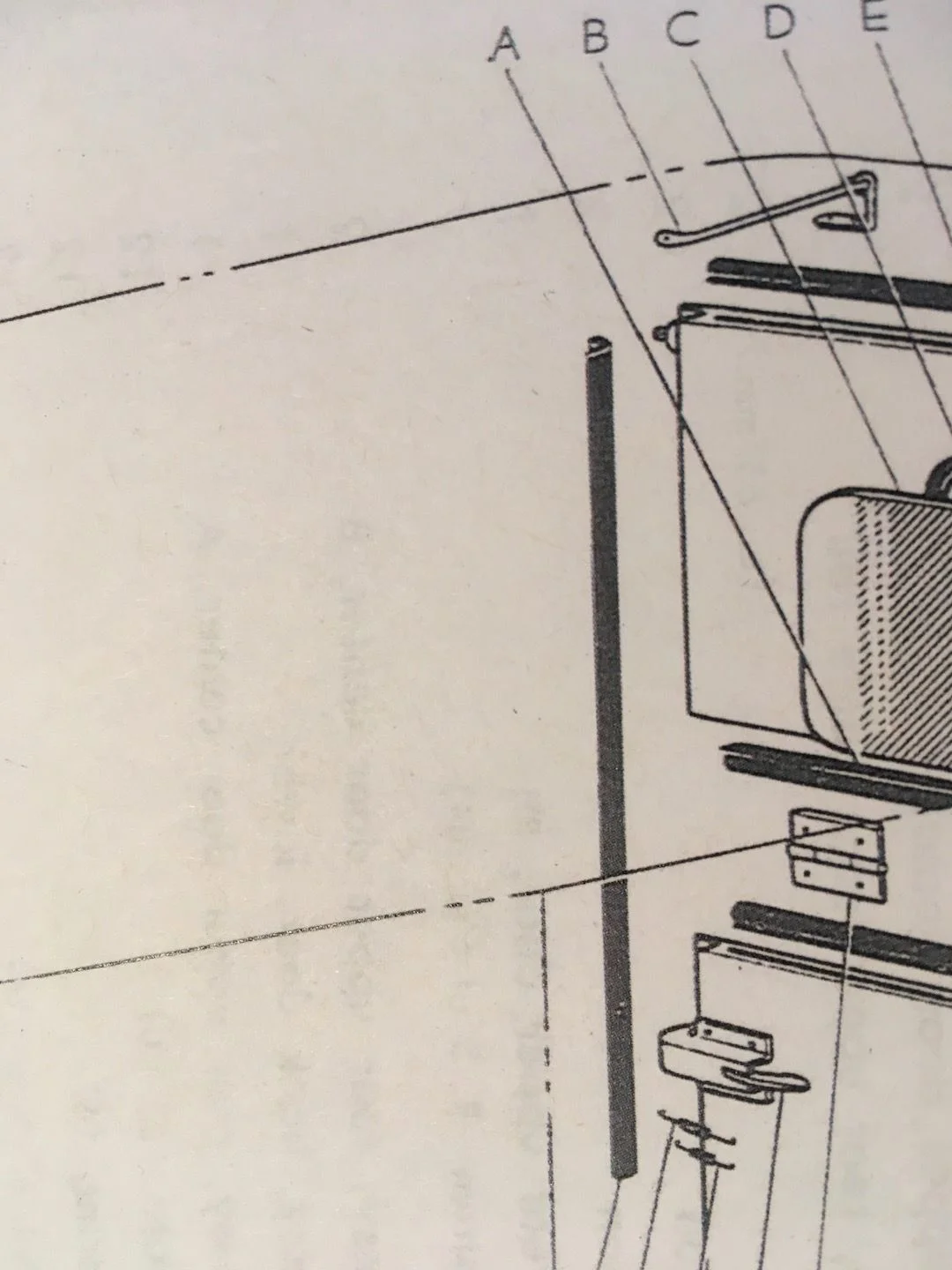

I got the sample from Racer. Out of four sets of early hardtop sides, not one of mine has a set of seals I can determine orientation from. I don't want to make any assumptions. Can somebody post a pic?

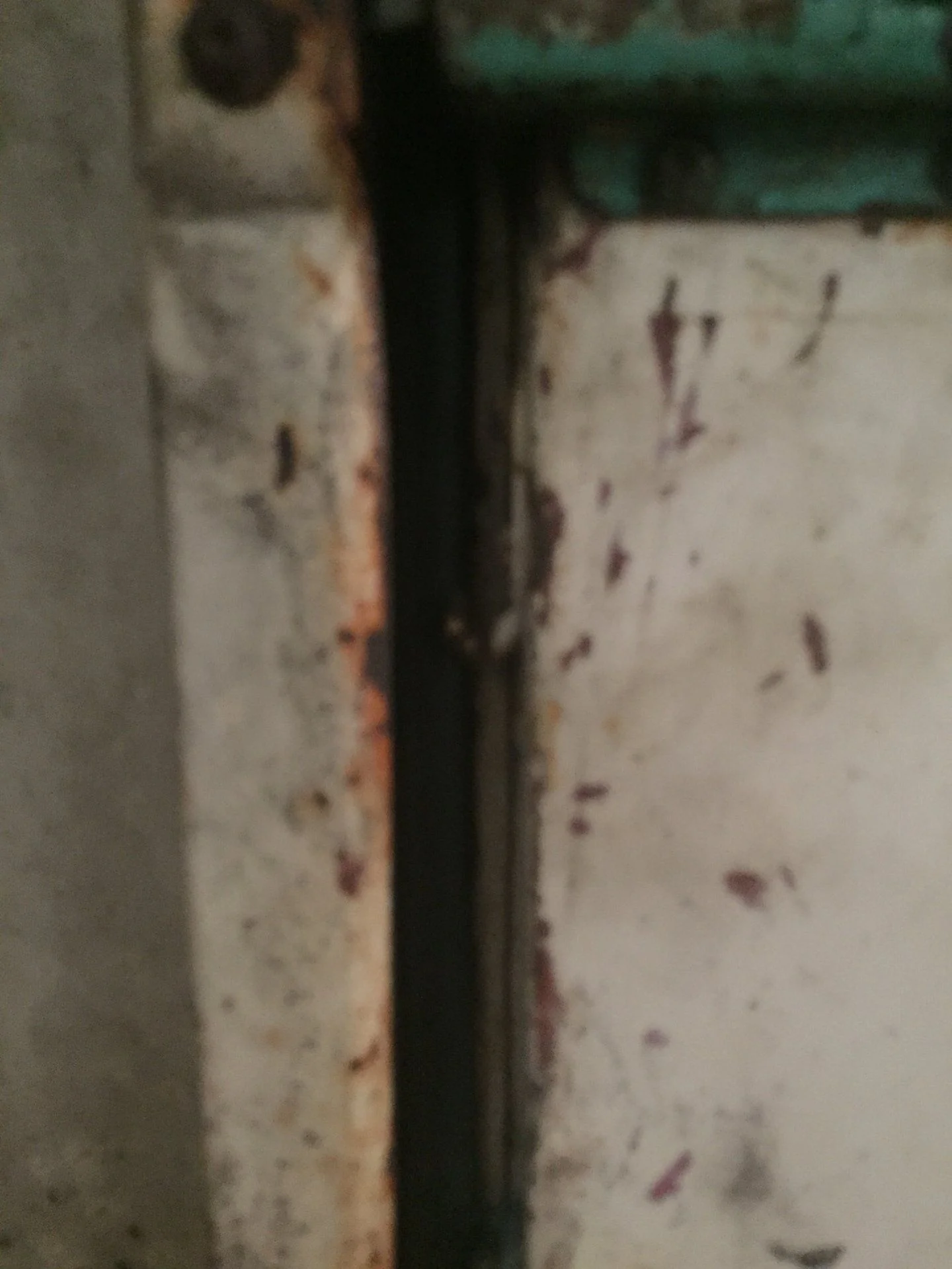

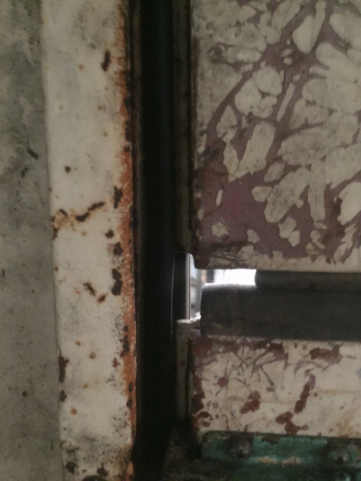

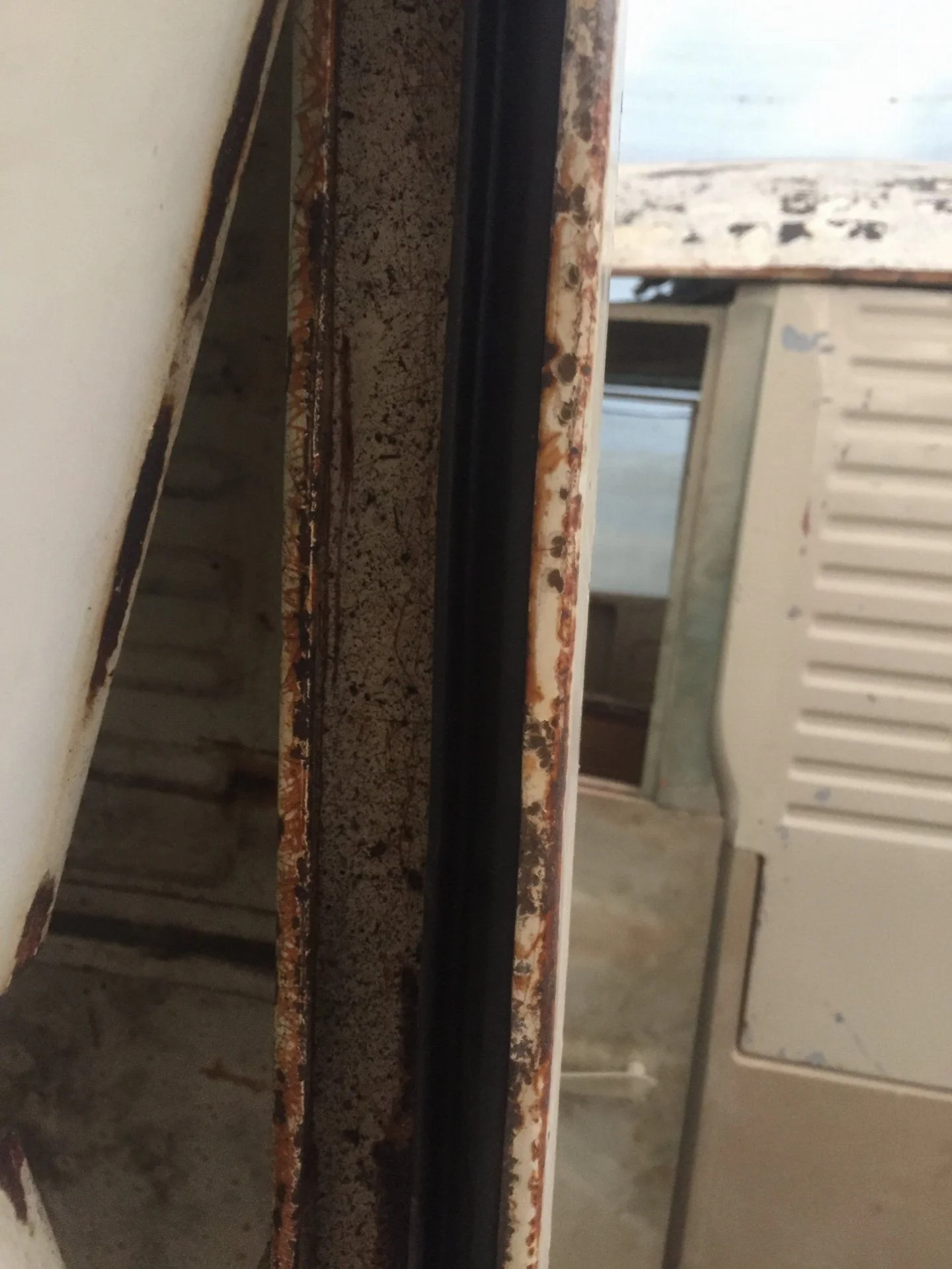

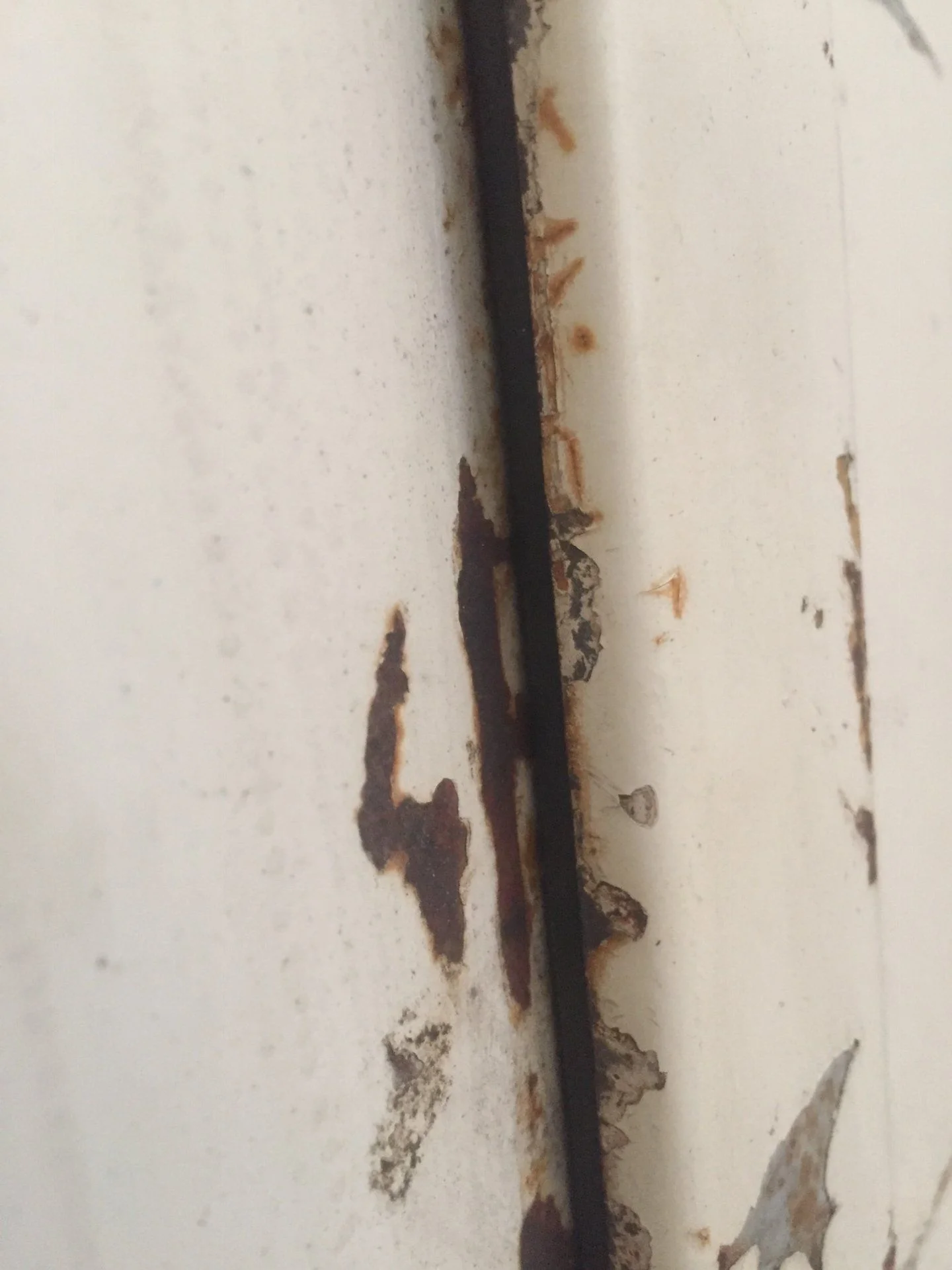

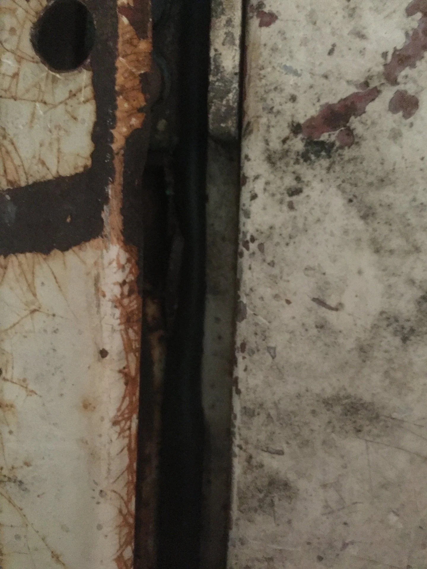

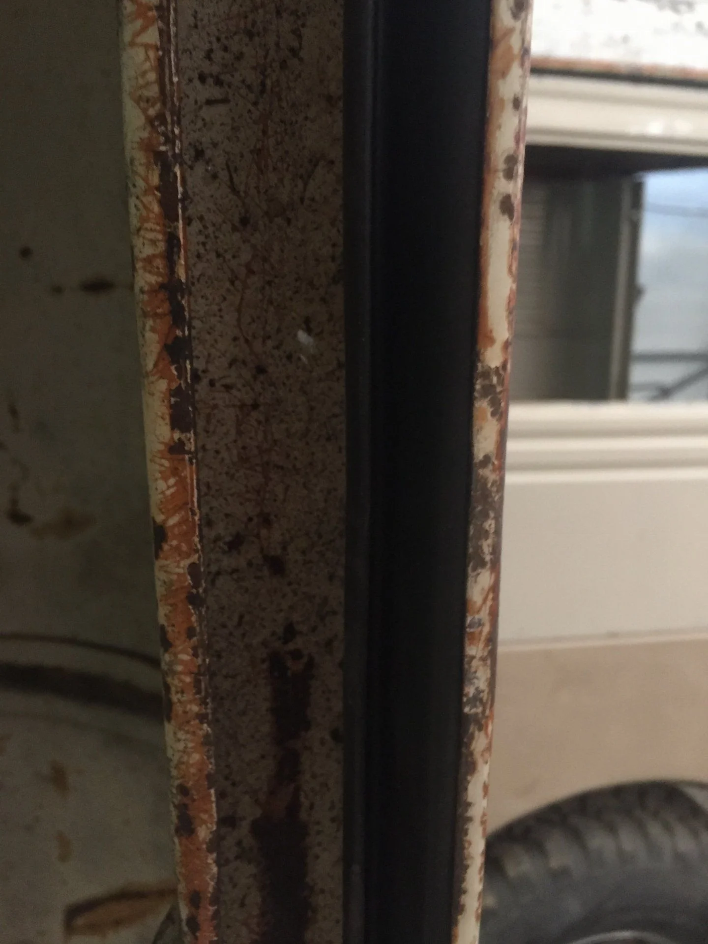

Sorry for the delay in gettin this done. I think I have the orientation correct. These seem to fit quite well.
It's a snug fit to install them in the channel, but doesn't necessarily seem too snug. That said, they may need some gentle pressure for a few minutes while the adhesive dries to ensure they're fully seated in the channel. This fit was done without gluing down since the weatherstrip fit snugly in the channel without it.
On the inside, the little lip catches the edge of the door well. The only issue I had was up at the top where the catch is located to hold the door open. Because it protrudes into the weatherstrip hannel, the weatherstrip gets a little squeezed and the lip doesn't seem to want to fold over the edge of the door like it does with the lower 90% of the door when you close it.
Thanks for testing! Can you show a pic of where the catch protrudes into the channel, and a pic of the squeezed area?
Wondering how does the original deal with the protrusion, since it's uniform throughout. Do you think a small cut will help?
