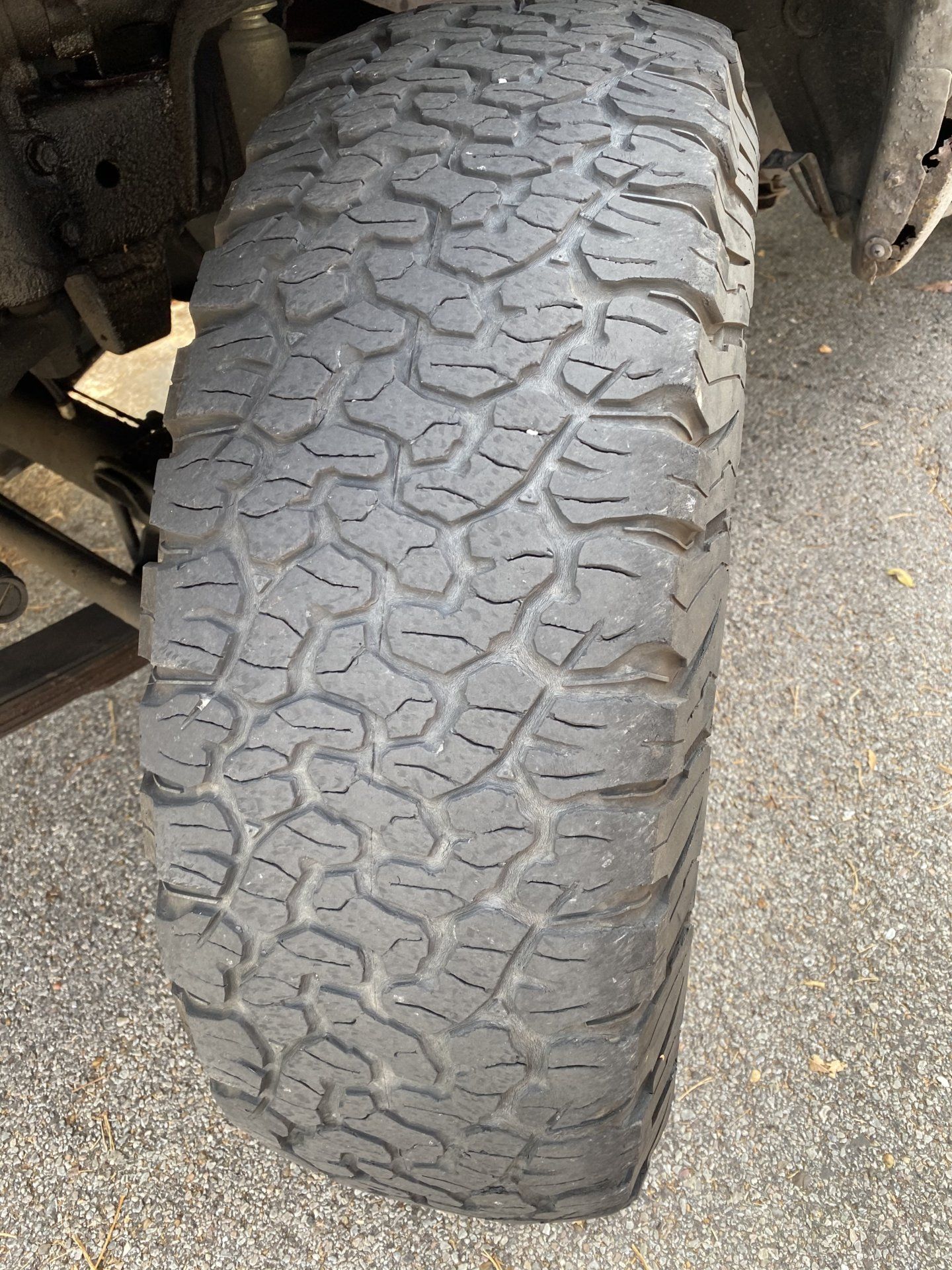

BFG KO2 Cracking at 10k
80psi - these mounted on a 1ton truck?
No. K2500 Chevy 4wd per the install and sidewall recommendation. "E" series tires. Why? Thanks.
was curious- on my Ram 2500 I dont think I ever ran the pressures up that high more like mid 60's- it drove/rode like crap at 80psi. But I didn't tow anything over about 7-8,000 lbs either.
The 80 PSI number on the sidewall is for max load capacity of the tire itself. For max capacity of your truck your pressure will certainly need to be adjusted. Without knowing the max GVWR for your truck, it's impossible to know the proper pressure, but I'd venture a guess that it's somewhere in the 45-50 PSI range? 80 PSI is guaranteed to ride like a brick, is totally unnecessary, and is likely causing improper wear of your tires. It should not however be the cause of the cracks you pictured - that's still an issue I'd take up with BFG.

Thanks for the info and feedback. Very helpful. While I do agree 80psi is high, it is what is suggested for the 17 in. tire (10 ply E series) load with the vehicle GVW and trailer GVW. We tend to spend a lot of time on highway so I like a stable ride while towing. I've experimented with 60-70 psi but do not like the soggy feel at highway speeds. Here's the rig. Thanks for your feedback!
Update - Spoke with BFG today and their position is since I put a 17 inch 265 BFG AT load range E wheels/tires on my 1995 truck that was originally spec'd for a 16 inch 245 load range E wheels/tires then they won't do a full warranty on the defective tires. They stated that the 1995 truck was not intended/designed for such a large wheel/tire combination and therefore the tires weren't designed for that use and therefore didn't perform as designed and was basically operator error. They still wouldn't comment on why the shoulder cracking happened. They still offered a "good will" customer assistance warranty to fund 70% replacement cost of the tires, but I would still have to pay for mounting, balancing and tire disposal or approx. $290.
I then talked with my local tire dealer and they offered to install for just the replacement cost of the tires and wave the mounting, balancing or approx. $230.
Needless to say I'm not pleased by this, but I will have the new tires put on for safety reasons. Let this be a cautionary lesson to all those that install no OEM spec tire sizes on your truck, Jeep, land cruiser, etc.......case closed.

I had a case opened with BFG about cracking on my 37x12.5R17s (on an FZJ80) where they made a "good will" offer as well, but the oversize nature of the tires was never even brought up. That's awfully crappy of them to use that excuse, because we all know (as does BFG) that it's a total load of BS. Can you somehow escalate the issue within BFG to get a more reasonable resolution? I certainly wouldn't settle for the current situation...

ADV- the excuse given from BFGoodrich could argued if you wanted to push. I had a set replaced under warranty at the 10k mark for a different concern on my LC that are also slightly oversized for the application and they never brought that point.

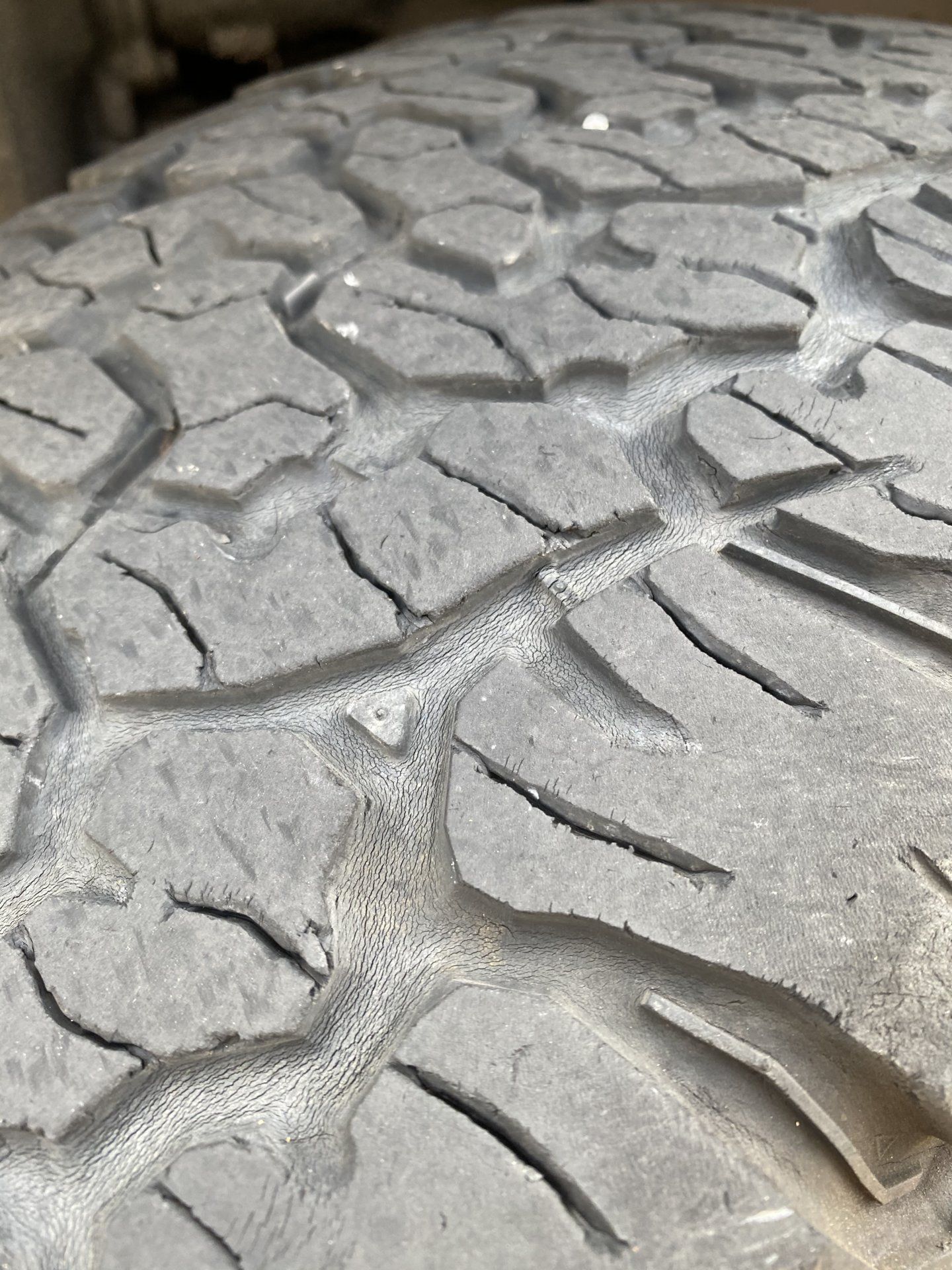

Just over 6000 miles on these. Granted I load my truck up quite often with my camper or firewood but that s*** shouldn't cause a crack like this. I'd like to say I sliced it on something while cutting wood, but none of the roads I've been on lately have been that bad.
Just over 6000 miles on these. Granted I load my truck up quite often with my camper or firewood but that s*** shouldn't cause a crack like this. I'd like to say I sliced it on something while cutting wood, but none of the roads I've been on lately have been that bad.View attachment 2094086
I'm no tire guy, but that sure looks like a slice/physical damage rather than a crack to me...
Probably due for an update here. After the original set which had the cracks that kicked off this thread were replaced at full amount (less install and balance) at 10k I have driven the second set for about 40k miles with absolutely zero issues and a good amount of tread left. AT KO2's have been great tires for me (despite the original incident).

30,000 miles and purchased in March 2017. Not happy about these cracks in between the lugs.
That wouldn't bother me at all. I only hope to get 30K out of my KO2's..
