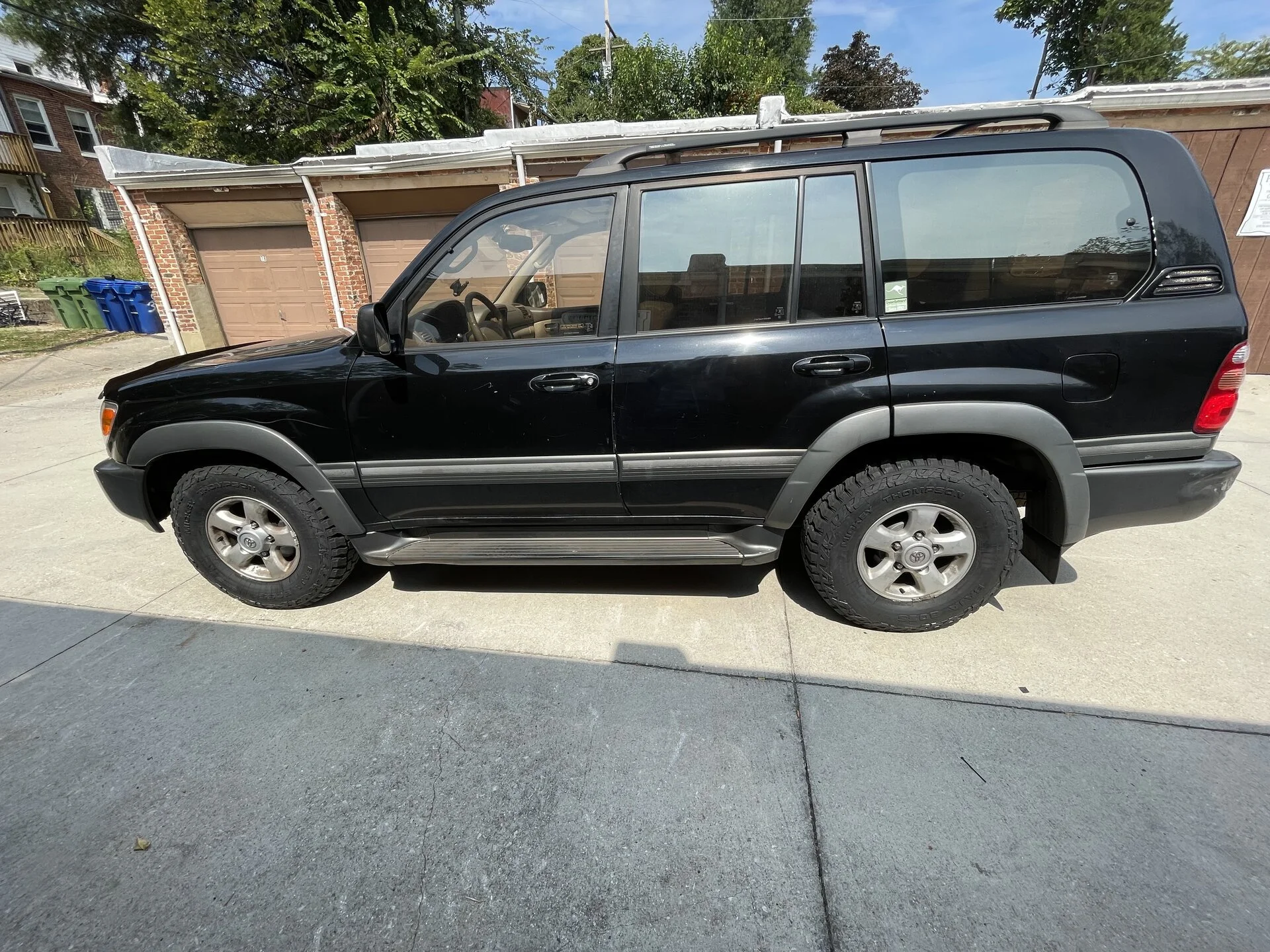

Currently I'm running some Toyo Open Country non-all terrain tires on my 2000 Land Cruiser, which need replacing. I really would love to buy some BF Goodrich T/A KO2's, but they might be a little too rich for my blood. I went ahead and did the research on the tires I'm currently considering, Mickey Thompson Baja Boss A/T's. I hope someone will appreciate the research I've gathered and compiled below. I would REALLY love to get a hold of some Mickey Thompson's, but they do not run in the exact stock tire size for my truck, which most of you know is 275/70R16. I hate to deviate from the stock tire size, but I REALLY like the look of the Mickey's, and the pricing vs the KO2's. I've also listed the specs of the Toyo's I'm currently running on my LC, for giggles. From research, it sounds like the Mickey's do really well in the rain, which it does a lot of where I live.
I've considered that deviating from stock tire size may come with its consequences. I ask the forum to view the write up below, and consider it as though these were the options you were looking at for your own LC. What would you pick? As you can see from the specs below, deviation from the stock tire size would appear to be somewhat minimal. Do any of these particular options hurt my LC?

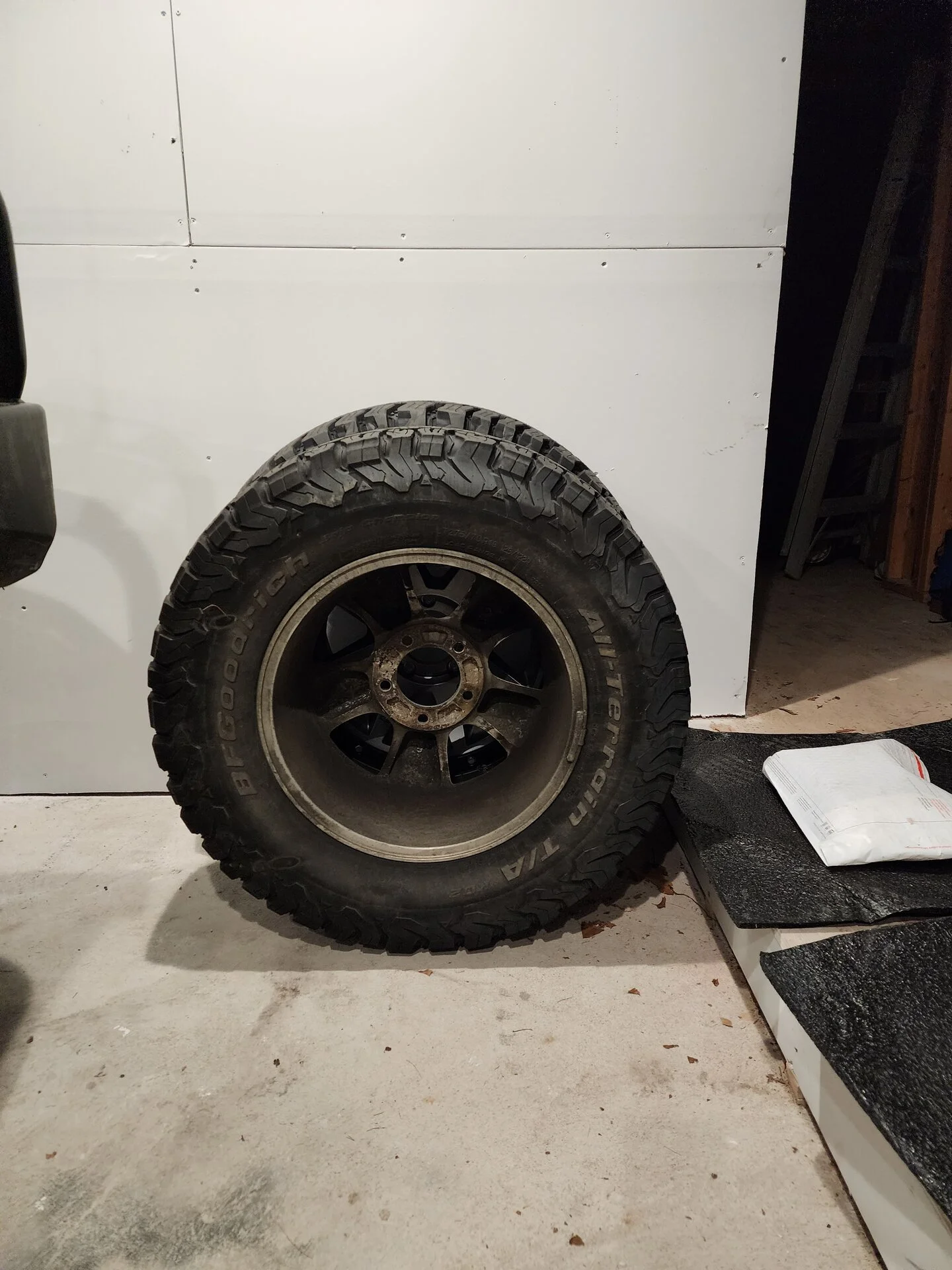

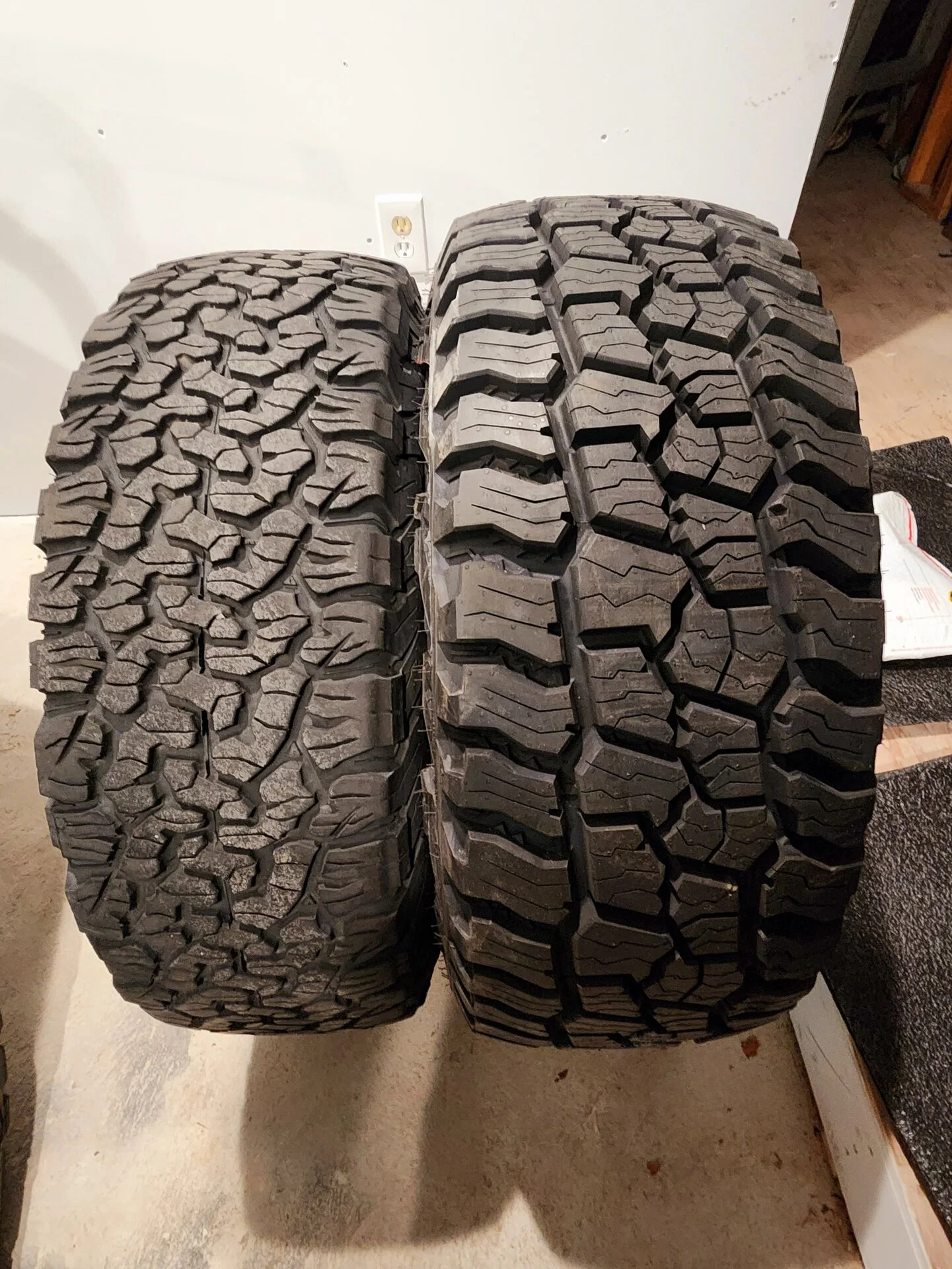

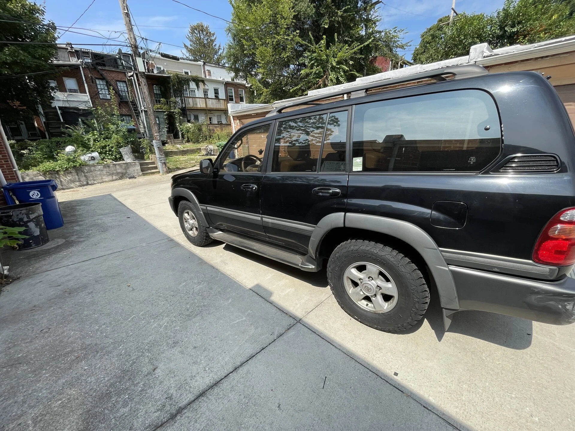

I've decided I'm going with the Mickey Thompson's 265/75R16 116T. These are the 4th option in the list I made in my first post of this thread. I have the advantage of an upcoming Labor Day sale and I can't pass it up. I'm sold on the asymmetrical design combined with all 4 tires costing under a thousand dollars. I'm interested in the specs on these specific tires for the MPG benefits, without losing the A/T tire benefits like the nice aggressive look, beefy side lugs, and capability all wrapped up into one package. Most importantly I know what I need from the tires, and I'm just looking for a good tire for in the rain, affordable, and can do some light off roading from time to time. These are perfect for me and still made in the USA.

I ended up going with the Mickey A/T Baja Boss. I’ll post how my test went drive went later. Drop dead gorgeous. #4 on my list

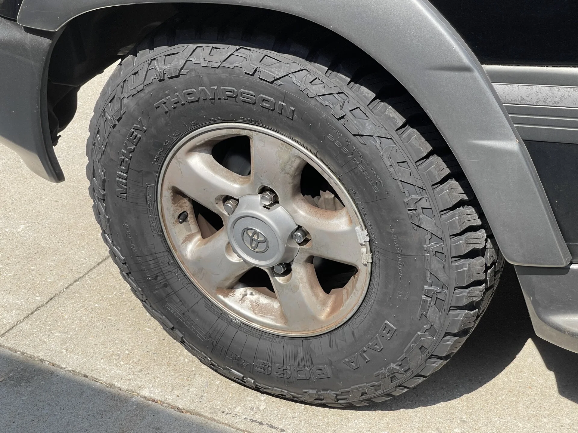

As anyone reading this thread knows, I've gone ahead and chosen the M/T Baja Boss A/T tires. I was very close to getting the M/T EXP's and I also was very close to getting the BF Goodrich. Very close. What sold me is the asymmetrical design of the M/T, the ease of being able to rotate the tire to anywhere on the truck I please, the PRICE, the rain performance reviews, light weight, good looks, plus she's made in the old US of A. I think the EXP's would have been a great choice too, but I missed the deadline for getting them on the Labor Day sale. I might of bought them even though they are not 3 peak snow rated. Hearing once or twice about the BFG's not being good in the rain was the deal breaker for me.

It’s unobtrusive, if at all. The tires are very comfortable.
Just did my first drive home in torrential rain downpour, and the tires were phenomenal. I never once felt like I was not in contact with the road. Mickey Thompson A/T all the way. Glad I didn't chase after BF Goodrich just to have the name and pay more.
