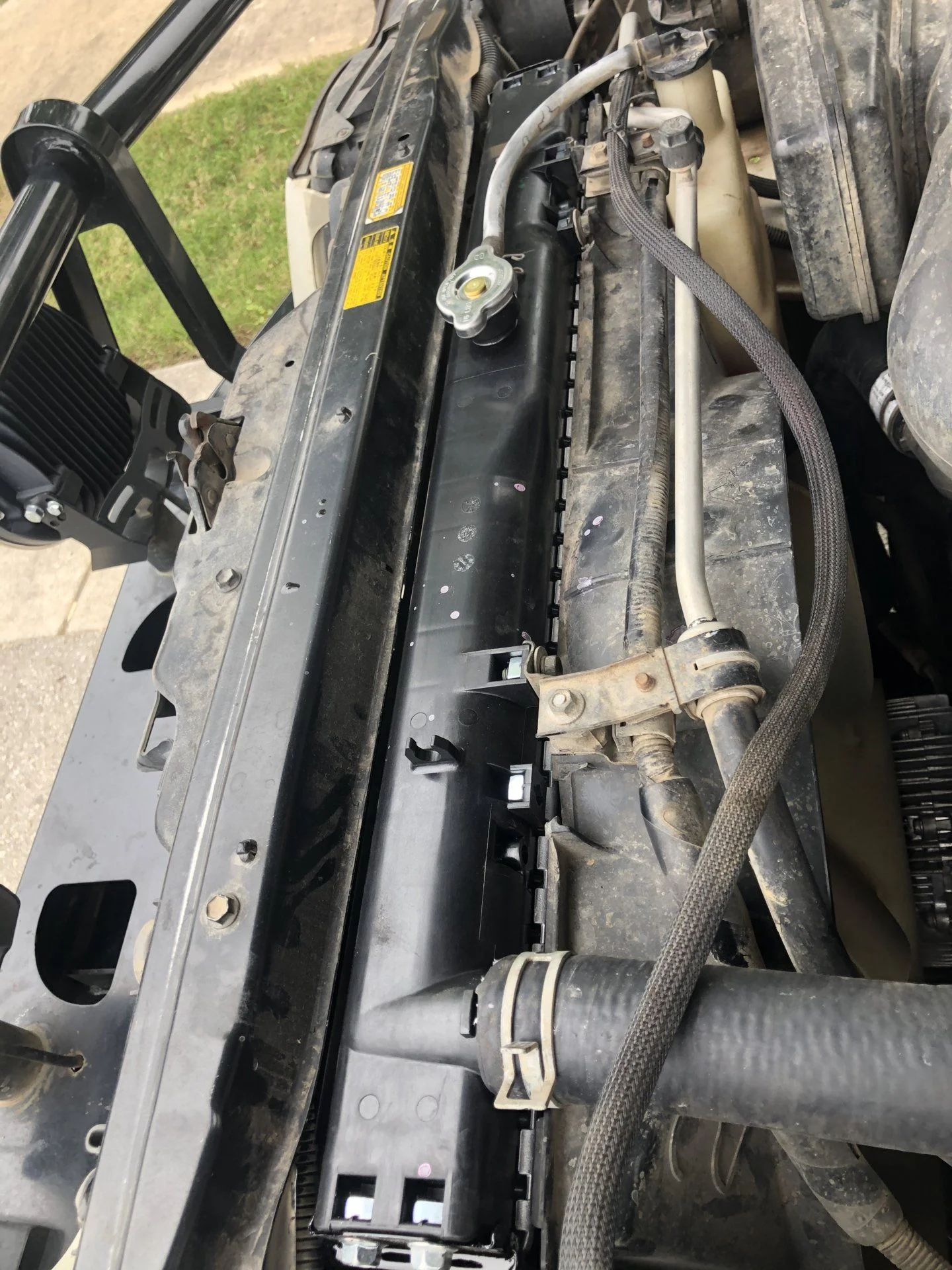

Well, I finally got it all back together (simultaneous with TB job so took extra long). The CSF radiator is in, fits perfect, continental hose on, mcmastercarr clamps, no issue, no leaks. Originally installed with no thermostat, filled with distilled water, ran the car, drained, and then x2 more times, crystal clear coming out before I filled with Zerex (and of course put in the new thermostat). So between the CSF $130, Continental hoses $30, and McMastercarr clamps ($30). got a new radiator and hoses in for ~$200. I think thats pretty dang good. Only thing I was a little nervous about was how tight to do the McMastercarr clamps, partially because earlier I broke the thermostat inlet and worried about tightening too much and breaking a pipe but I needed that style clamp with the aftermarket hoses to make sure they dont leak.

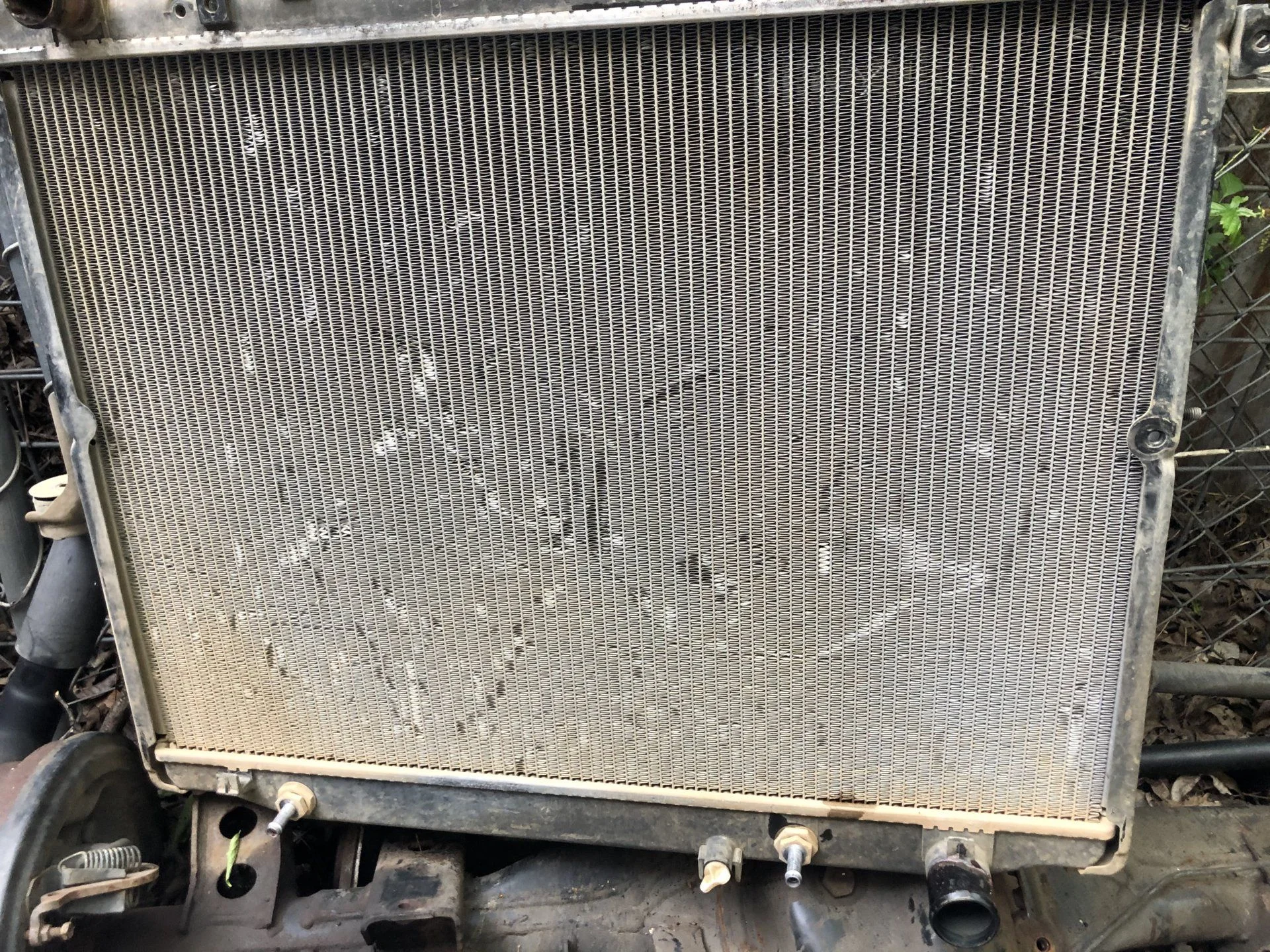

Here's the before situation. You can see on the lower left at one point I put the wrong screw (too long) into the fan shroud and went right into the radiator, also making a crack beneath between plastic and aluminum.

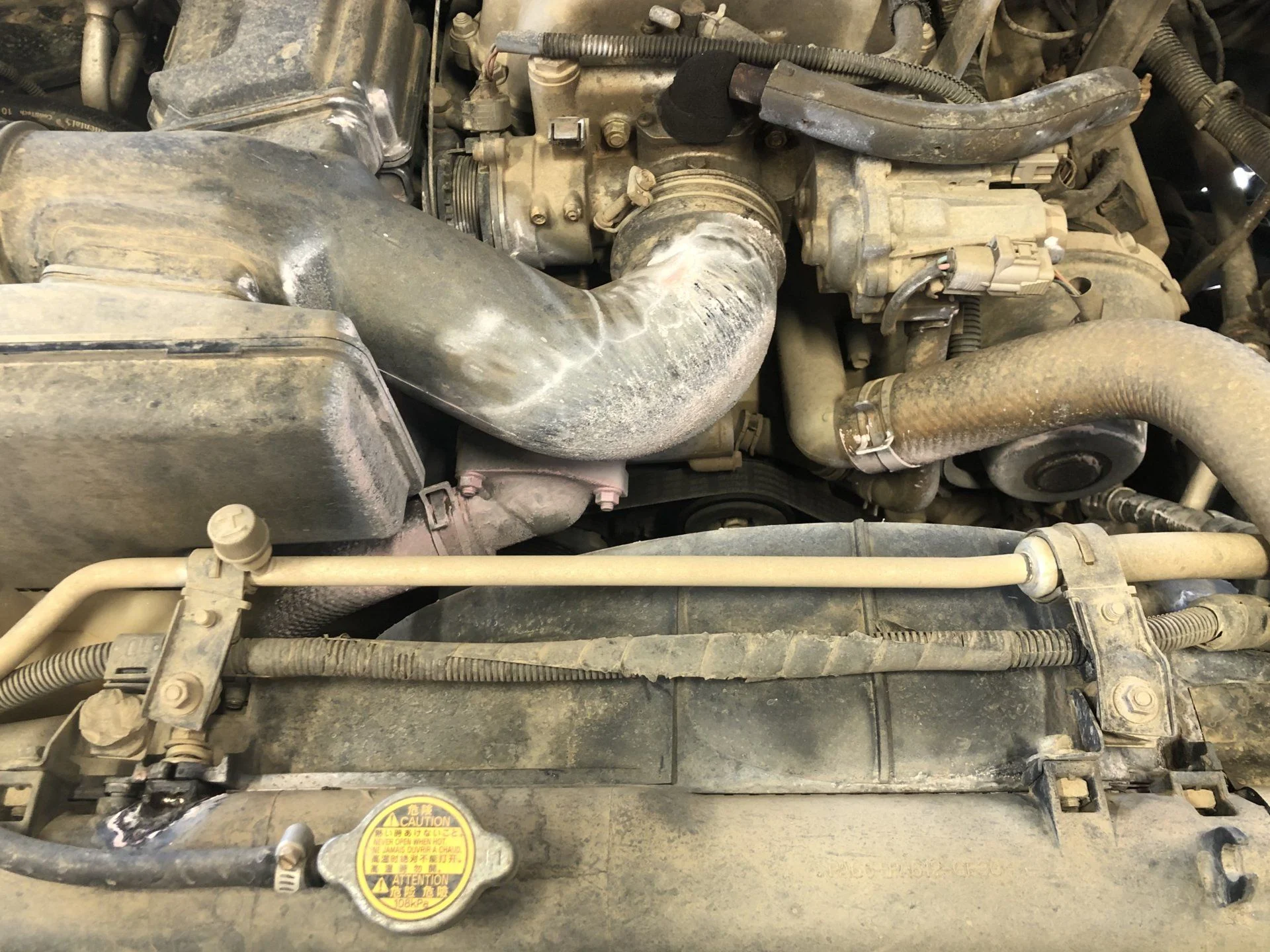

Try to patch with jb weld, didnt let it dry out enough before adding coolant so it always had a little pin hole. Coolant would drain down fall over the fan and blow back at the drive/timing belt, not good obviously but went on for 7 seven months without a hitch other than adding 2 gallons of coolant over that time period topping it off.

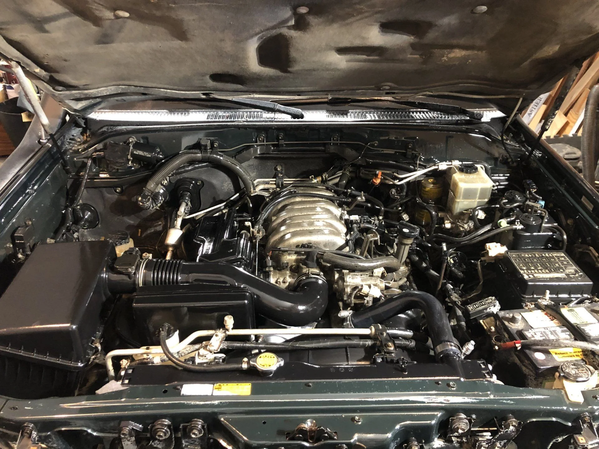

I used some hose and plastic conditioner on them, makes em look real nice. The fan shroud is new as well because I broke the right upper bracket and then cracked the old one in half replacing the fan clutch seventh months ago.
LOL interesting that we got the same pin hole leak but on opposite sides, this must be where they join the plastic pieces together to make the top. the weak link of it, i don't think a solid piece would have a leak like that.

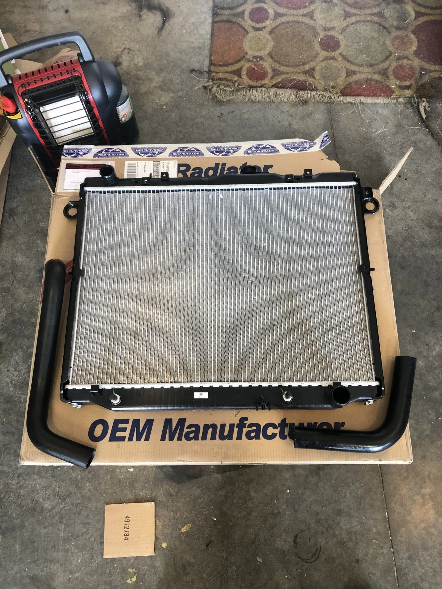

Had mine replaced with OEM. However, didn’t get the foam strip between the top of the radiator and the front framing. Anyone got a part number for that?

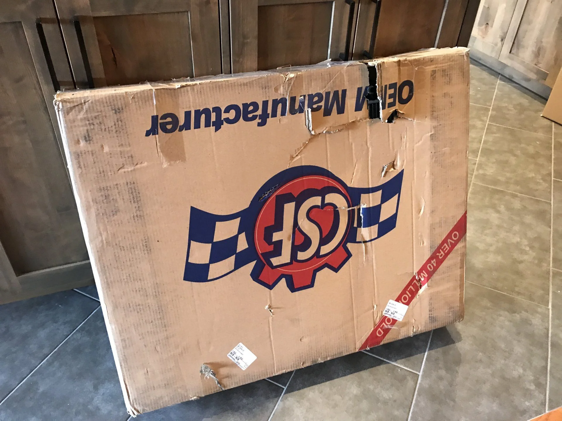

Need help from the community. Ordered the CSF from Summit Racing as others have done. The box showed up pretty banged up and clearly was repackaged with additional packing tape. I called Summit who offered to take it back but asked that I test it first. My question is what damage do I look for on the radiator itself and/or how do I test. This will be my first radiator job so complete novice here.
Check the fins (small metal blades on both sides) and make sure they are not bent or disturbed. Also look at the top, bottom and sides for cracks or appearance of use/damage.
If there's anything concerning I wouldn't waste the time installing to uninstall.
I did this for the first time and it wasn't very hard. Just take your time.

I just called Summit and requested a return and replacement sent. Fins were bent and given my inexperience with radiators and the pristine pictures others have shown of CSF radiators I didn't want to deal with the uncertainty. New radiator is on order and Summit said to hang onto the old one for 10 days and then junk it if I don't hear back from them.
