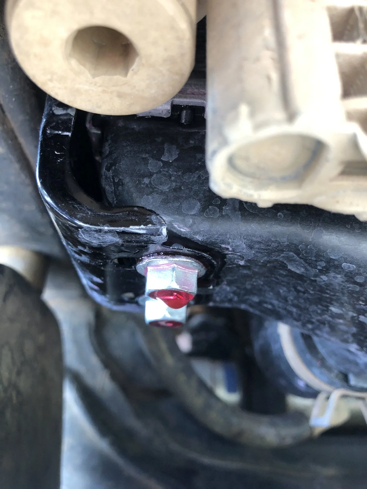

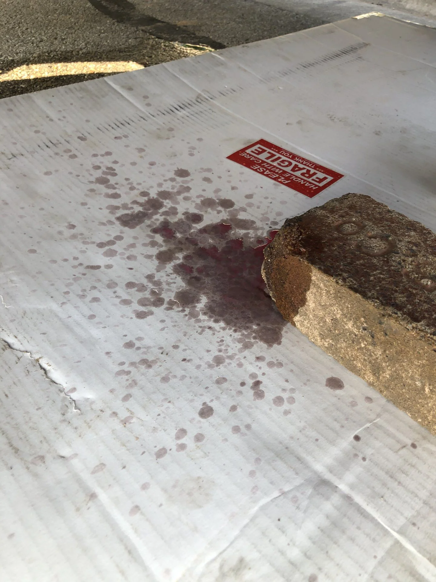

Well, that didn’t last long. CSF made it 5 days before springing a leak. Traced the source to just above the bolts where there is a small pinhole where the leak is coming from. Clear manufacturing defect. Going OEM now and not recommending CSF radiators.

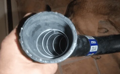

Side Question: Is anyone using a return hose spring?
Article: 9 cooling system myths and and mistakes and why to avoid them.
Anti-collapse spring.

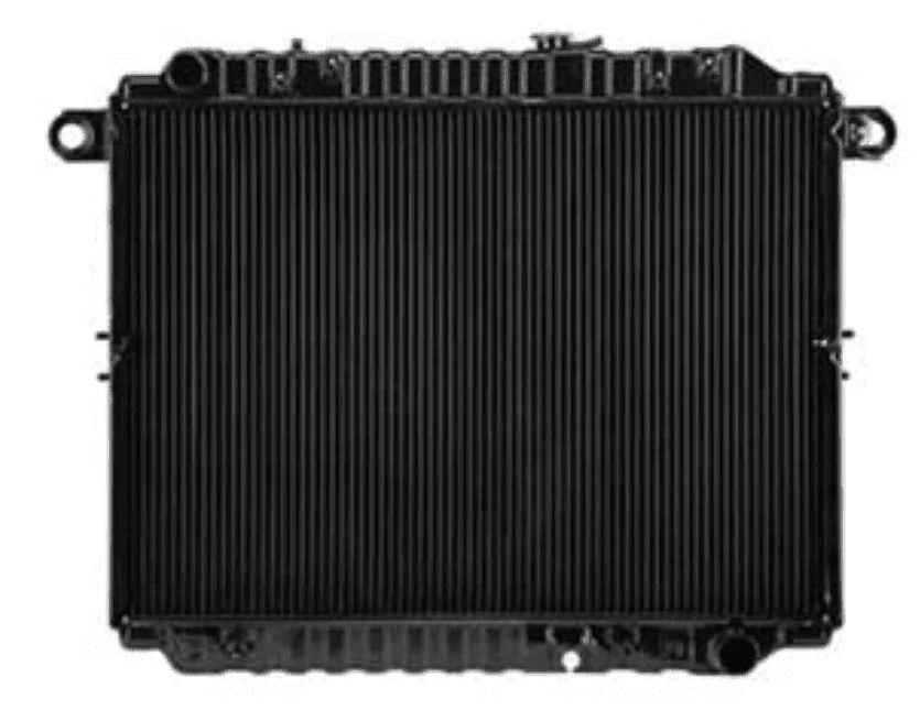

Anyone have experience with the Denso 2213128? I know it has been asked before, but I never saw an answer. Based on the specs, it looks like it might have the thicker cores as well (listed as 1.937"), similar to the TYC. It's tough to tell the material based on the pictures though; it looks like it's all metal, without plastic tanks. Also can't find a solid answer on if it's brass or aluminum. I'm in LA and plan on going to some hot climates for trips so I need all the cooling I can get.
Summit Racing says it's a plastic tank with aluminum or copper core.
On a side note, who would have thought buying a radiator would be such a crap shoot...🤷‍♂️
Yeah I saw that, but then the RockAuto page lists it as "Aluminum or Copper Core", and it REALLY looks like metal to me in all the pictures.

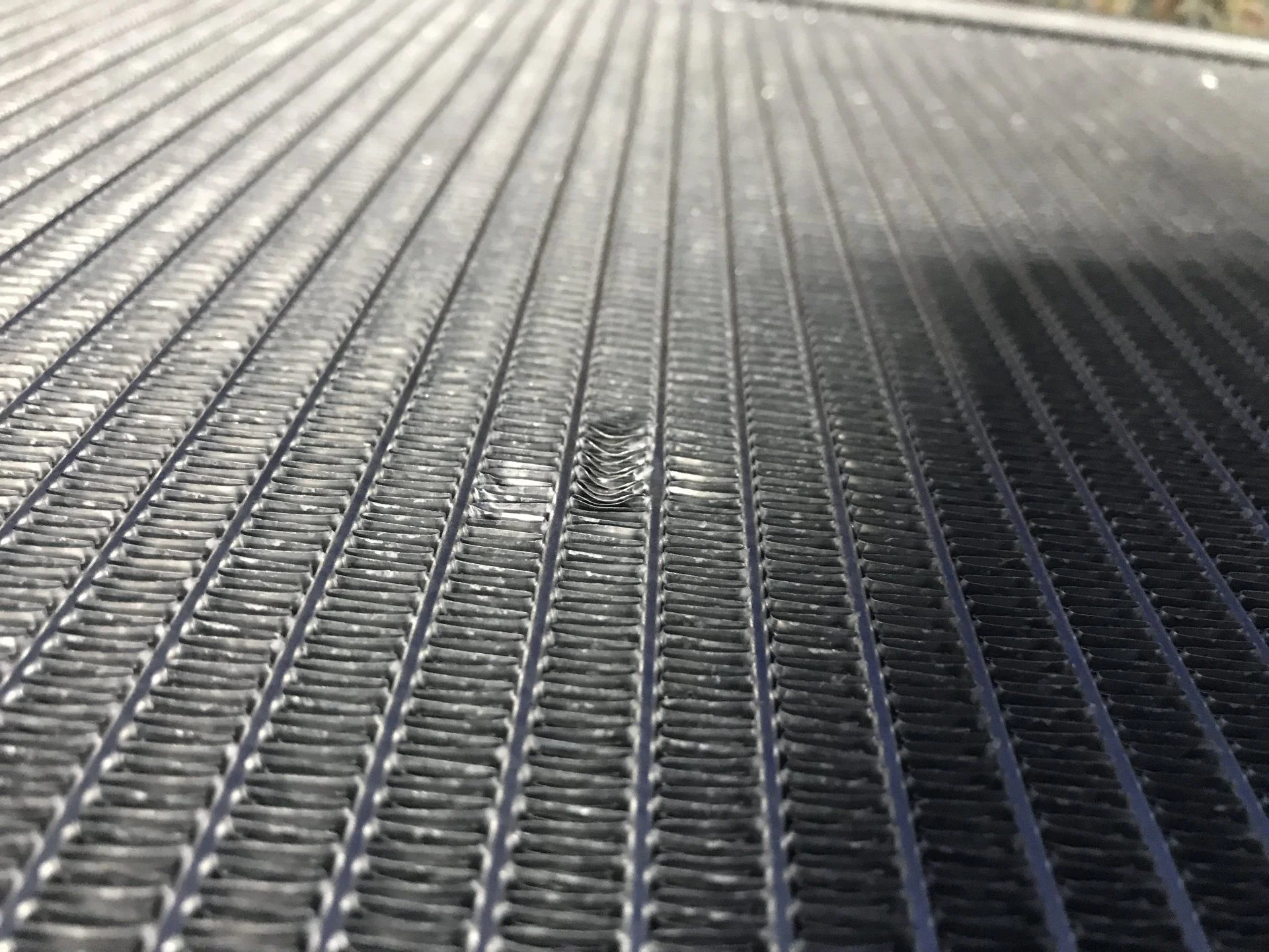

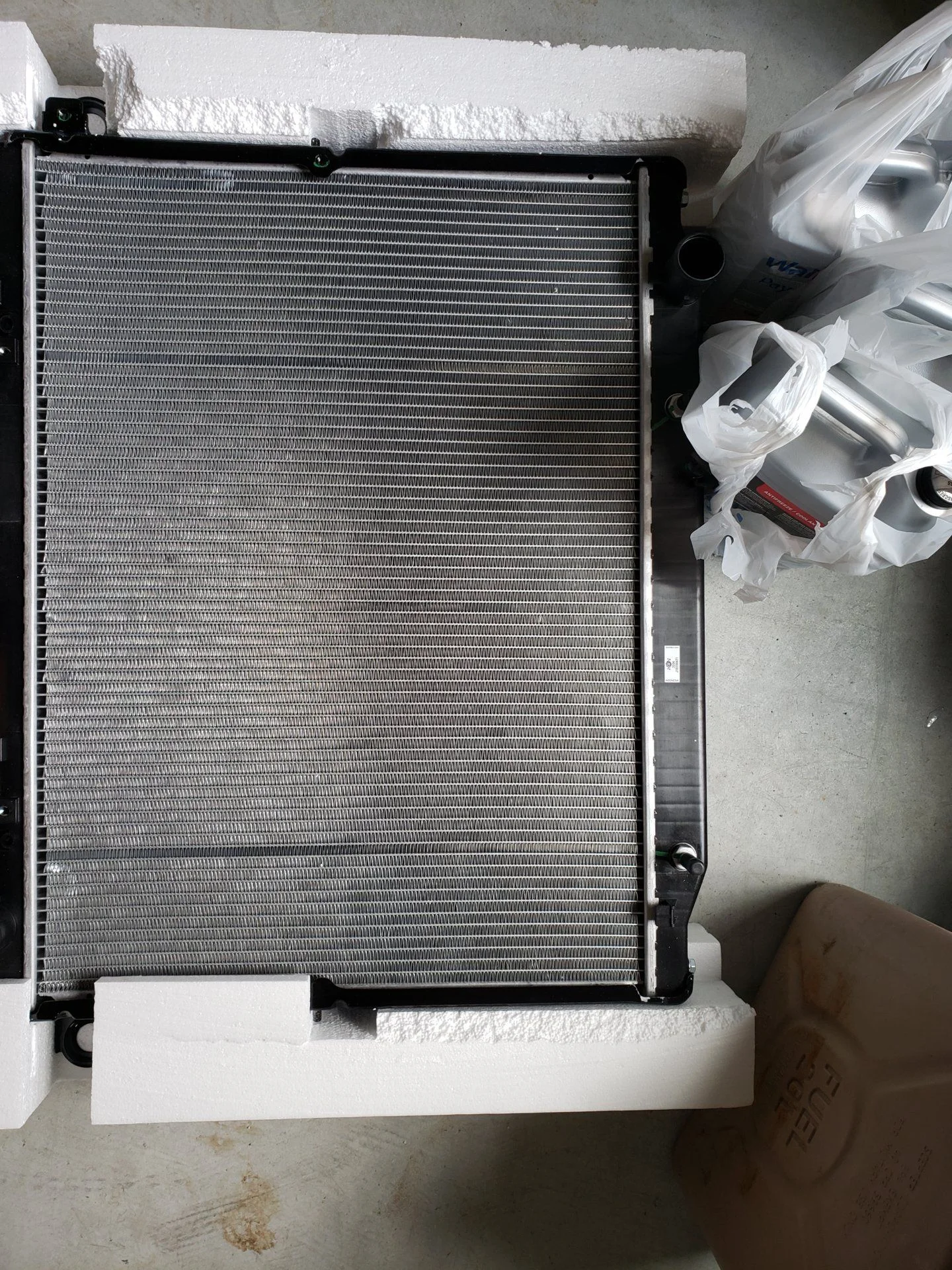

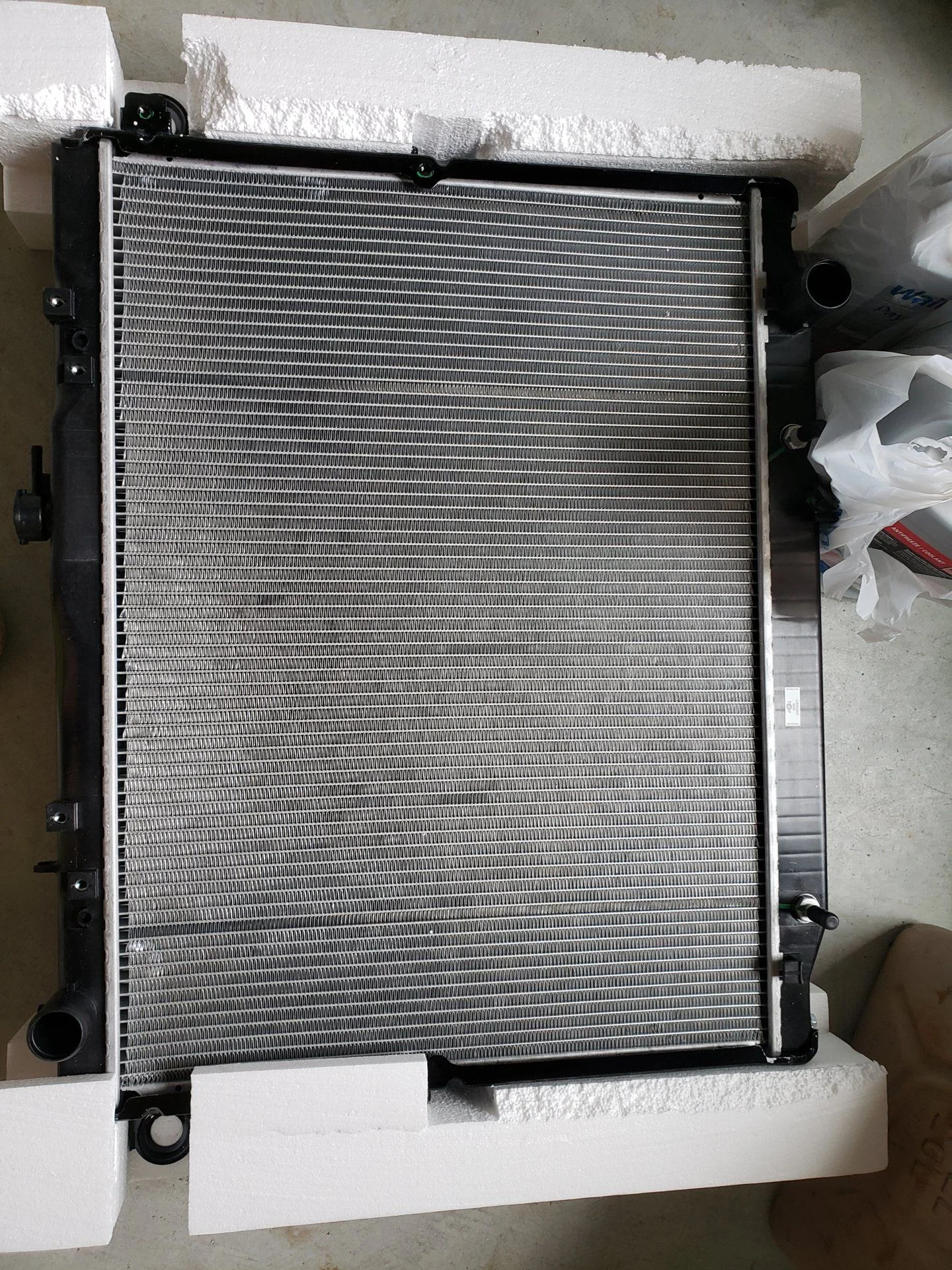

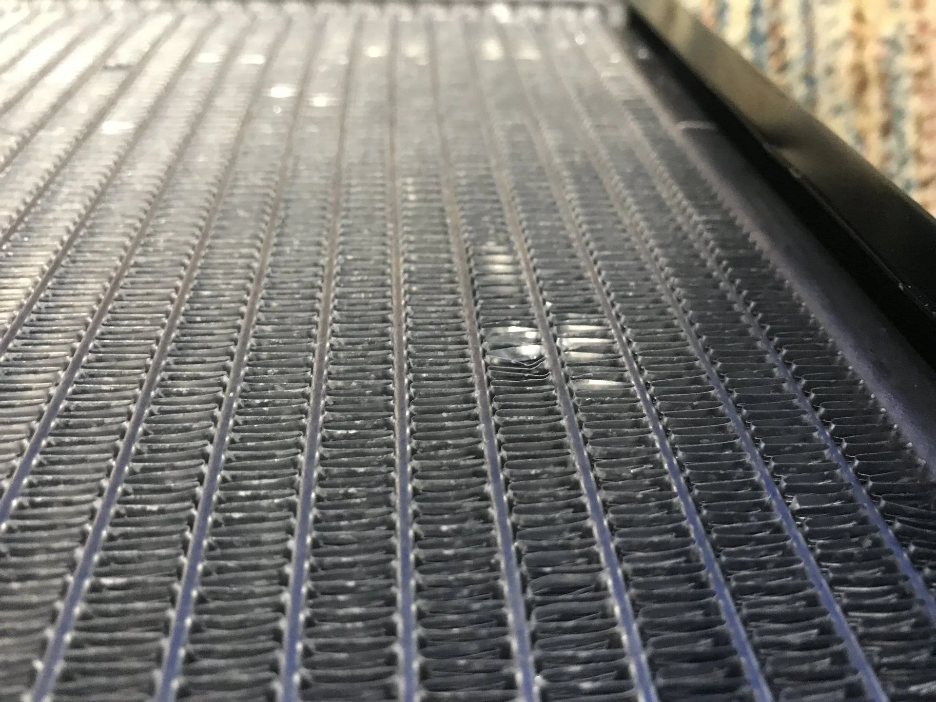

So second radiator arrived. Purchased from Summit, drop-shipped from CSF. This box is at least new unlike the first one sent which was clearly a repackage. But the packaging is still damaged. Multiple places have the fins bent. Plastic top and bottom look fine and where far better protected by the packaging.
I'm still at a loss for what is okay in a radiator and any help is appreciated. Return this one and purchase another from somewhere local? This is okay and some bent fins are normal? Help please.
