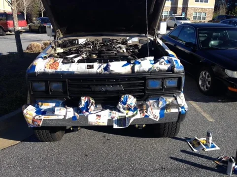

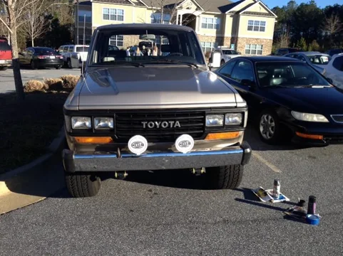

Parking Lot paint job
20$ for a can of primer, paint, sand paper and Roll of painters tape...magazines were free...Touched up around the Toyota letters with Q-Tips, and now no more chipping chrome!
Looks good. But why didnt you just take the grill off?
