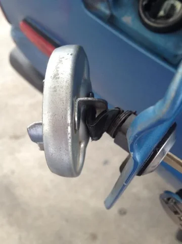

So I've seen the post for putting a zip tie on the gas cap. Worked good. My zip tie broke the other day and then I realized this:
We are all silly. Toyota beat us to it!
