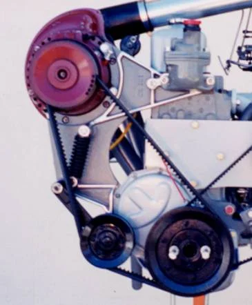

To run a supercharger would be pretty damn involved. There is plenty of room for a centrifugal, but the drive system would be really hard to figure out. There is not a lot of room in front of the engine, and there are accesories all around the front of the motor. You might be able to remove the smog pump and put one there, but it would be tough.
Be realistic about what you want, youre gonna lay out a bunch of cash to build a super 2f, and when youre still slower than almost everyone else i bet its gonna hurt a little bit.
I never said a S/C would be easy, but it would put the power where you'd want it with the F engines. Where the smog pump goes is sorta where I was thinking, but the intake tube routing would be interesting, then again, so would a turbo's.

Did you miss the pic on the previous page?
Which pic? I wanna talk about superchargers:bounce:
If it was a good idea before, was it proved wrong? Shorten engine life? Is my thinking all wrong?(prolly) Paxton was THE name in supercharging. Wha' happened?
Lotsa threads on turbocharging......none on supercharging?????? Me asks why?:doh:
