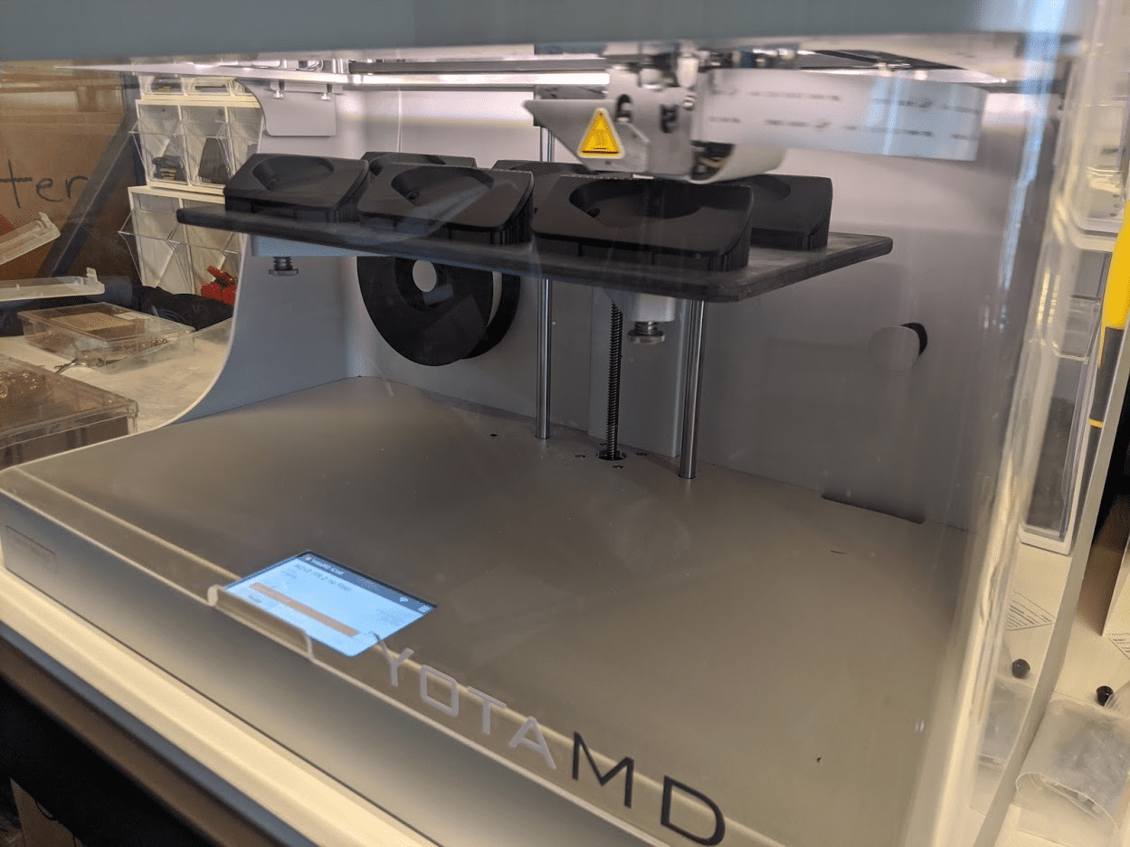

First mass production batch of M2V2 faceplates mid print in the picture below. They're all done now and headed to @BenCC for final kitting and then shipment out to the first round of customers. Thanks for your support all! I'm really excited about this product. I think you'll love it!

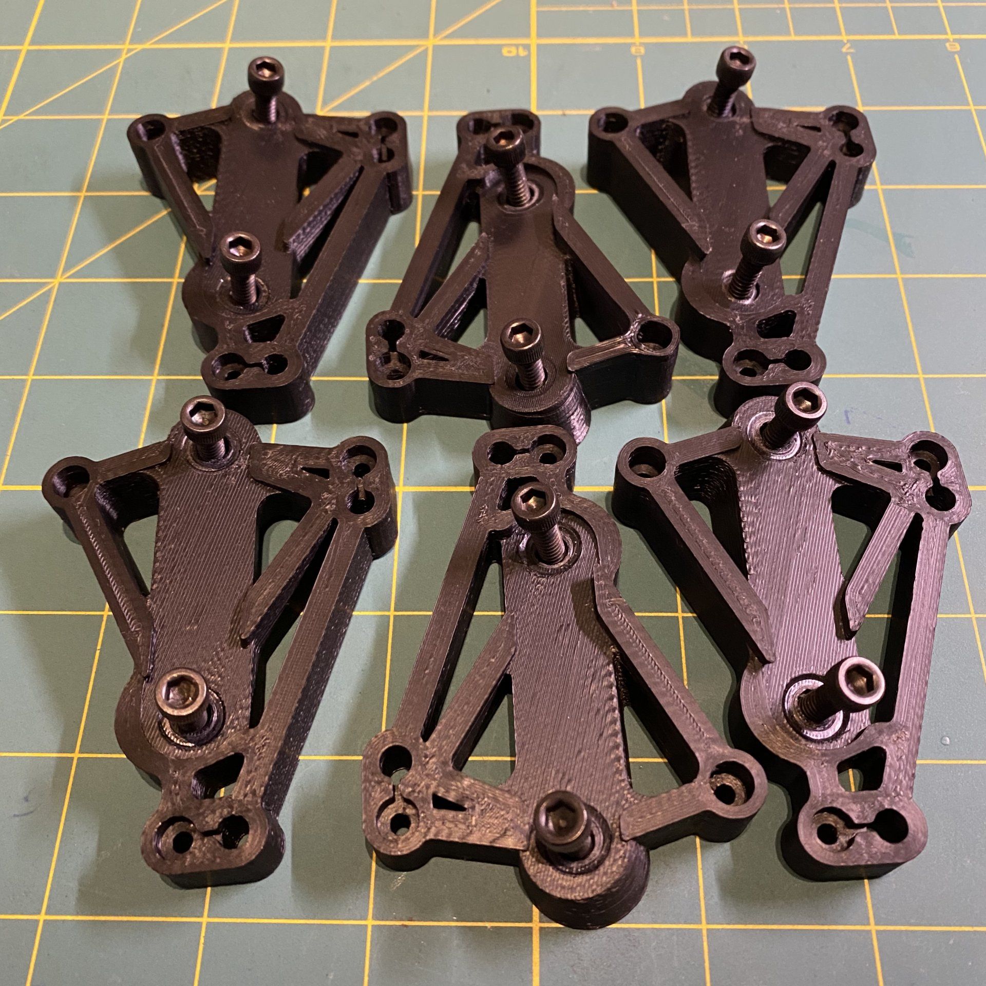

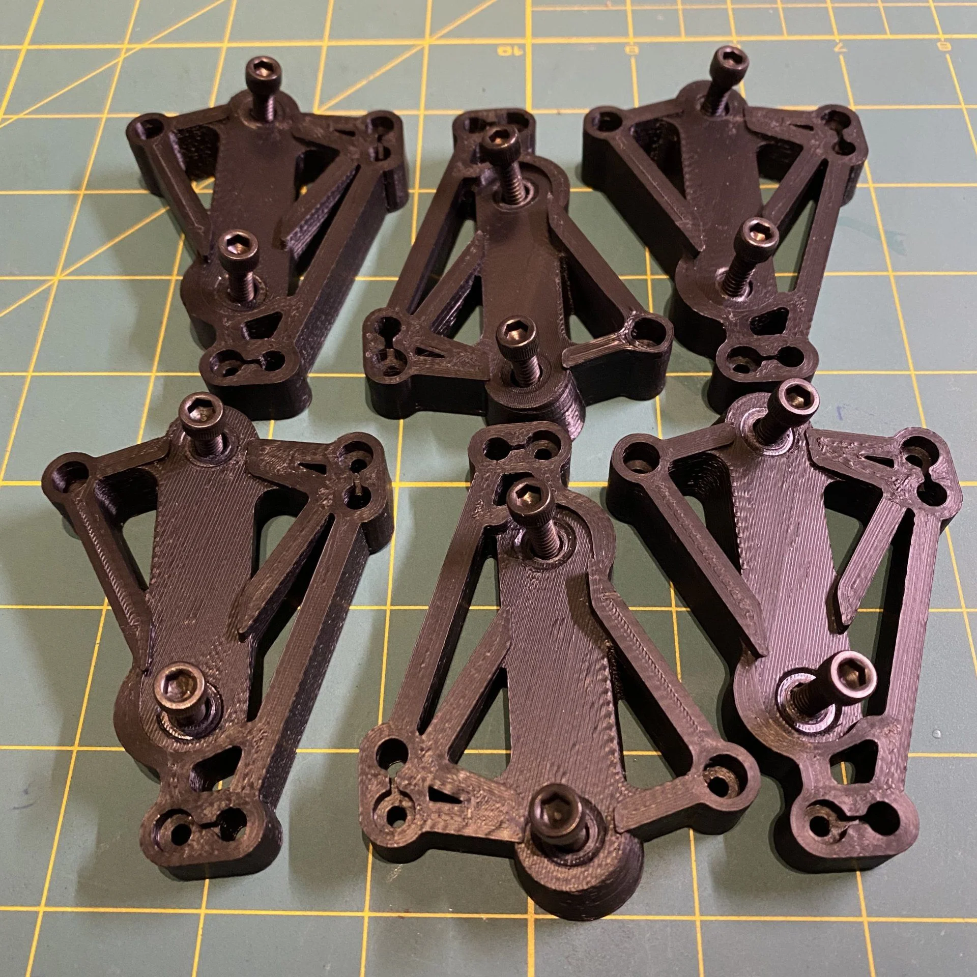

Some of the backing brackets for the first batch.

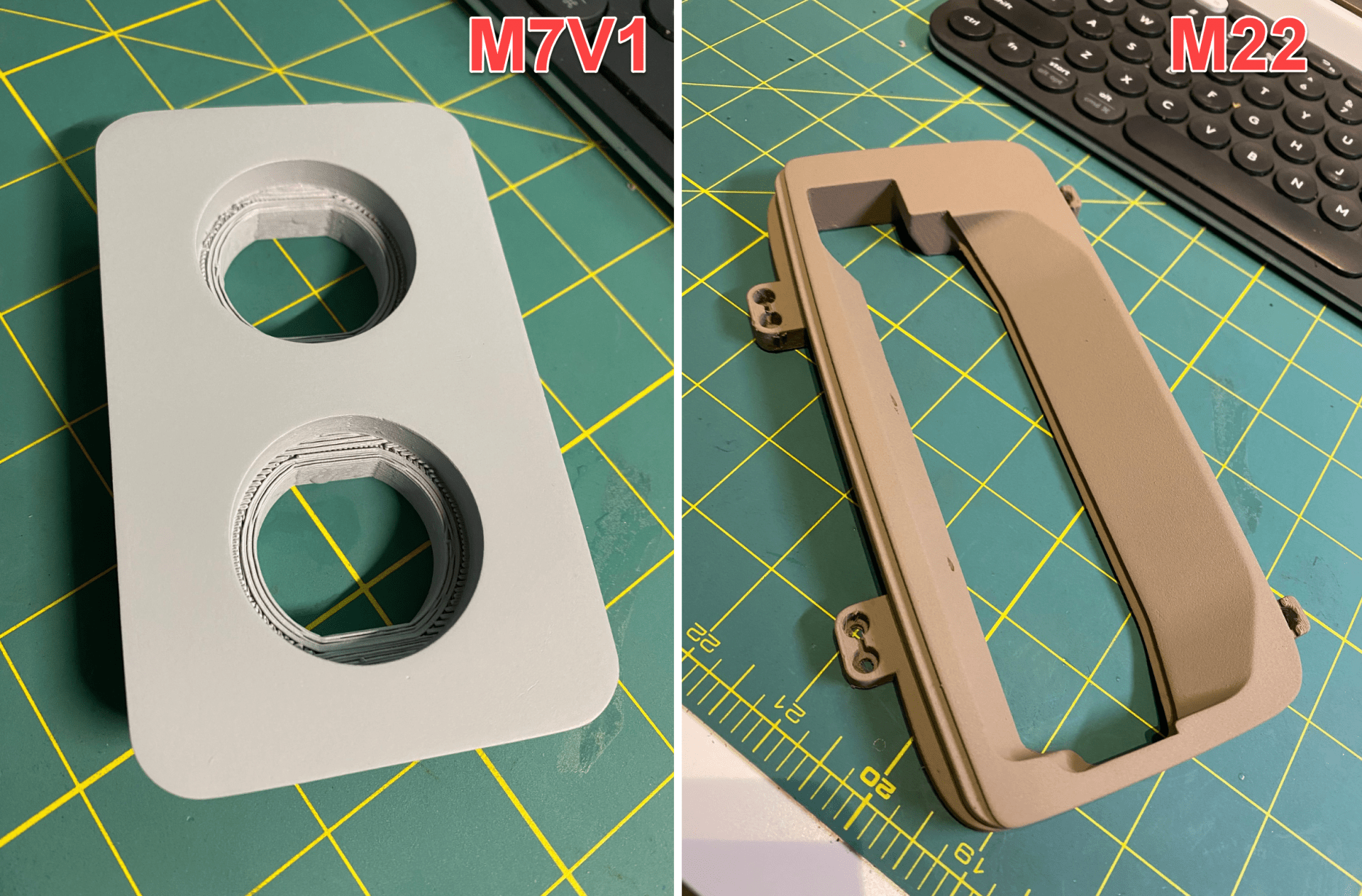

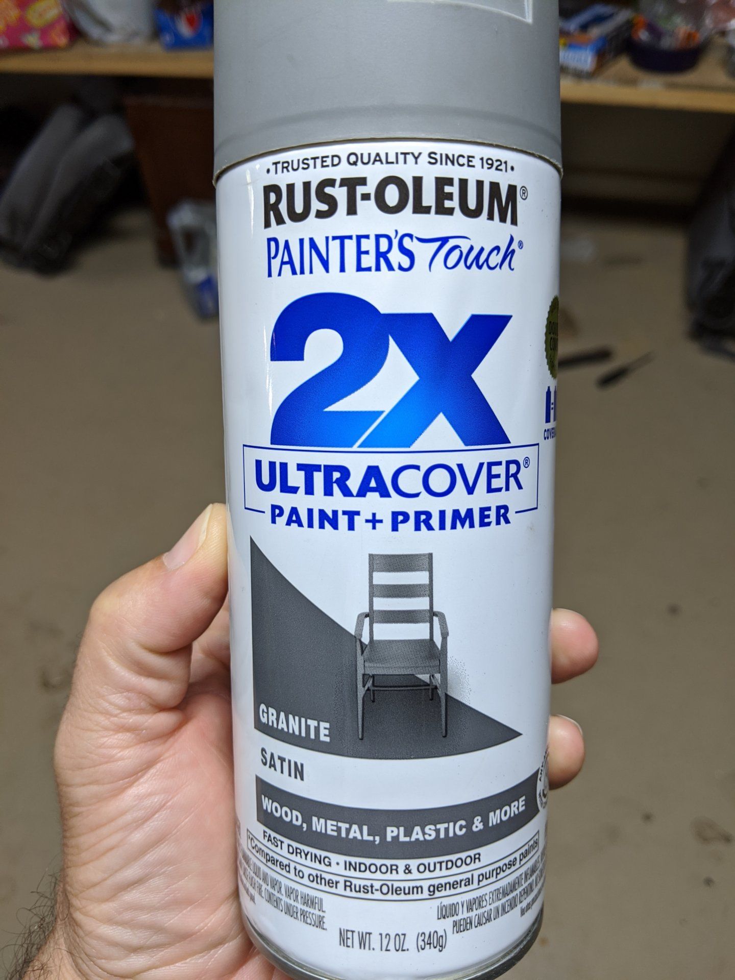

Sanded and painted parts.
Step 1: Sandpaper: #220 - #400 - #1000 (apply Glazingspot Putty on defects)
Step 2: Adhesion Promoter 3 thin coats in 9 minutes (Let it dry for 3 hours)
Step 3: After 3 hours, 3 thin coats of paint in 30 minutes
