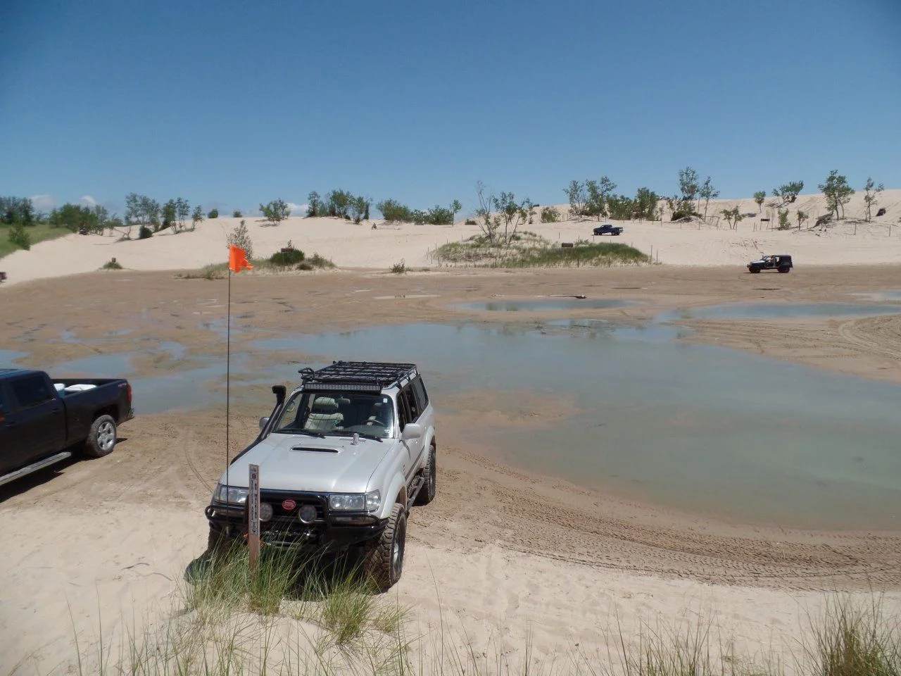

I took the 80 to Silver Lake sand dunes. It's a state park on the shore of Lake Michigan. It's nice because it is geared toward ORV's unlike the other parks here that aren't at all. The place is packed with every manner of vehicle, some are incredible and some don't make much sense! Very few Toyotas unfortunately. An 80 here is rare enough that I even got thumbs up from some of the Jeep drivers!
All in all, the truck did very well, no problem climbing when I went to 10 psi, and there are some steep suckers. Held its own drag racing on the groomed 300 ft. strip, and was awesome in the water holes.
I'm glad to have gotten to go and baseline my current shocks, OME's with a lot of miles on them. They are tired and replacements are in the works!

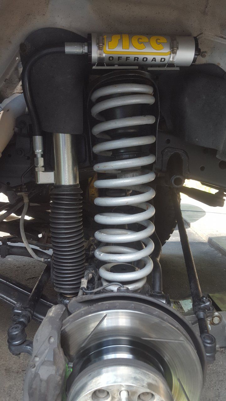

Putting my slee 2.5 shocks on today. ONE done! I know I am opening myself to be called a sticker whore but I had my buddy make me some Slee Offroad decals to bling my shocks up.

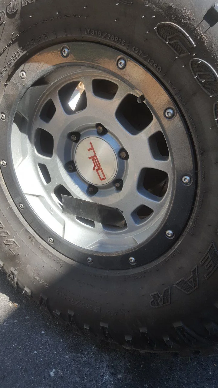

Probably silly overkill but from now on when I pull a wheel it gets a piece of tape on it till it's back on and torqued. I haven't left a wheel loose in many years (yes I've done it before) until I painted the rear end. Both rears came loose cause I only snugged them. I wasn't going to post about it cause I feel like a dumbass but oh well. Luckily it didn't hurt my wheels, but lost 3 lug nuts. My spacers look ok but I'm replacing them anyway in case I stressed the studs too much. Anyways I think the tape thing should help
Switching to brighter tape too. Idiot proof!
Front shock on!

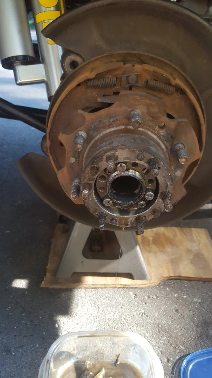

Tonight I finished up a rear axle service. It apparently has been done before because the axles had permatex instead of gaskets and the bearings were Timken insted of Koyo. There was a lot of oil from the diff in there so it was definitely time to refresh it. I put in new Toyota gaskets and seals and new Koyo bearings. I also put on a new set of Spidertrax spacers. I wish I'd have thought to get new shoes and hardware for the e brake but it didn't look too bad so it will have to be a later project

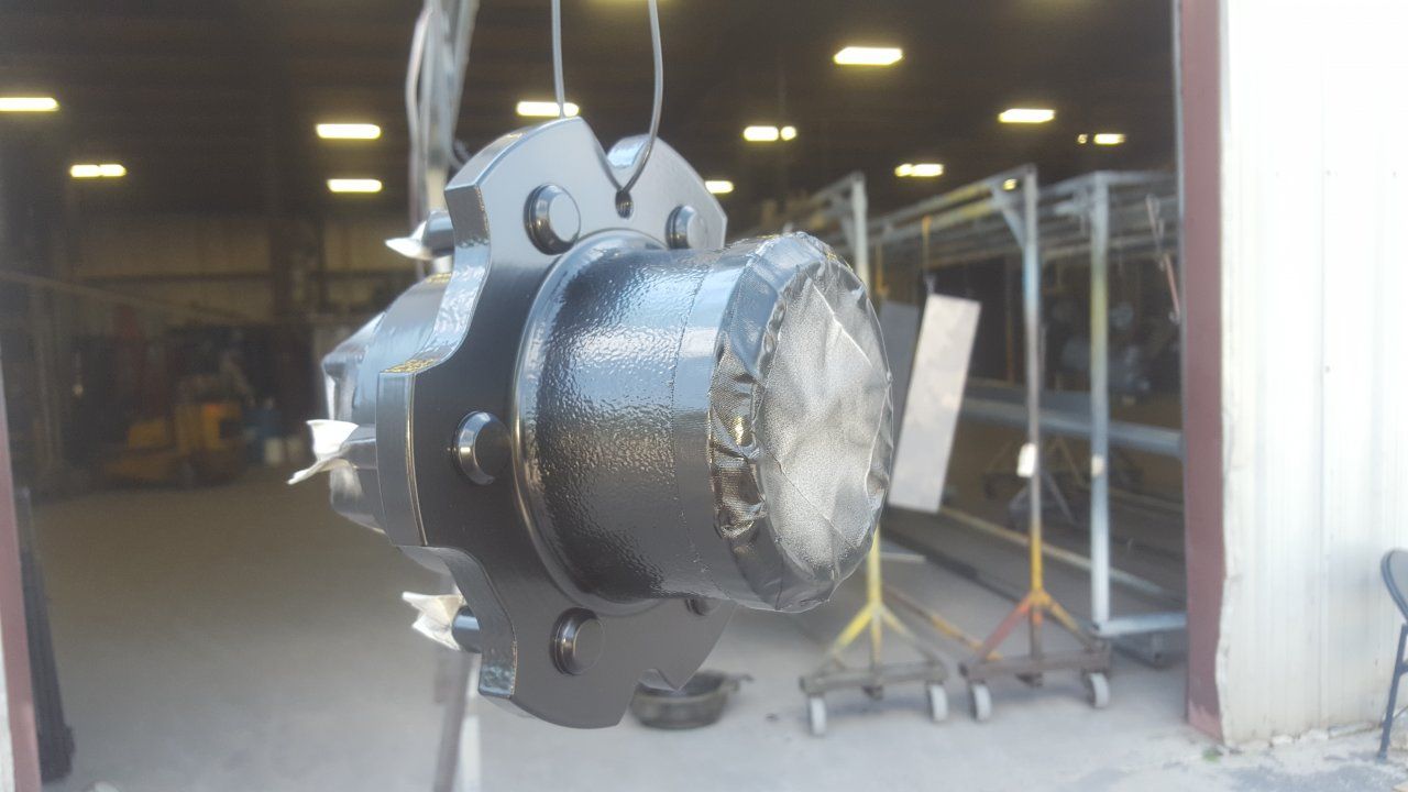

I powder coated the hubs and axle faces
Assembling the pieces
Final product
