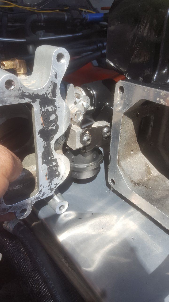

Here's the suprise I found after I got the SC off, melted bypass valve. When I first put it together with the cx racing header, I didn't have a heat shield. After a couple weeks, i sandwiched some ceramic blanket in there and it seemed to help, but I think my damage was done at the point. I really didn't notice it not functioning to make me go looking, but looking back, I recall a few things- part throttle surge, SC getting extremely warm after part throttle cruising, slighy poorer fuel mileage, weird vacuum issues especially with braking after snapping the throttle shut (no vacuum).
I just ordered one up and I am going to start on a good quality heat shield set up for it.
The hose for the bypass was in really bad shape. There was still structure all around but cracks throughout the woven part. This was giving me losses during boost, I think, as well as sucking air under vacuum (likely causing Po171)

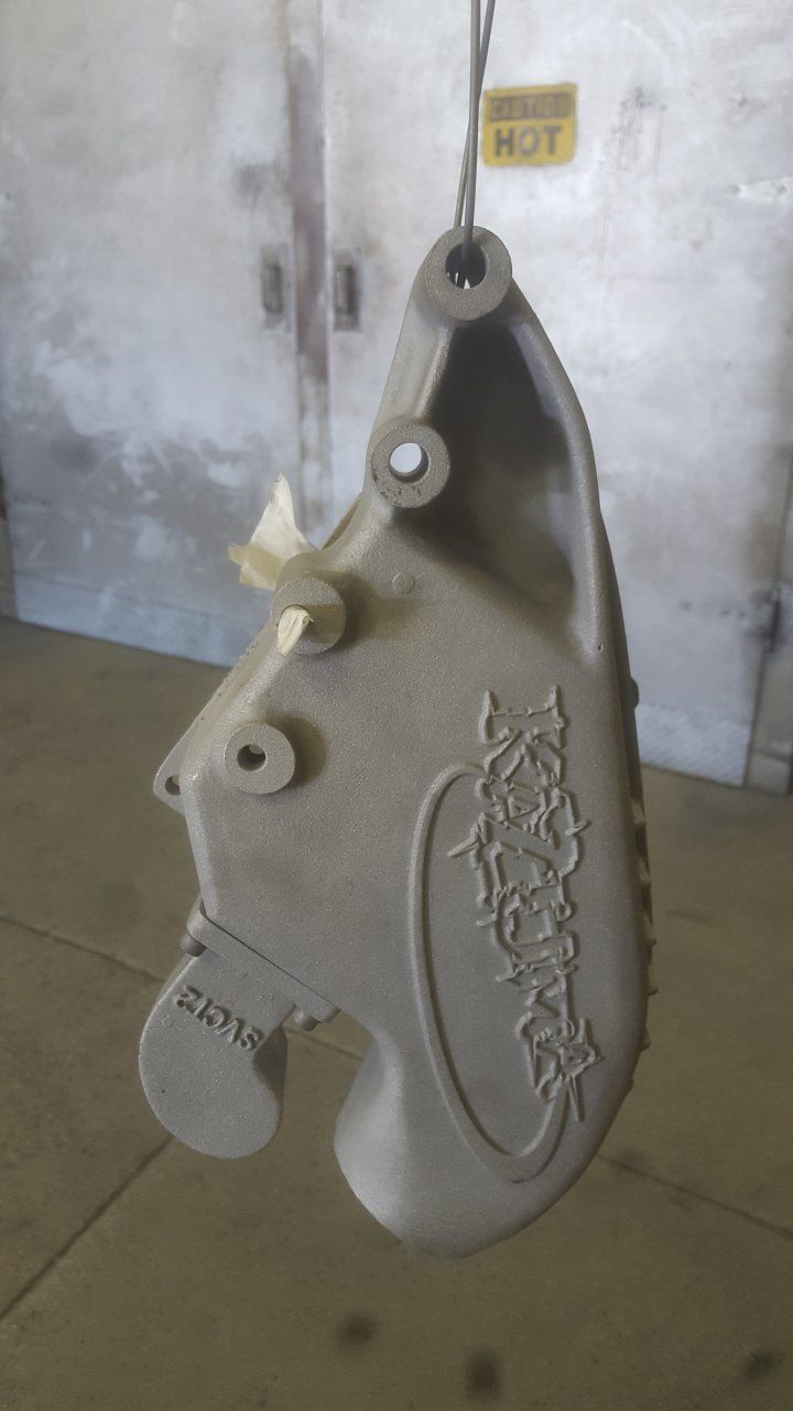

The maniflod from the supercharger was in rough shape and I couldn't find a sulver to match the other parts, so I sandblasted it and powder coated it black with clear like the supercharger body.

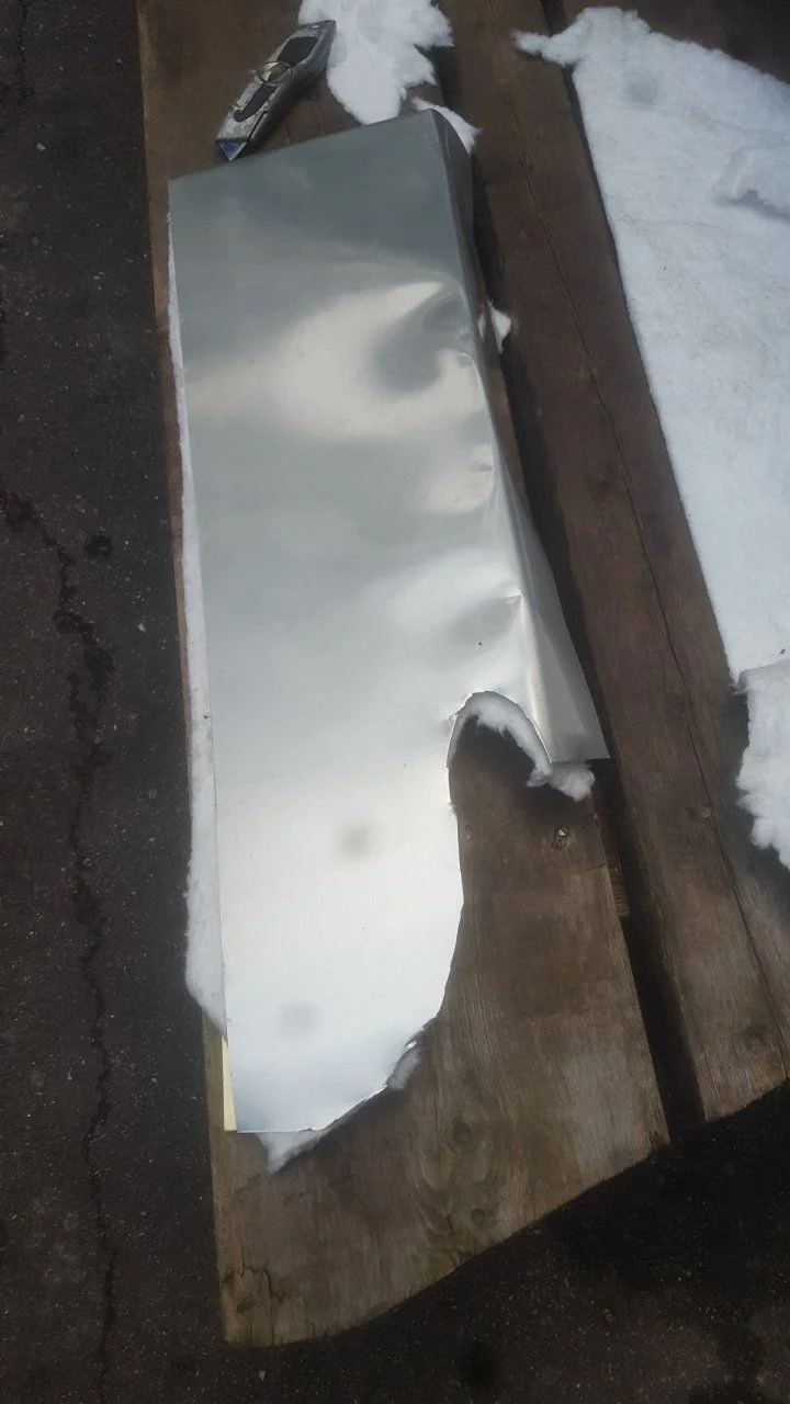

I did header wrap on my primary tubes,to try to cool the SC area down. Next I took some thin aluminum and formed a heat shield. It is double layer with ceramic insulation from McMaster Carr in the middle. The front is open so hopefully air from the fan pushes through there.
I did a quick mock up with the bypass valve and no SC and you can see how easy it was to melt it. Hopefully now it stays cool enough. One way to find out.

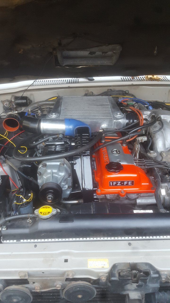

Still quite a ways to go but it is getting there. Quick intercooler mock up, and installed the smaller SC pulley (3").

I got my intercooler temp guage installed today, sort of, enough for a trial run. I did acceleration rins with the methanol injection turned on and off. Unfortunately I mistakenly erased tbe video with it off! It did make a difference but I can't remember how much, I was trying to do a lot at once. Probably 5-10 degrees. The first video I accelerated from stopped to about 70, cruised for a bit then hit it again. The intercooler knocks things down at least 10° to around 20°.
The second video is puttering up my driveway, sitting for a minute idling, then driving again. I was surprised at the lack of temp rise sitting.
I will try to get more useful data- this is just a start. Overall I think the top mount cooler is a plus.
