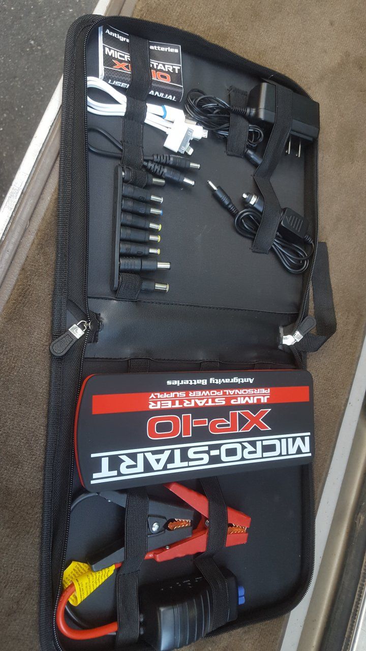

I also wanted some back up power assurance since I only have a single battery (for now). I bought an Antigravity XP 10 jump start battery. Good piece of mind and should be handy for lots of things.

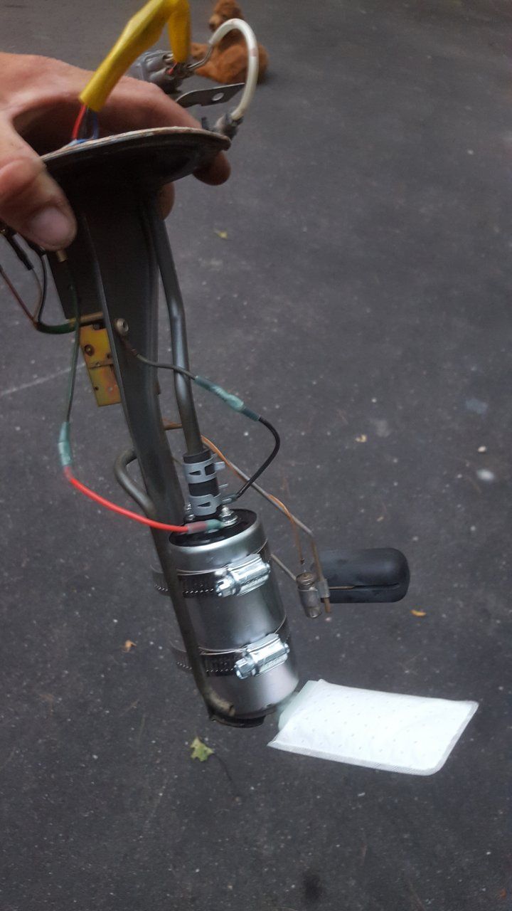

I have been dealing with an obd code PO171 which is for a lean condition but I've been unable to find it. I put in new O2 sensors, checked for intake leaks, tested the vapor canister and bought a new one but have not put it in yet, all to no avail. I started worrying that i may have a failing fuel pump, which is rare but possible. The fuel filter is newish so good there.
I decided it's best to eliminate the concern so tonight i put in a new denso supra turbo pump, which is way overkill but I hope it wont be long before a standalone ecu and more boost so I figured now's the time.
Installation went pretty smooth thanks to the write up by @NLXTACY on how to do it.
Too late for test running tonight but hopefully tomorrow the cel stays off! It only takes a short while to pop the PO171 if that's not it.
